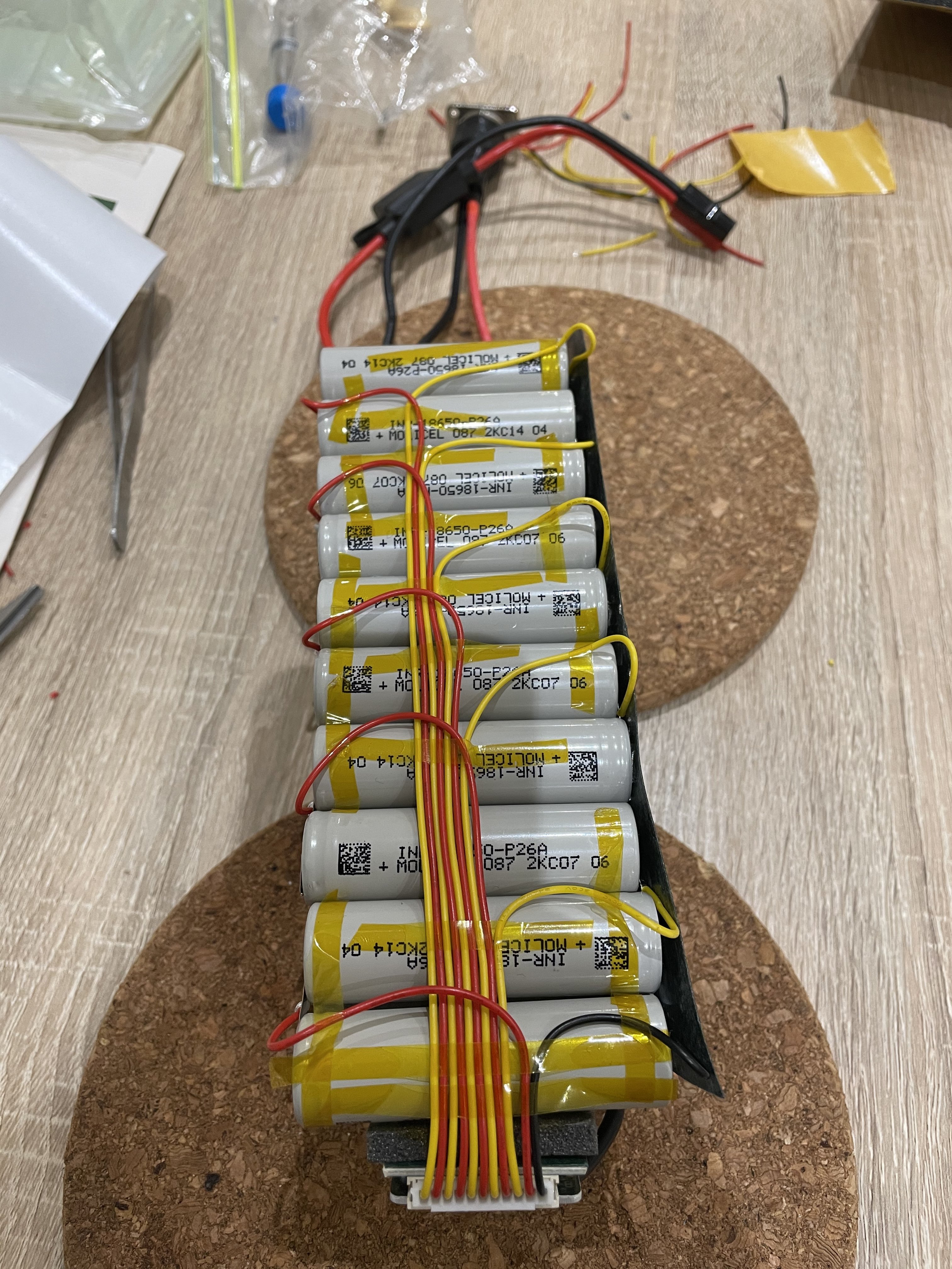

  5. Hey Folks, The first battery I build finally failed, so I got to make a new one! Decided to go with 21700 cells this time. Last time I posted my battery I got a lot of great feedback on mistakes I could improve. So if you feel like giving me some feedback on this build, would be very happy to hear it. The p42a cells are from Nkon.nl BMS is a cheap Chinese unit from ebay

  7. Bike is all built! we took it for a ride across London Yesterday and it was lovely. 30km ride and battery still had some life in it. Very happy with this kit, my partner said she felt she always had power available when she needed it. Likely too fast for her, but she can finally keep up with me and not have to put in any effort. Thanks for the wise words on my battery build. I agree I need to do better on the positive terminal insulation, and will buy those Rings you suggested for my next build [mention=4809]vfr400[/mention] For anyone wondering what you should budget for a build like this, here is the final Bill: Item Price (GBP) Donor bike (Ebay) 92 YOSE kit 239 BMS 11.69 Molicel 40x 137 Power switch 3.74 brake sensor 10.24 Nickel 8 foam 4 Anderson connectors 5 battery bag 17.49 Battery foam, heat tape, shrink wrap 5 disk brakes 14.94 cable wrap and holders 7.5 Brake cable 7 Fuse 2.5 kick stand 9 Panier rack 12 TOTAL 586.1

  9. Thanks for asking. The controller is rated at 9a cont., 18 peak. Nickel strips are 8mm x 0.15mm. I installed a 20A fuse. I had a look at this chart at by the looks of it. Even a single nickel strip would be sufficient for the continuous current, no?

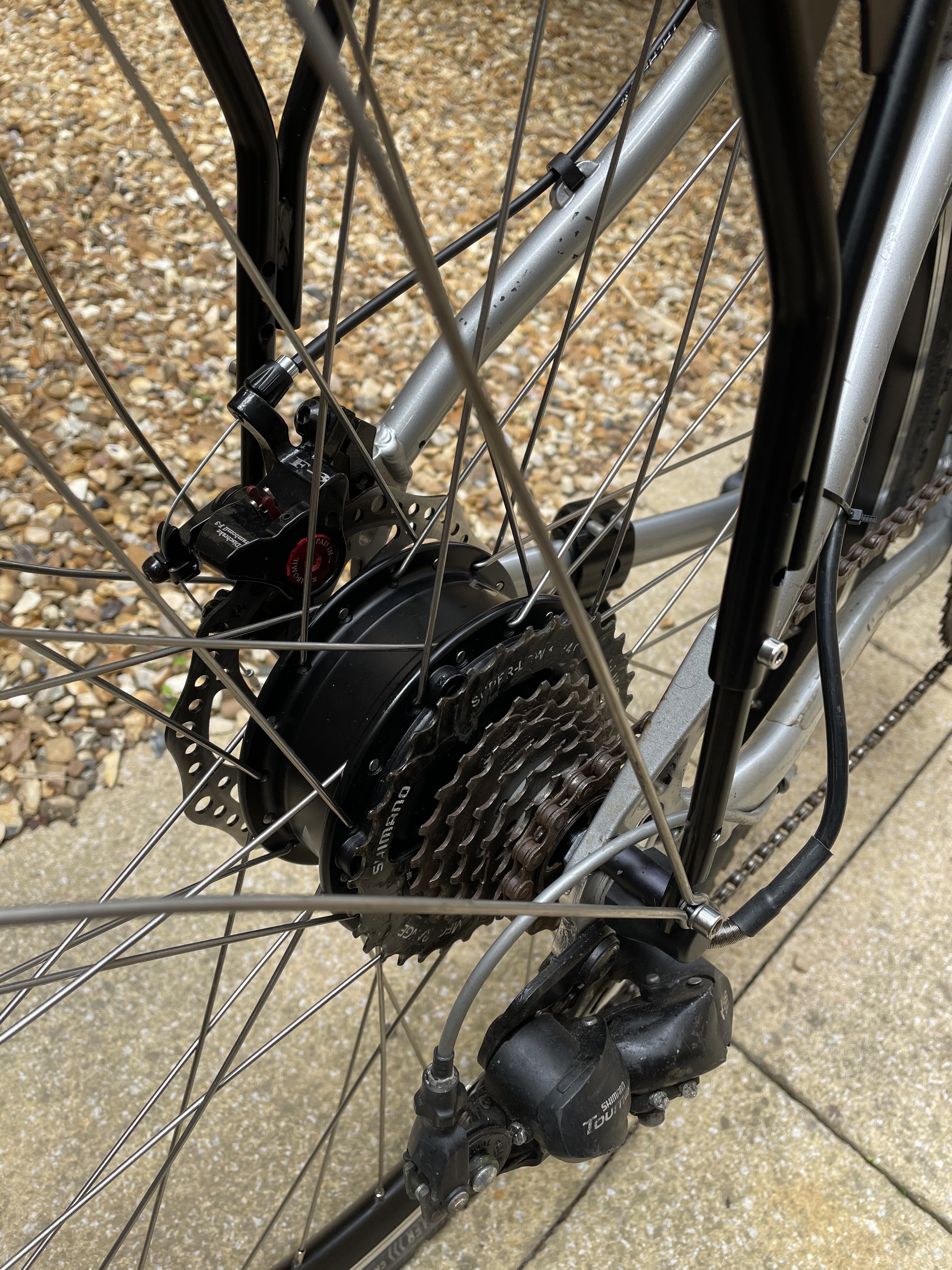

  14. Thanks! I’ve ordered the kit. I also ordered some magnetic brake sensors (seemed they will do the trick). For the disk brake, I’ll go with a mechanical disk caliper. I’m pretty sure it will fit on the frame (photo attached). I’ll sort this part out after the kit arrives.

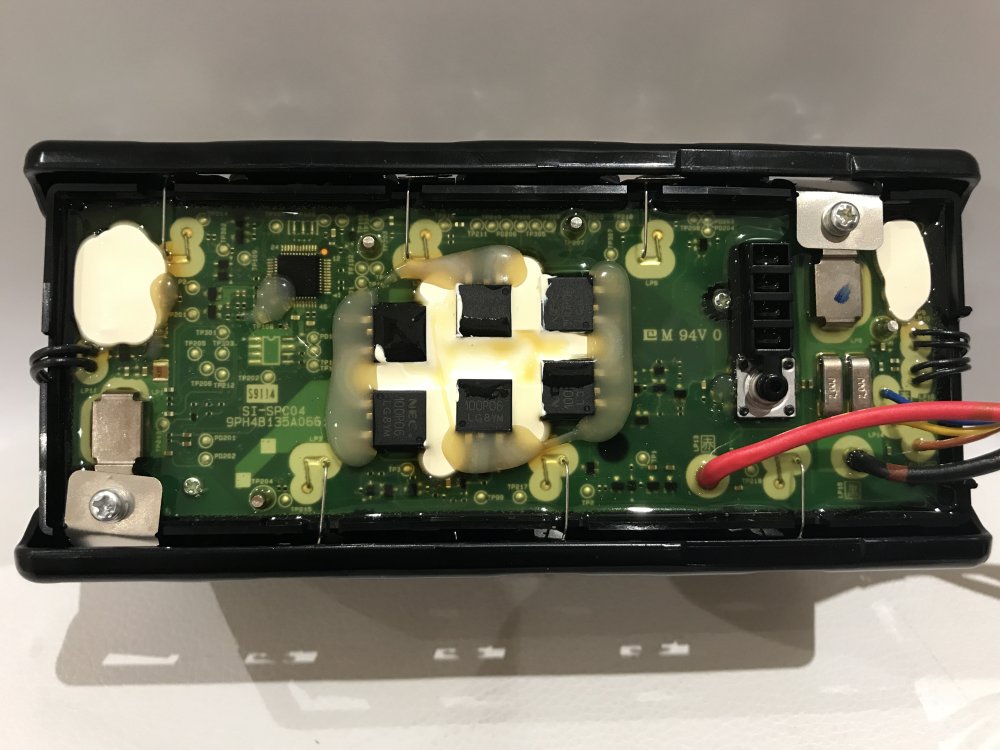

  17. Hi There, had some time to spend on this during the Christmas break. I've come to the conclusion there is something wrong with the current BMS. While the battery has ample charge (26v), the output of the +/- of the is never 26V, and the LED light indicators show no sign of life. I decided to re-wire the terminals of the battery to directly connect the anode+cathode to the outputs, and see how the bike would react. The good news is that the bike shows signs of life. Unfortunately, no power going to the motor yet. Here is a short video: https://photos.app.goo.gl/Kwfmjx1zAKDsm1wf6 The flashing indicator lights on appear to be an error code related to the "connector" according to the Sanyo Enloop Manual. This seems rather expected as I left the middle connector (Yellow, unknown BMS output) blank. At this point, I'm not really certain what to do next. I would like to debug what that yellow battery connector is for, and if I can somehow emulate/replicate it. I opened up the rest of the bike, and its unfortunately it didn't reveal many interesting info. *If anyone happens to have any idea what the non-power terminals on Sanyo/Panasonic batteries are for, would really appreciate it!* More photos for reference:

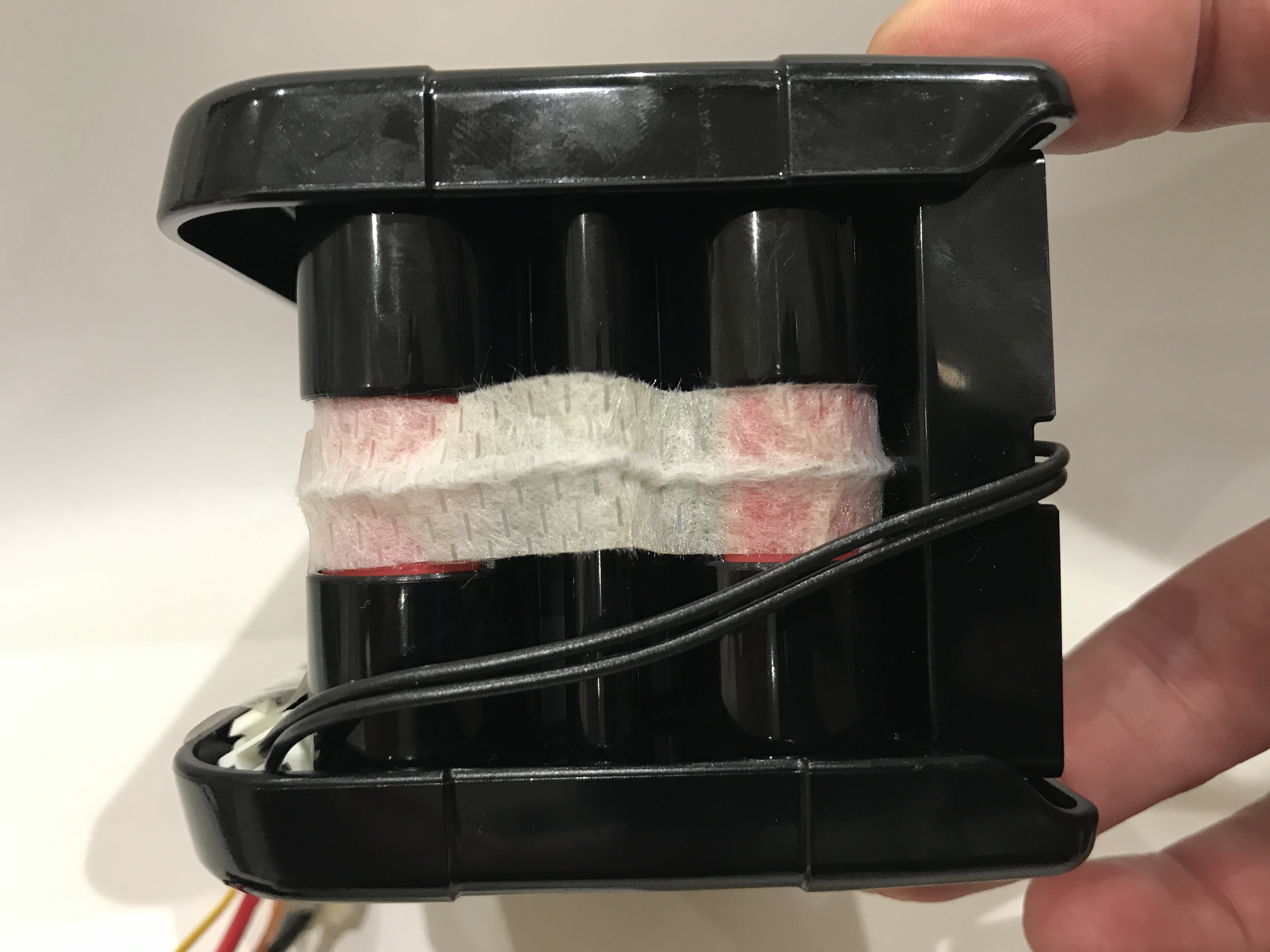

  23. Thanks vfr. Seems I'm out of luck, 11V no matter where I measure. Do you mind if I know how you calculated this? 20v @ 21 cells ~~ 1V/cell? Given this, I'm likely going to replace the cells in this pack myself. I'm having a hell of a time opening it to begin with, hopefully I manage to get it open without complete destruction. I've attached a number of more photos. If you or anyone else has any suggestions on how to: 1. dis-assemble, or, 2. how to charge when I finally get it back together, I would be infinitely grateful. HD album here: https://photos.app.goo.gl/PSdhRUNi3S3ji3xw8
