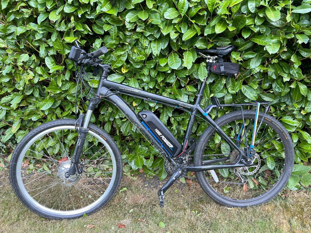

We manufacture adapters in the UK to suit Gen 2 and Gen 3 Swytch conversions, to allow for third party 36V batteries to be used. This gives the option for greater range and a degree of improvement in handling, by not having a weighty battery hanging off the handlebars. This started off as a personal project, but has proven popular with many Swytch users, whether that's from failed Gen2 batteries or those needing more range. Currently, we're working on various Brompton-specific versions. www.swap-e.co.uk The middle two pins on the clip-on device are simply a bridge, and redundant when used with an external battery. Always a good idea to check a battery is switched off during connection, to avoid possible arcing though!

Hi everyone, I’d been using my Gen 2 Swytch kit for a good few years and loved the simplicity of it, but like many others, I ran into the usual limitations: Battery getting tired Cost of Swytch replacements Limited range Awkward mounting location (handlebar) I ended up designing a small 3D-printed adapter casing that allowed me to safely use an independent 15Ah battery with the Swytch motor controller parts in the new case. It basically gave me the flexibility to upgrade to a larger and cheaper battery, and mount it on the frame down tube for better weight distribution. I subsequently developed Gen3 and Brompton versions too. Having originally made it for myself, I started selling the adapters on eBay (until they banned ebike accessories ), though I got really good feedback. I subsequently developed Gen3 and Brompton versions too. I have asked Pedelec admin if I can provide links (as advertising isn't allowed), but in the meantime, if anyone’s interested or has questions, I’m happy to share more or just chat about what other DIY Swytch mods people are doing. Cheers, Dave
