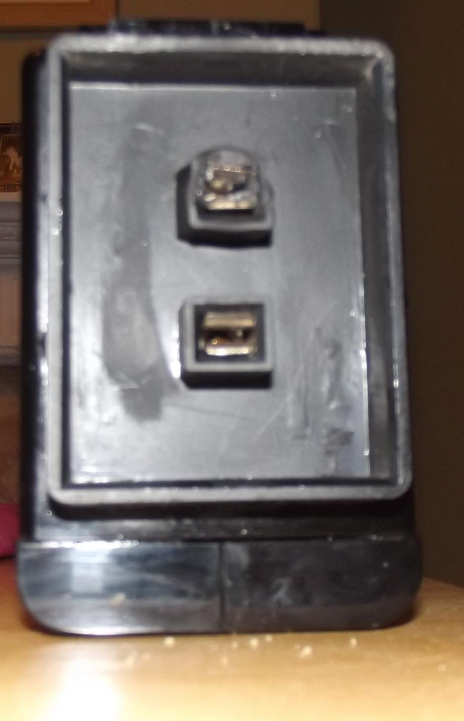

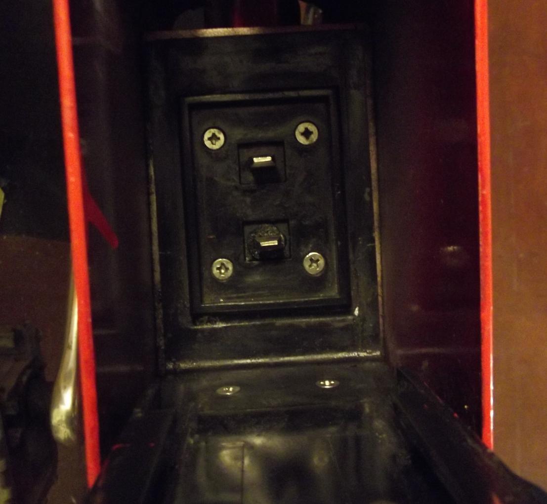

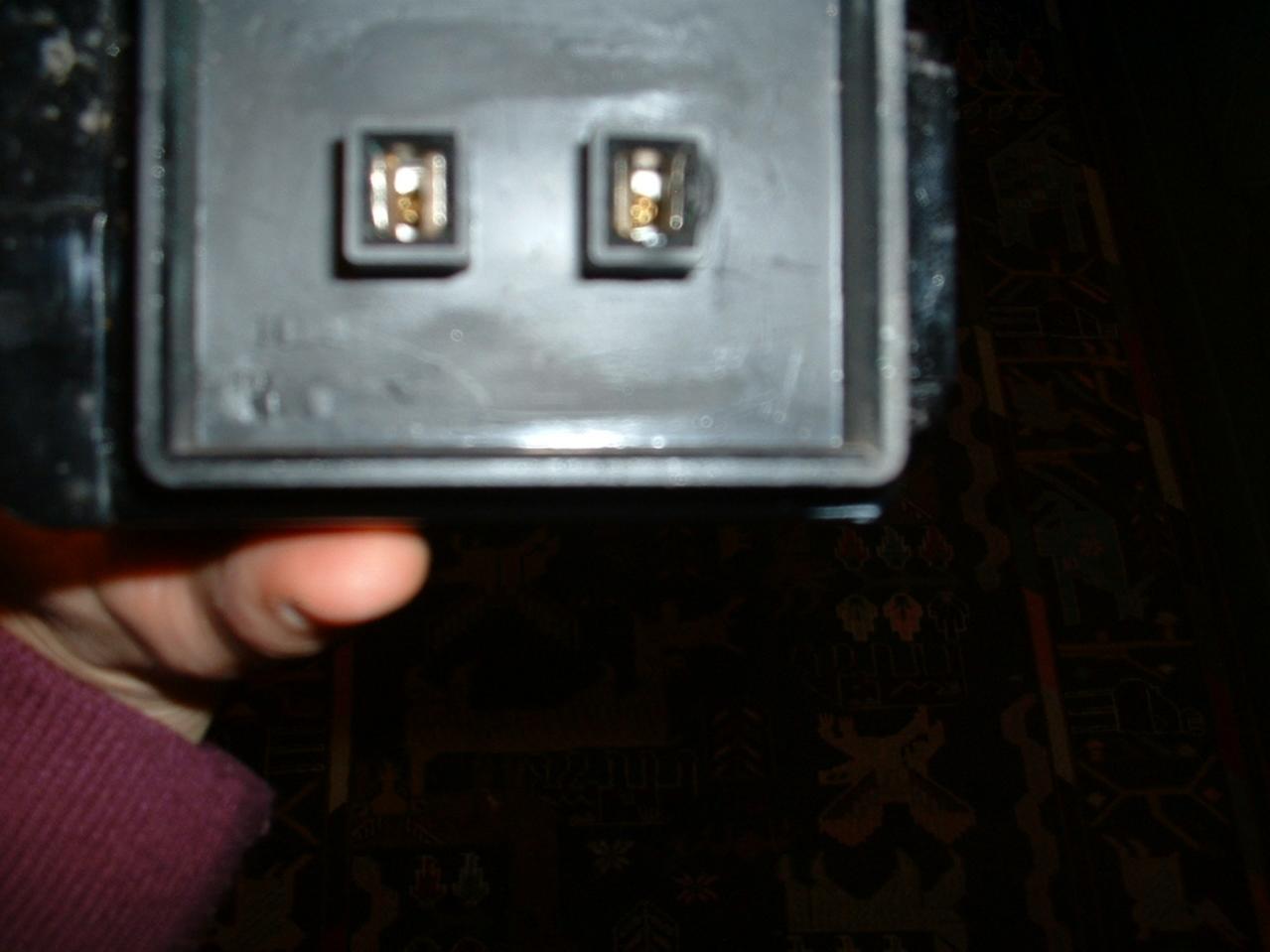

  2. [ATTACH]5035.vB[/ATTACH][ATTACH]5036.vB[/ATTACH][ATTACH]5037.vB[/ATTACH] Hi, Here are the images. Yes John, I did buy it from you, I'll give you a call tomorrow. I don't think there is anything wrong with the battery as such. Maybe it doesn't fit as well in the older frame? The plastic underneath the connectors on the bike seems damaged, and the meeting parts on the battery, Thanks
  3. Hello again, I have been persevering with aluminium foil, but this problem is getting worse. It is now obvious that overheating of one contact is deforming the plastic surround on the battery, and damage now extends to the the area around the battery socket on the bike. Sorry, I have pictures, but I have failed to upload them today. Also I took the battery off yesterday and again it was stuck, on removal it was apparent that the aluminium foil had melted. I did try to lever in the contacts as flecc suggested by putting something behind the metal contacts on the battery, but this failed to make a good contact - hence the Al foil. I am reluctant to use the bike in this state, but don't see how this can be easily resolved, any further thoughts??

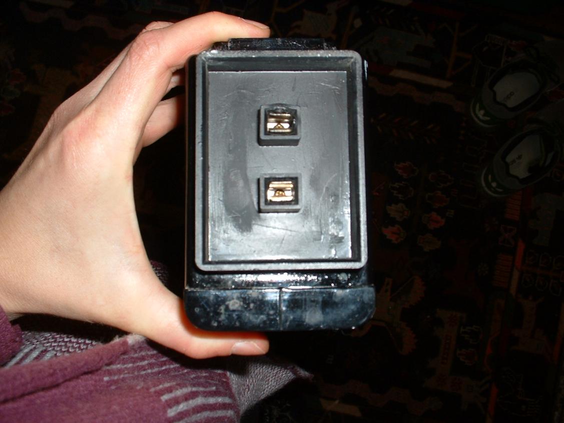

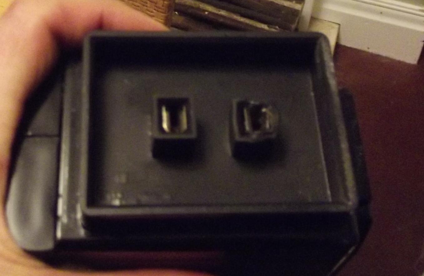

  5. [ATTACH]4627.vB[/ATTACH][ATTACH]4628.vB[/ATTACH] Thanks for the suggestions. I followed flecc's advice and had another go cleaning and prising the contacts out a bit. I noticed one was harder than the other to move. Anyway this didn't work, the light came on for a fraction of a second and that was it. I was preparing to try the vaseline thing, but then decided to put a bit of aluminium foil into the contacts on the battery and this worked. I then figured out that it was only the rear connector causing a problem - i.e. it will work with no foil in the front connector. Note I said the rear connector looks a bit out of shape. On closer inspection I can see some of the surrounding plastic has actually melted a bit - I attach 2 photos. The metal contact was actually stuck to the plastic on one side. I am concerned to know how this has happened, the battery was bought in April. So, I guess I can use the bike with a scrap of aluminium foil, but how reliable would that be and might this happen again? Also the battery is under warranty, could this have been caused by water, should I send it back? Thanks in advance.
