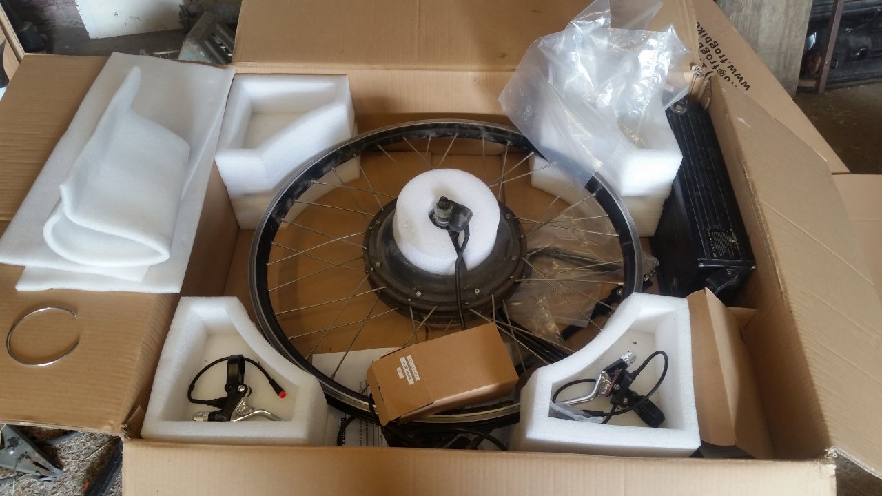

Complete kit including 26 inch rear wheel, controller, 48V lithium battery pack, rack, throttle speedometer/odo/charge indicator (with night illumination) plus pedal sensor, and a few other bits and bobs. I had it installed in a mountain bike for a bit, did less than 200 miles on it because I bought an electric car. I have taken the bits back off the bike and put them back in the original box they came in. I paid about 700 for this kit, selling for £425 Being 1000W this is not legal for road use, I was able to do 23mph without pedalling, so bit of a giveaway. Good fun on private land of course. I had the battery mounted on the back of the bike which made it very unbalanced, I would highly recommend putting the battery in the frame or at the front somewhere for better handling. Collection from Sussex/Surrey RH19 . Could investigate courier options. I will try to get a pic of the stuff tomorrow.

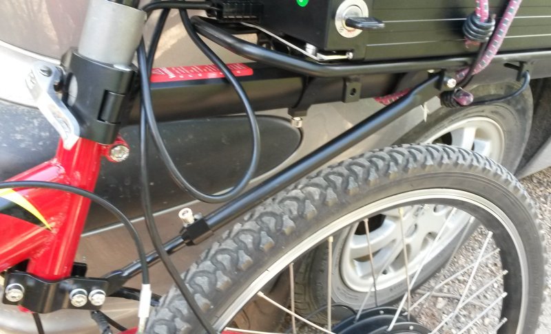

Well a little update, I was actually able to use one of the stays to beef up the rear rack. it JUST fitted round the seat tube and it has made the rack much firmer. Bike still a handful when getting on and off, IE when you lie it over to get on, the front wheel leaps up in the air due to the heavy high battery. Tightened spokes . Took for nice ride including a long hill. Quite pleased with the performance. Been using mostly electric not much pedalling to give me a 'worst case scenario' on the range. Started to cut out under load at about 13 miles . Lasts a couple more miles if gentle on the power and pedal a bit. Total time 66 minutes. I'm glad it doesn't just shut off and stay off like my cordless drill does! I still don't have the pedal sensor installed because the gap between my frame and the crank isn't quite wide enough for the magnet wheel to fit. Removing the crank and grinding the back of it down might help. So on throttle only, it is a little strange because it seems to regulate the bike according to speed, rather than power. What I mean is, if you hold the throttle at a point that gives you 10mph, if you start pedalling, rather than it making the bike speed up, it reduces the motor assistance. So you end up having to synchronise the throttle movement precisely with your pedal effort. Too much throttle, it goes faster than you want and your pedalling does nothing, too little throttle and your pedalling does most of the work and the motor is doing almost nothing as it is waiting for the speed to fall down to the prescribed figure set by your throttle. The assistance setting on the LCD seems to do nothing so that must only be for the pedal movement sensor. Overall fairly pleased at choosing this kit, glad I didn't go for anything lower powered or smaller battery as I wouldn't want anything less. This setup will get me around locally with ease. In other news, I picked up a better bike at my local bike shop that a customer had traded in as it needed a lot of work to the rear end, IE axle etc , its a hard tail ali frame bike. Some say not ideal for Ewheel but I might try it. It has cable disc brakes and as a massive bonus, some Schwalbe road pattern puncture resistant tyres with plenty of life left. Couldn't really say no for ten pounds! I think I have the electric biking bug!

Yes that post rack came in the kit. There were some braces suppled but they would only work on a fixed rear end bike.
