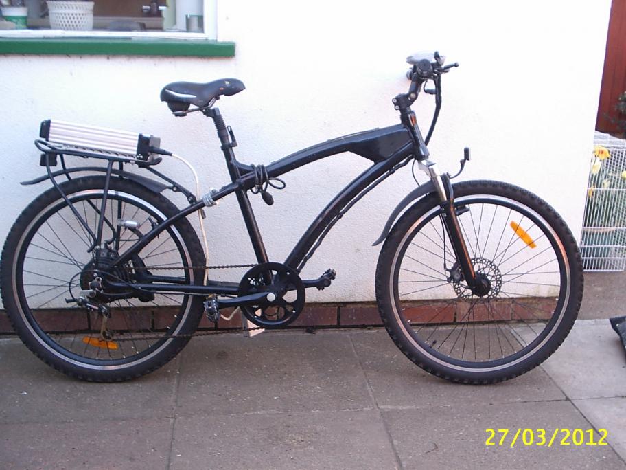

March 26, 201214 yr Can you post a photo of your bike and the controller? It may help if we can identify what model it is. Steve

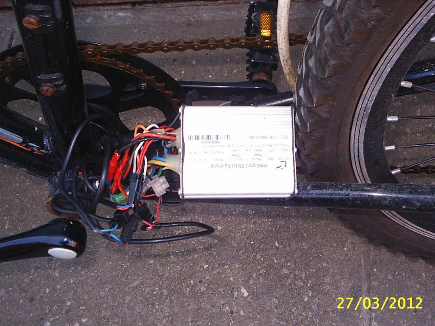

March 27, 201214 yr Author Hi. Here is a couple of photo's that may help? [ATTACH]3346.vB[/ATTACH] [ATTACH]3347.vB[/ATTACH] [ATTACH]3348.vB[/ATTACH] [ATTACH]3349.vB[/ATTACH] Edited March 27, 201214 yr by chris301up

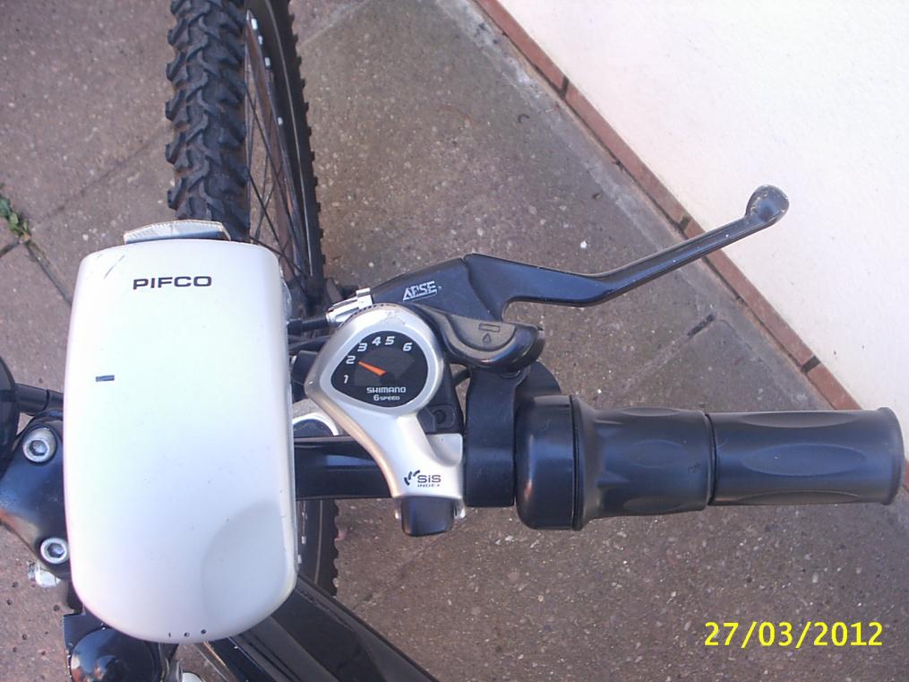

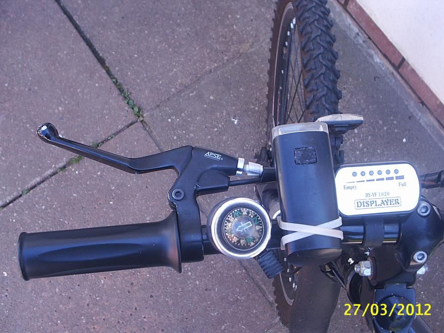

March 27, 201214 yr A picture of the handlebar controls would give a complete idea of your bikes setup.

March 27, 201214 yr Thanks for the handlebar pics. While you are waiting for the multimeter, could you trace are the cables going back to the controller from the throttle, display, brake lever switches and pedelec sensor and post a list of the number of wires, wire colours and a description of the connector they are terminated into.

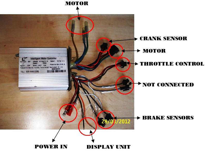

March 27, 201214 yr Author Right. We have checked out the controller with a multimeter and there is 40/42 volts at the battery output and at the controller. There is no power whatsoever from any of the other outputs from the controller. I have now removed the controller unit which smells very slightly of burning, but that could just be the natural smell from usage? The wires (as far as I can determine) are as follows: 1 x Orange (Positive from battery) 1 x Black (Negative in from battery) 2 x Grey (Not connected to anything) 1 x Thick Green (To motor) 1 x Thick Blue (To motor) 1 x Thick Yellow (To motor) The following I am not sure where they go as I cannot trace them: 5 pin connector with Red-Black-Yellow-Blue-Green 3 pin connector with Red-Black-Red & Green 3 pin connector with Red-Black-Red & Blue 1 x Orange wire 1 x Black wire I am reasonably sure this is where the fault may lie so does anyone know where I can obtain a replacement?

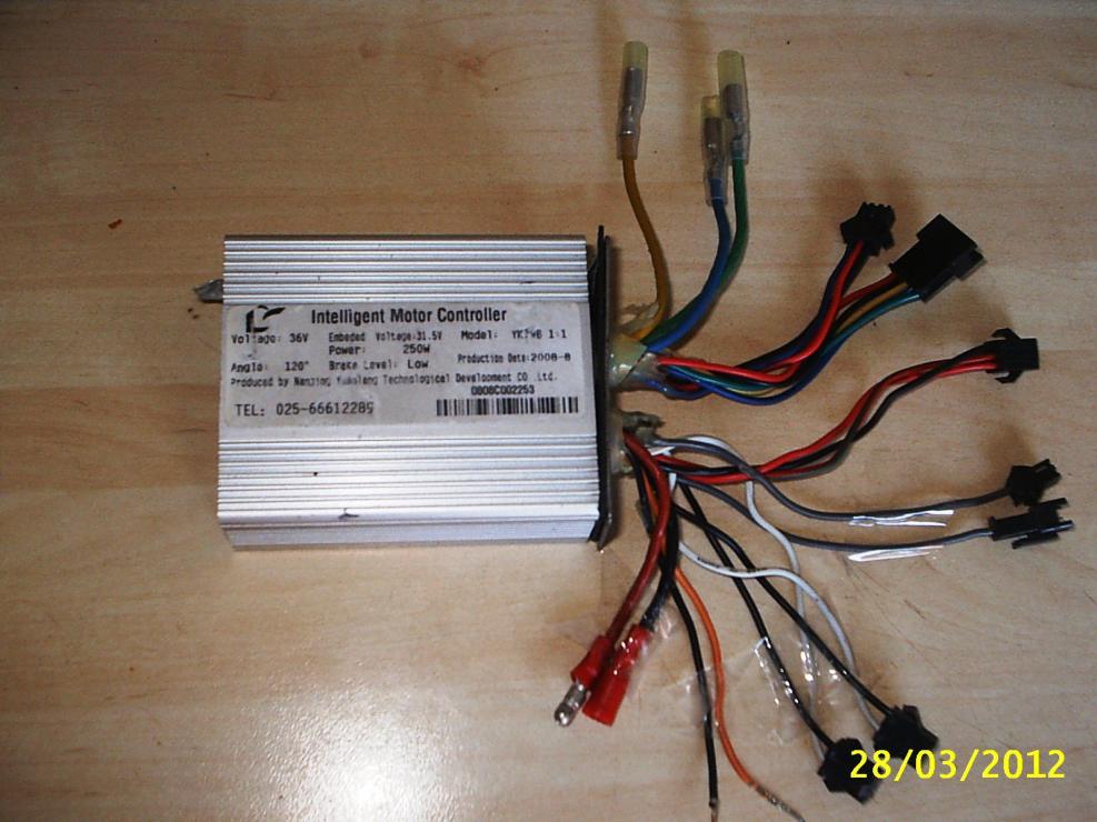

March 28, 201214 yr Author Have removed my controller and here is a photo for reference: [ATTACH]3358.vB[/ATTACH] This should help!!
March 28, 201214 yr Personally I would take a punt at it. The similarities, same case extrusion, end plates held on by 6 screws, same typeface used for "Intelligent Motor Controller", 2 bundles of wires sealed with hot glue and I can make out "YK" on the Golden Motor photo if you enlarge it and push the browser resolution up to 300%. Their controller model range is CY-01, CY-02 ..... I think yours is YK1 which would correspond to CY-01. I would ask them if they could provide a datasheet and 1 off sample unit 36v,250w and give you a price delivered to the UK and whether they would accept payment by Paypal.
