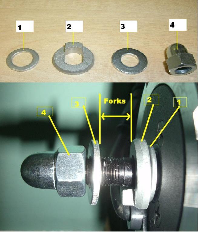

[ATTACH]3363.vB[/ATTACH] never add more washers between the motor and number 2 (tab washer)

[ATTACH=CONFIG]3363[/ATTACH] never add more washers between the motor and number 2 (tab washer)
I am curious, why not ?
Does the motor shaft only have flats on the non threaded part ?
Regards
Jerry
On my 8Fun kit the flats are on the non threaded portion only. Putting extra washers will move the locking washer off the flats. You will then have no anti-rotation protection on that side.
