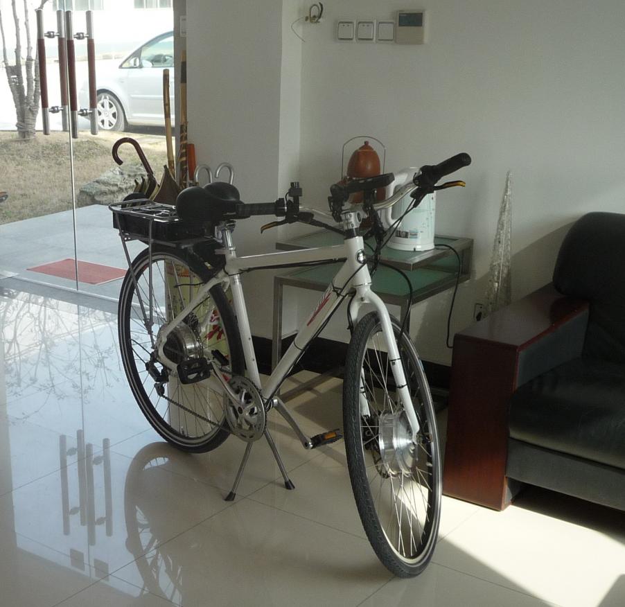

The image below shows a bike with front and rear motors used by eZee for testing.
It is not for sale, but would not be too difficult to reproduce;)

Do you know any more about it. Does it have a dual-channel controller or too separate ones? Does the throttle drive both motors at the same time?
Hi d8veh,
The bike in the photo was being used by Justin of ebikes.ca whilst I was at the factory for testing various eZee motors, setups and components.
The motors are not run in tandem, so it is really a bit of a hoax as far as dual drive is concerned, but quite feasible to create.

Hi d8veh,
How fast does that bike go John and how much power does it need?
I'm sorry, but I can't answer those specific questions Morphix, it is not a production model and the setup was constantly changing.
