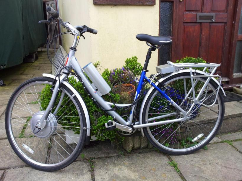

While out for a ride today, I started thinking about this problem of falling off when the bike leans over, and I tried it out - riding a bike is so instinctive that I really had to try hard to put myself in the position where I would fall off.
I came to two conclusions, firstly, I would fall off if I had no real concept of balancing a bike and secondly, I would fall off if I couldn't turn the handlebars quickly enough to regain the balance.
I really can't see any other reason if the bike is adequately designed.
So favourite reason would seems to be stiff steering.

Many thanks for all the interesting answers.
My wife fell off whilst almost stationary.
She let go of the handlebars which swung round, as they do, tipping her sideways.
I think stabilizers are not such a bad idea, but worry that on cornering they might tip you over.
We did have a smaller folder she rode. As in the comments above, the low position meant pedaling for any distance was inefficient, and ruts and pebbles tended to push her off track.
I have just repaired the battery on her Windsor (blown fuse) and been out riding it. We live in Torquay, which has very steep hills and a sea-front one can not cycle along as the Council say they could lose their Blue Flag status.
It seems a cycle track would be deemed a hazard to pedestrians. ( Insane rules ! ).
The Windsor felt perfectly stable, but not very powerful.
I did let the handle bars swing round to feel the effect and it does encourage a tumble if there is a steep camber.
I weighed the bike and it is around twenty kilos without the battery, hence pretty light as the average bike goes.
Hardly seems worth changing to gain just one or two K.
I do keep telling my better half it was her own fault she fell over, but she is hard to convince.
Errrr ... they do ?
Anyway.. fudge number 1, damp the steering possibly

Like I said before, it's nothing to do with weight. It's the steering geometry, which is different on different bikes. Read about it here:
Bicycle and motorcycle geometry - Wikipedia, the free encyclopedia
Unfortunately no ebike salesman will be able to tell you what's the bike's trail, castor or head angle. If he does, it'll have a totally different meaning. On a normal bike for leisure, you don't want any steering flop. Old bikes never had it. It seems to have come iin with fast-steering MTBs. We all used to ride no hands when I was a kid, but try doing that on a modern bike.
Back to the point. You have to try different bikes to feel the difference in the stability and amount of flop. I was hoping that someone would say, "I've got a stepthrough and it doesn't flop", but I guess we don't have so many forum members with step-thoughs. If you can find a bike with the forks that curve forward at the bottom rather than straight like yours, it'll probably be a lot better.

Another option might be to change just the forks. The ones from the Milan might fit straight on your bike.

Not riding between 19 and 70, I suppose it should have been obvious that riding dynamics may have altered, but I honestly never gave the balance of the bike a thought, blaming myself for the inability to sit up and let go, as in days of old.
Seems I want to find a good bike tinkerer down here in Devon. Fork-changing sounds daunting.
Only the first time....
If you get the correct replacment forks and maybe a magnet (if the bearings are loose instead of being an all in one caged type) then its not a technically difficult job
D8veh's mention of curved forks made me check the missus' Powabyke X6 - As I thought, curved forks.
[ATTACH]4767.vB[/ATTACH]
It's a nice ride - very Mary Poppins and doesn't feel at all heavy. If you could find a 2nd hand one it'd be worth a try. Main disadvantage is the small battery, but plenty of room to put one on the rack.
