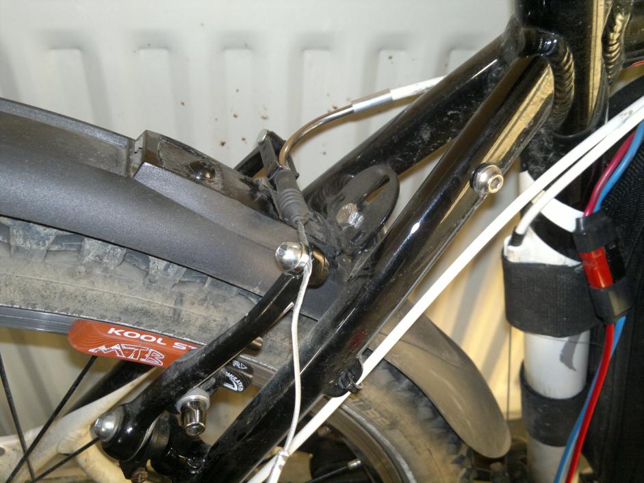

Tried to adjust my rear V-brakes today, I just couldn't seem to get it right.
The trouble is the wheel is slightly out of true, moving approximately 1-2mm side to side.
I can adjust the pads so that they clear the rim and don't rub as the wheel rotates, but then I can't get enough braking force to stop safely.
[ATTACH]6155.vB[/ATTACH]
Without resorting to a rear disc brake setup, can I upgrade or replace the V-brake with something that will in effect amplify the brake lever input, thus allowing me to set the pads further away from the rim?
You could buy a spoke key and true the wheel up, is not a difficult job if its only out by 1-2mm.
Are both halves of the v brake moving equally? sometimes the tension of the springs is uneven and needs adjusted so both pads pull away from the rim properly when you release the brake.
One other thing to check is that you have a proper v brake lever on your handlebars some levers do not give the large cable travel necessary for a v brake
Alternatively you could change to a cantilever brake but you would need to fit a rear cable hanger to support the outer cable

When I read your reply, I realised the probable cause of the problem, the brake levers of course.
I changed both over from the Specialized originals to e-brake levers.
Mmmmm, might just have a bash at trying to dial out that wobble with a spoke key ;)
