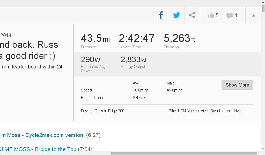

May 12, 201411 yr I use mine a lot in tour at around 23 mph. I can also do 2 miles in 3.50 mins in turbo if the mood takes me. It just gives so many variables, I love it.
June 4, 201411 yr @[mention=2339]Artstu[/mention] 23 mph on tour is a really nice speed I'd like to be able to achieve too...I presume u have slick tires on that KTM of yours...say, what's your estimate in increase on your average speed comparing to restricted engine? Commuting being my main deal, now I average 13-14 mph according to HMI. The bike is Cube SUV Hybrid (Active engine). @[mention=6825]RobF[/mention] Thnx, your real time infos are invaluable to me. As of now I think I decided to go for a dongle and if battery performance starts to drop rapidly on my commute I could always remove the dongle (or go sub 25 km/h).
June 4, 201411 yr @[mention=2339]Artstu[/mention] 23 mph on tour is a really nice speed I'd like to be able to achieve too...I presume u have slick tires on that KTM of yours...say, what's your estimate in increase on your average speed comparing to restricted engine? Commuting being my main deal, now I average 13-14 mph according to HMI. The bike is Cube SUV Hybrid (Active engine). 23mph on tour is only on the flat with no headwind. The tyres are currently the standard schwalbe mondial tyres, they're not a very good roller IMO but they suit the mixture of riding I currently do. Hard to say how much faster I am, 2 to 8 mph. I can average 23 mph on some of my rides, that includes 800 feet of climbing too. I did a ride the other week, one way with a drop of elevation of around 500 feet and averaged just shy of 25 mph over the 14 mile journey, and about 23 mph on the return journey. Yesterday I did 43.5 miles with 5,300 ft of climbing and averaged 16 mph, most of the ride was done on tour too. Edited June 4, 201411 yr by Artstu

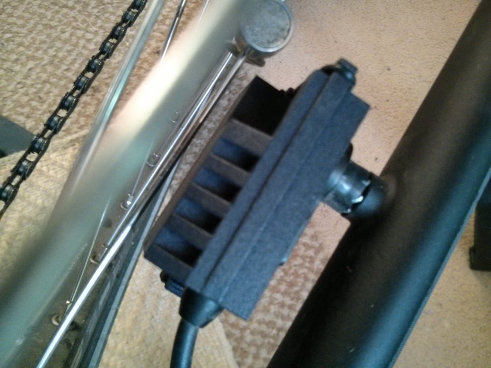

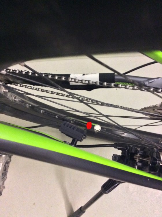

August 8, 201411 yr Thanks again for the speedy reply. So the dongle arrived yesterday! Fitting was not as straightforward as I thought as the dongle kept hitting the spokes on my rear wheel. In the end I had to unbolt the Bosch sensor, remove a plastic grommit / spacer behind it and re-attach. This finally provided enough space to fit the dongle. It has made a huge difference to my journey time. What was a 55 min journey I can now do in 45 mins. Yes I did order a wired bike computer (I read your previous posts). Works fine. Slightly dissapointed that I have this huge shiny Bosch HMI Display which is a bit useless now. Even the range is not accurate. It is telling me I have 12 miles range left on a full battery? Also once this morning it came up with the "Remove foot from pedal" message and I had to turn the whole thing on / off again. Anyone had any similar experiences?
