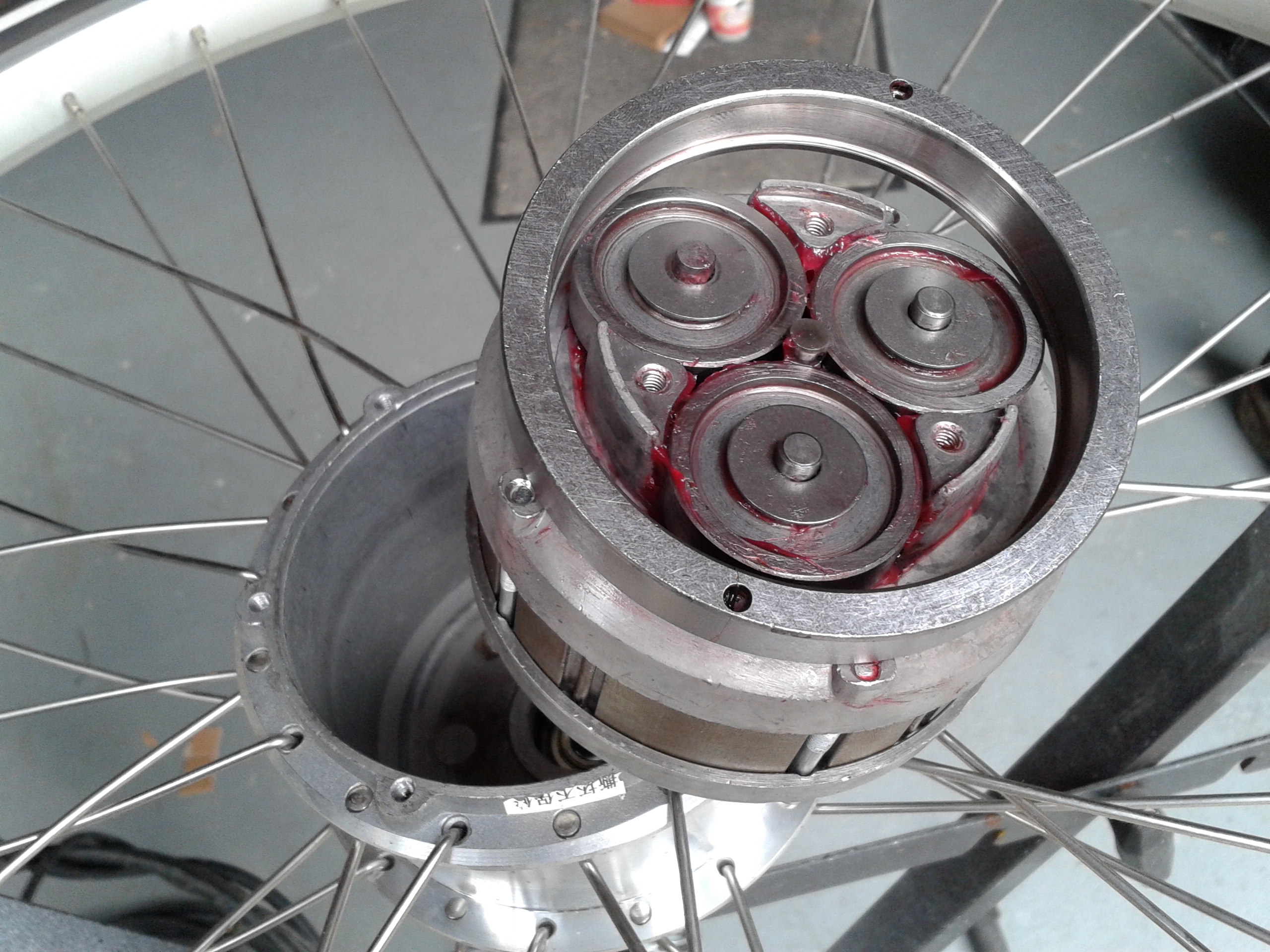

August 19, 201411 yr Hi folks, I am trying to help an old lady with her made-in-china eBike. The bike has a TongXin motor and the outer ring is brooken. It is clear to me this is a weak point on this motor. Question: - anyone has / or know, an outer ring for this motor - if I can't get the ring, what is closest fitting exchange motor as far as specs, dimensions and control signal Hope someone can give some helping advice here. Kind regards, Ed

August 22, 201411 yr Author Glad you have managed to source one. I hope you will let us know how you get on with fitting it and if possible a link to the source. Sure, got it from ebike-kit.nl Fitting, so far, is a disaster if you don't have the special tool. They told me it works on a Bench Vise. I tried that but wasn't succesfull. The trick here is that you need to push on 3 point all over the ring. With the Vise you push on 2 points from whih one is always close to the bearing wheel. Will make a tool during the weekend.

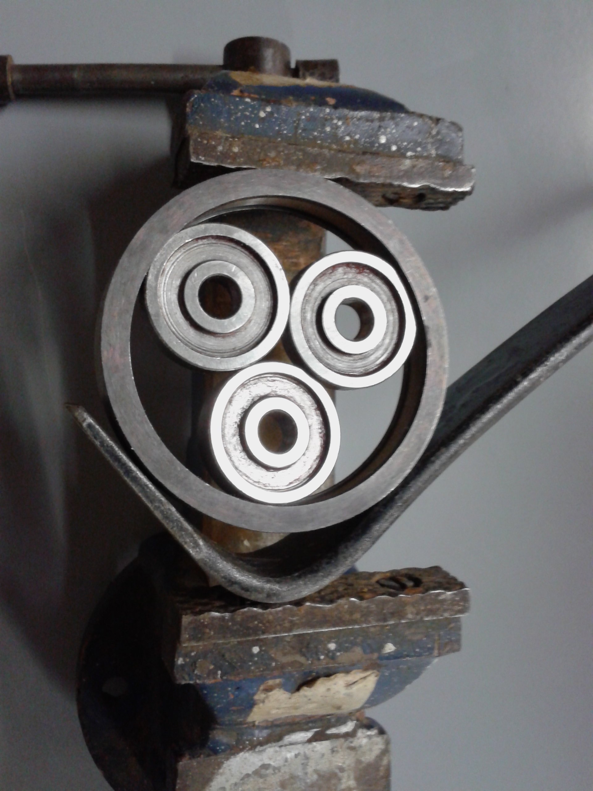

August 26, 201411 yr Author Tried it with the Bench Vise and some tooling, but that didn't work well.

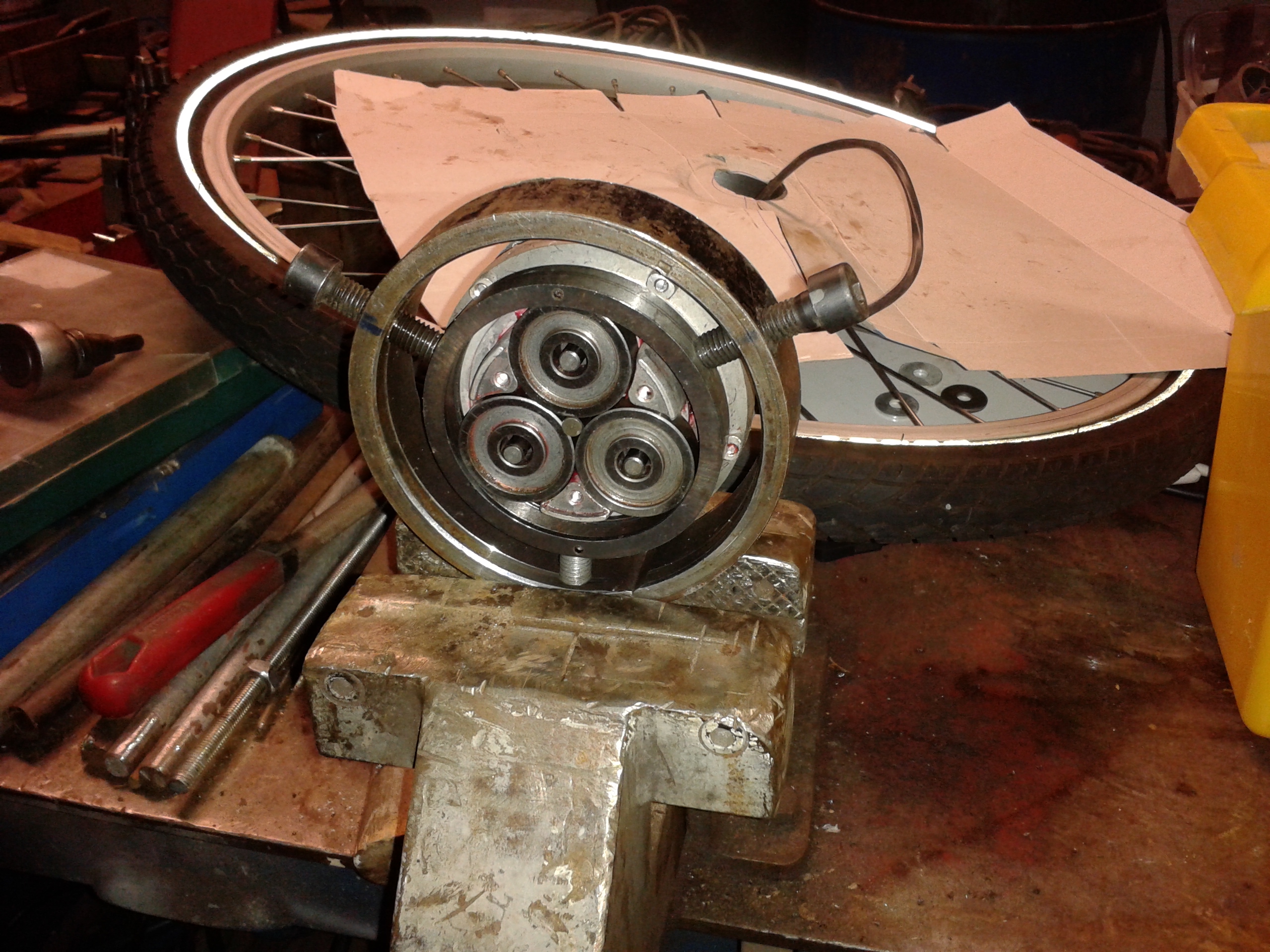

August 26, 201411 yr Author Tried a hydraulic Press too, that that was scarry. So I didn't finish it. The only remainig option was a ring with 3 pushers like the one showed on the video. Doing so, all pieces came nicely together in a fraction of a second. It worked and I was happy as a kid. Placed the 36 bearings, grease and all the screws and rings. Wheel back in place, all functioning properly. Happy ending. The old lady can use the bike again. I hope the ring will last for some time. Thanks all for guidance.
August 26, 201411 yr Author the Well done on getting the ring fitted I like the fitting tool this ring is a part that I had cut off from a 12V motor starter. I drilled 3 holes and put M10 thread in it. This did a perfect job. M8 might have done it as well.
