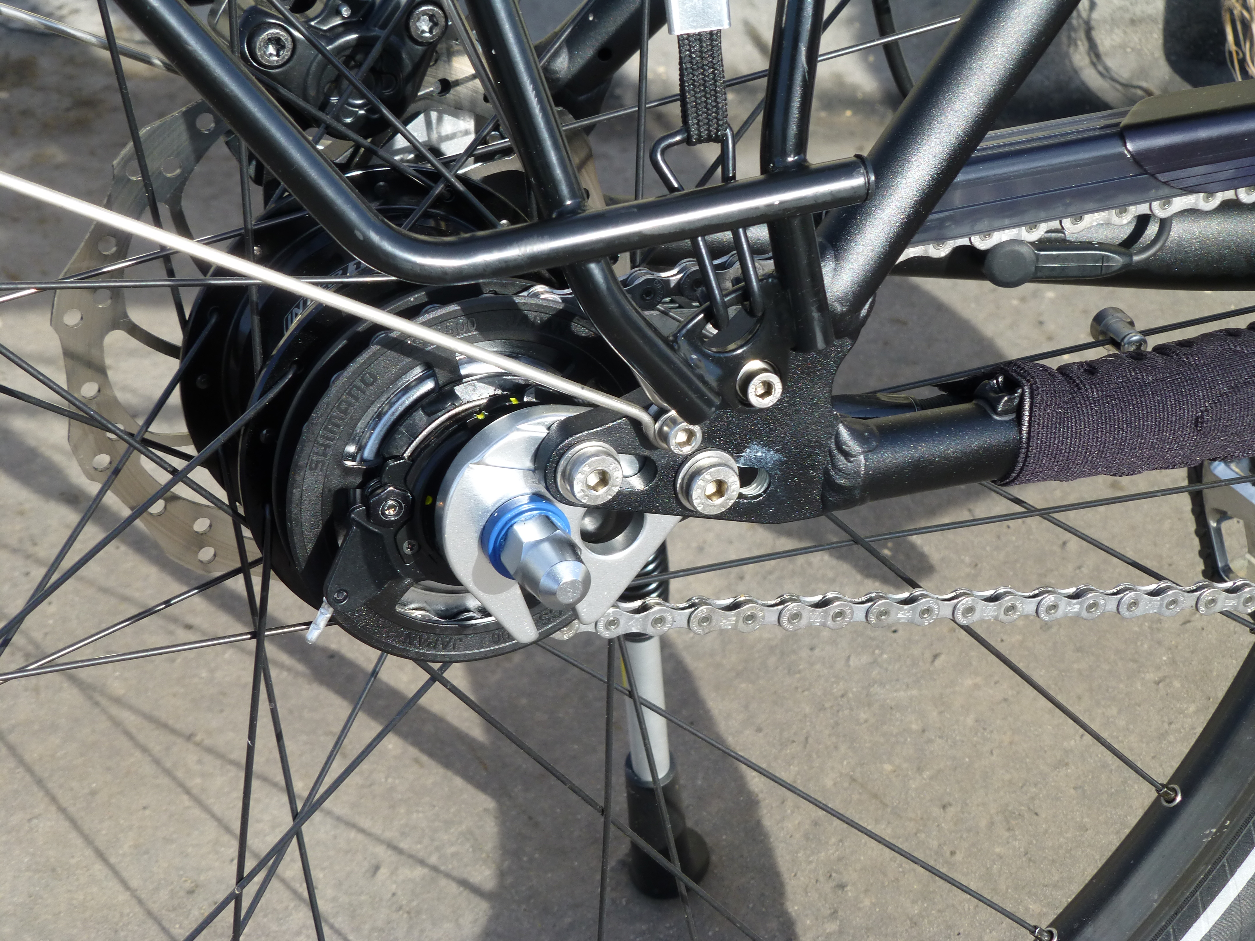

The wheel may be moving in the dropouts due to not being sufficiently tight. A slight movement at the centre of the wheel will be exaggerated across its radius and may be enough to cause the sensor interference that you describe. At higher speeds the chain generally transmits more power and could be pulling the wheel out of line.
When setting the wheel, leave the chain off so that you aren't fighting the tension. Then connect / join the chain when you are happy with the alignment. A torque wrench may be a good investment for you, especially if you have damaged the frame and are worried about stripping the axle and/or wheel nuts. Lots of screws and bolts fix into aluminium on modern bikes, so it's easy to incorrectly tighten them.

My view is the Kalkhoff dropouts are designed for cassettes/derailleurs and are too spindly for hub gears.
Problem my be exacerbated by the power of the crank motor.
The dropouts on the Rose frame are beefier, and the shiny metal plate which the hub gear axle sits in is also thicker than the metal on the Kalkhoff.

I can confirm that my 2015 model still has forward facing dropouts. Just like the 2012 version bike it replaces.

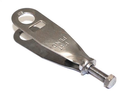

Given the delivery delay from HollandBikeShop (especially since they require a signature and I'm redirecting the package to a postal drop-off place that probably won't sign for it), and the fact that you indicated doubt about whether they'll fit, I decided to order two pairs of all four of the Batavus chain tensioners available on that online shop's site.
Batavus Chain Tensioner 62 Mm Bolt 45 Mm
Batavus Chain Tensioner 45Mm Bolt 30Mm
Batavus Chain Tensioner Short Stainless
and my latest find:
Bicycle Chain Tensioner Batavus Stainless
One of them ought to fit! Then I'll have a whole bunch of useless chain tensioners. But I don't want to have to take my bike to the workshop and leave it more often than I have to. Sucks to have a new bike off the road for so long.

The new dropouts are shown on page 8 and 9 of the Kalkhoff Highlights 2015 as well as Details of the Development Department:

@[mention=9180]JohnCade[/mention] I received the first set - the Batavus Chain Tensioner Short Stainless. I've got to tell you I can't see whether they might fit or not. I can say that the Nuvinci hub on my bike and the way the frame/dropouts are designed does not make it look easy to fit the tensioner in on the drive side. I wish someone who has fitted these things could write a bit about how they are fitted and show some pictures. Below I've posted some of mine. In picture 3 you can see me holding the chain tensioner near where I imagine it goes. The thing occupying the acrew directly behind the wheel bolt is the anchor for some cargo straps I have over my carrier rack. They used to fit differently on my previous Kalkhoff. Picture 4 gives you the lay of the land. Any comments?
Thanks for the info on the new dropouts. I can't see whether mine are different, because the automatic shifting stuff covers part of the dropout. I think they are different from the 2012 Agattu, because the way the baggage carrier and any possible straps fit on is different.
IMG_2012.thumb.jpg.7ed8bedb4dbc18b00c66a800b0d87ef5.jpgIMG_2012.thumb.jpg.7ed8bedb4dbc18b00c66a800b0d87ef5.jpg IMG_2013.thumb.jpg.b9cb8fca2f02a2d2be006cf676879888.jpgIMG_2014.thumb.jpg.59963e580336ab21427bf4605a55d2d8.jpg IMG_2015.thumb.jpg.543e59e3bff592650684f4c31b81f881.jpg
Your dropouts don't look the same as the latest ones. I'm not a hundred percent sure but I don't think they're using chains at all now except on the derailleur bikes. It's all Gates belts now on the hub gears. Or perhaps they haven't changed all the bikes over yet.

That bolt which you say the straps are attached to is not the same as mine or your old one. The pull can probable be made to miss it but whatever it's attached to might have to be moved.
@[mention=9180]JohnCade[/mention] Success! I got the short chain tensioners installed. They fit and now my wheel seems to run true. All good so far. The other ones arrived a couple of days later and now I have quite a collection. Two of the types sold by the HollandBikeShop.com seem to be identical:
Bicycle Chain Tensioner Batavus Stainless 104484 2 € 2,25 21.00% €4,50
Batavus Chain Tensioner 45Mm Bolt 30 mm 142471 2 € 1,95 21.00% €3,90
The Batavus Chain Tensioner 62 Mm Bolt 45 mm version is clearly overkill, and pricey at
€19,80 for 2.
I wonder whether the larger versions might provide more strength for holding the wheel in place.

Glad it seems to be working. I find mine has stopped any wheel movement. I didn't need the longer one though, the shorter one would have done. I thought they did all seem to be the same but the descriptions such as they are were different...
The P&P wasn't exactly cheap either. I expect someone would take one or two off your hands if you post an ad here. I might have one myself.
Just noticed that he seems to have put them on with the adjustment bolt facing inwards. How can the wheel be adjusted like that?
