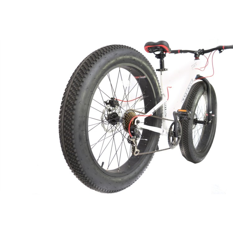

December 30, 201411 yr Is it by any chance one of these http://www.gooutdoors.co.uk/coyote-fatman-fat-bike-black-p328471 ? Coincidentally I was in the local store yesterday while my wife was looking at the clothing and had a brief look at one. The Coyote Fatman weighs 22Kg before you start adding electrics. If anyone is interested we could supply them, but couldn't really sell for much less than Go Outdoors. Here are some more photos.
December 30, 201411 yr Author Hi John, it looks very similar but it's the fatfish bike from argos. Will post up link n pics when I get home. Would a kit fit those from gooutdoors?
December 30, 201411 yr Hi John, it looks very similar but it's the fatfish bike from argos. Will post up link n pics when I get home. Would a kit fit those from gooutdoors? Hi Tezdread, The Argos bike is identical to the Coyote, only cheaper and sold under a different brand name. I think the dropouts on both those bikes may be too wide for standard hub motor, the eZee e-Rex has narrower tyres so that the standard hub motor will fit. I would suggest a visit to Go Outdoors where you can at least see one in the flesh and see just how heavy it is. Personally, I would want to test ride one first without power.
