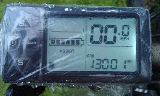

December 7, 20169 yr Author Woohoo, look what pic I just found. I was sure I'd taken this a few weeks before my LCD went pop. I can feel a new Avatar coming on...
December 8, 20169 yr Your LCD isn't very polite, I read 13001 MILF ... When you shrink it down to avatar size you should be OK but maybe a little bit of Photoshop would clean things up? I once put up a photo of an optimist dinghy and all hell broke loose because with the sun shining through the sail the number looked like a big swastika!
