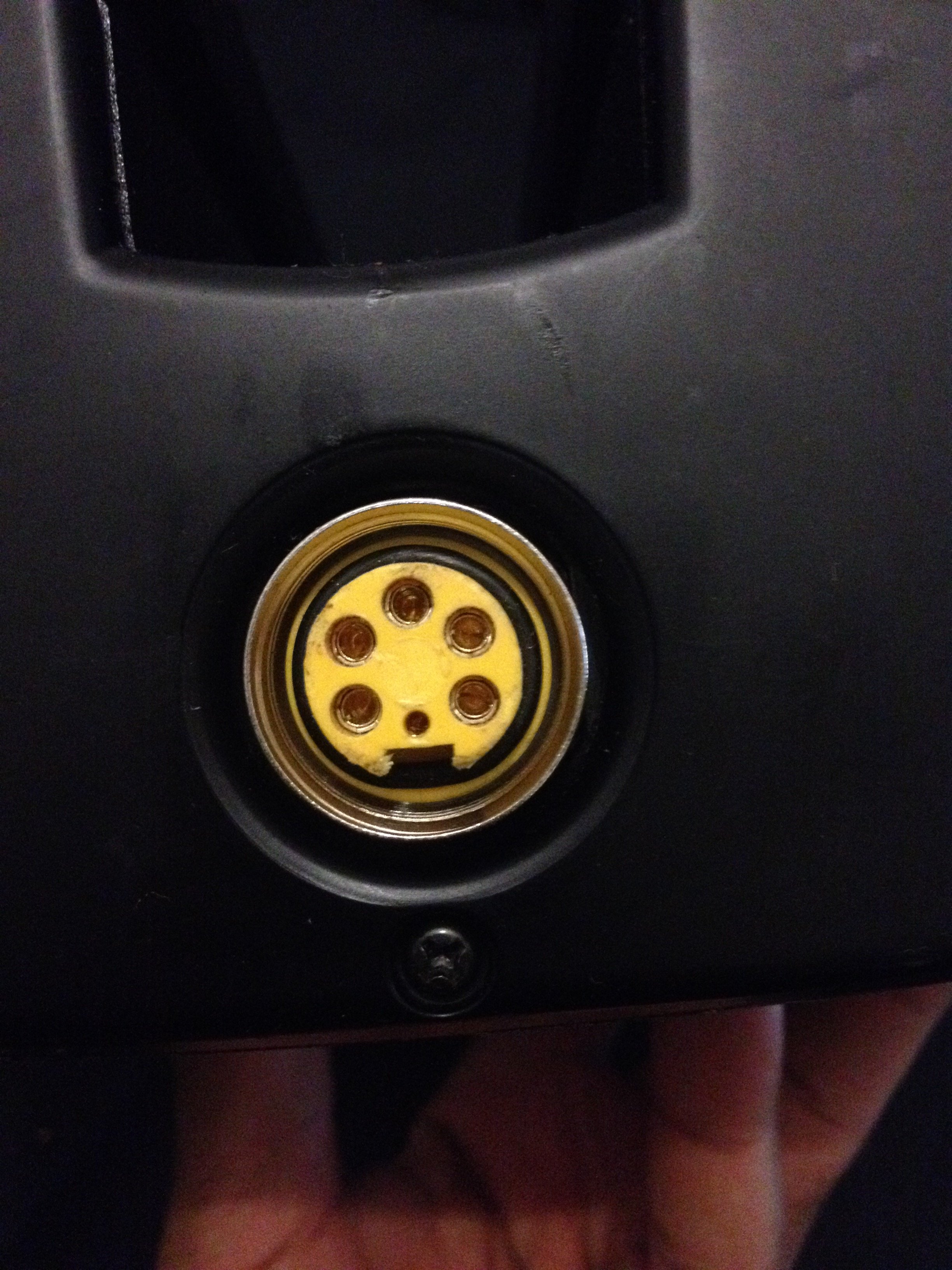

Hello guys, quick question. I had my a2b stolen still have the battery. I was wondering if I could use it on conversion kits or will it only work with a2b bike? It's a 36v/13.2 Ah Lithium. Here is the connector.
Thanks
If you can find the right plug to fit that socket and wire it correctly yes you can use it with a kit.
Ok thank you I will try to contact a2b. I thinking I could just jam some wires inside.
How would I go about find out what each hole does? 1 ground, 36 volt maybe also 5v
Sorry newbie, managed to open it. How would I go about wiring? Red and black are plus and neg I guess. Not sure about the yellow and orange, lights? computer? controller?

a2b will be able to answer that question. Plugs are good, jamming wires a very bad idea...

Close but mine is 6 pin and middle pin is lower down not in the middle. Anyway thanks but I'm going to ditch the plug. I removed the battery, had to get the angle grinder now weights 3.6kg thanks free so much lighter. Just need to pick a motor now...
