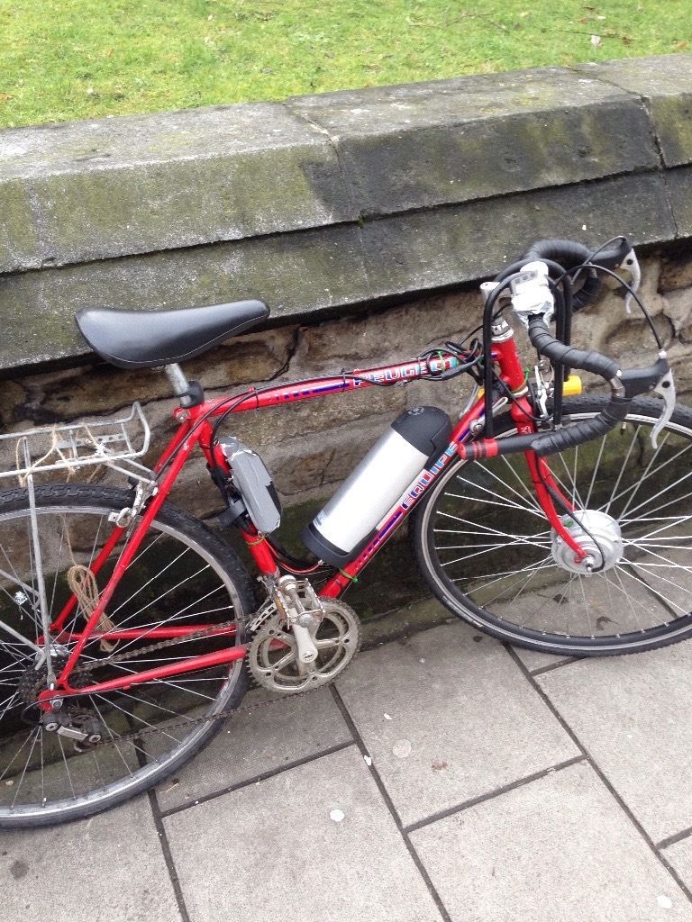

Awful brakes on my ebike
Hey so my kit (Cyclotricity 250W front) is working on myebike and its runs fine. However I wasn't able to install my new dual callipur brakes to the bike as the reach on them is way to long. What I have found is that these brakes which did fine before and I dont seam to be going that much faster now are not slowing the wheel down fast enough.
This bike has gone through many incarnations steel rims to alloy rims was the first upgrade now its gone to Ebike. My brakes now feel like im using an old steel rim. What I do notice is that the brakes dont seam to rub on the rim that well, my back brake is much stronger and I seam to be hitting both of these brakes.
So what would people suggest I do? My fork only supports calipers and uses an old nut style.

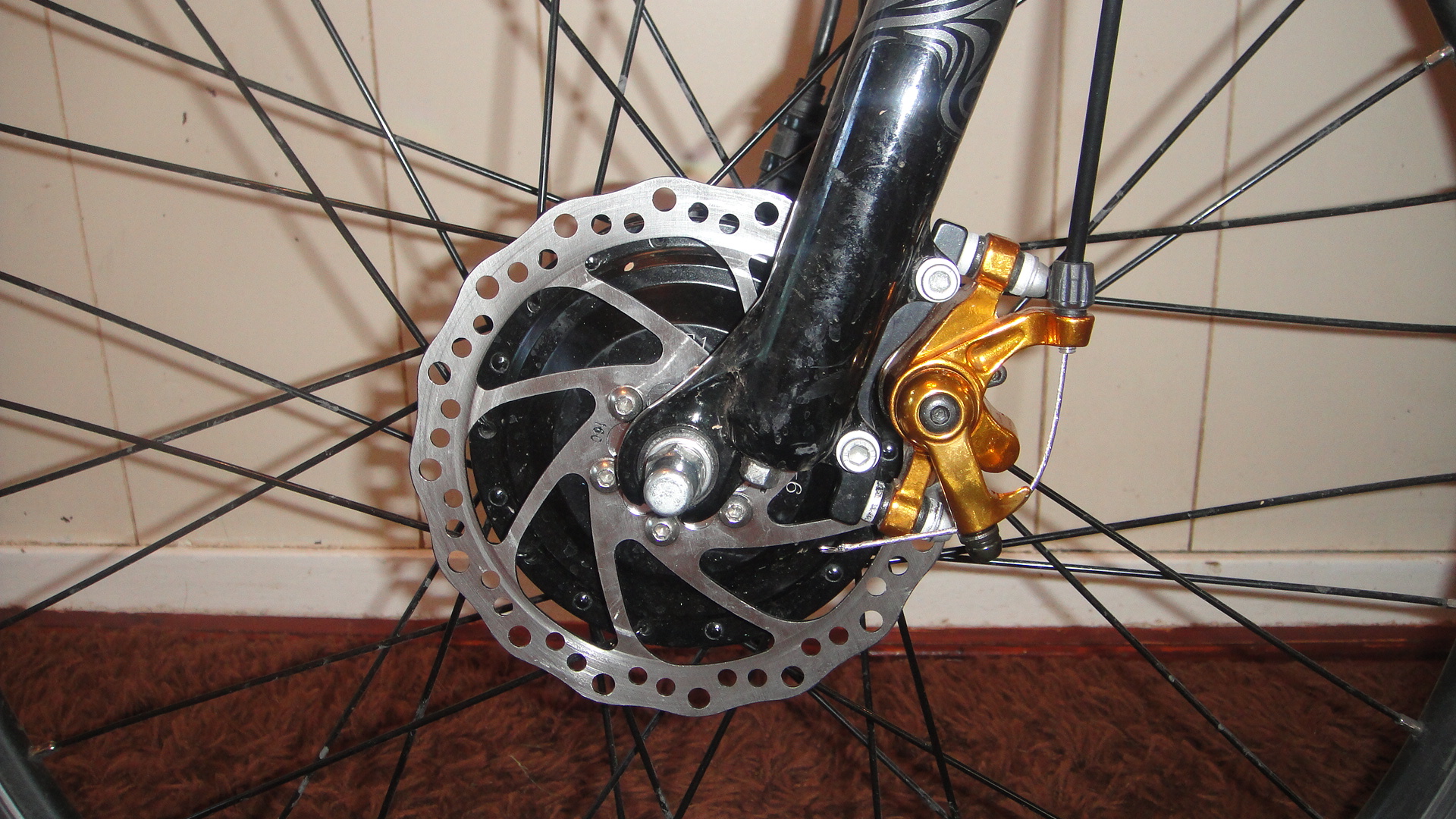

Get a disc brake set of forks. Used ones don't cost much from Ebay.Then, fit a hydraulic disc brake. You'll never want to use anything else after that.
Of course they do. Have a look on ebay for the ones you want.
Do disc brake forks even come in threaded quill stem form?
Yep, I've got threaded Suntours on mine. Although not as common nowadays, you could probably find a set of old stock at a reasonable price.

Got any more info on your current fork?
Maybe a piccy and manufacturer details.

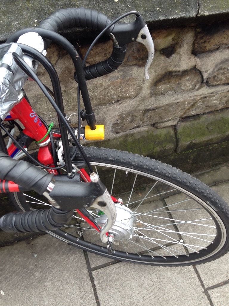

Heres pictures of my bike. It is a carbolite 103 I assume the fork is the same its just got a puegeot logo on the front.
Woah, was expecting something entirely different. Might have a 1" steerer tube and not the later 1 1/8", so I would imagine disc brake forks are even rarer.
Have you tried changing the brake blocks for maybe a softer grippier compound?
You have a classic road bike with single pivot side pull caliper brakes, attached with traditional hex nuts rather than the modern design with recessed allen nuts.
I do not think that a disc brake conversion would be a good idea in this case, even if you could find the right fork, as the fork would necessarily be significantly stiffer than the current one and give a harsh ride. This change in fork stiffness and ride quality does not happen with an MTB or hybrid with either already quite stiff rigid forks built for off road use, plus fat tyres, or with suspension forks and fat tyres, hence people with that type of bike find going to disc brakes an improvement without any drawbacks.
Suggestions to change the pads could bring an improvement, and the suggestion of Swissstop pads is good, but the ones linked to are for v-brakes, you would want the 'Flash Pro' variant for caliper brakes, and I would pick the green GHP compound for use in all weathers on and off road, however they are not cheap and I find they do wear the rims at an average rate, whereas BBB Roadstop BBS-02 are better value, very nearly as good in the wet as the Swissstop GHP and very low rim wear:

http://www.ebay.co.uk/itm/700c-HYBRID-FORK-V-DISC-MOUNT-1-STEERER-25-4mm-260mm-90mm-THREADED-STEERER-/391677720153?hash=item5b31cfb659:g:p6kAAOSwa~BYU~HJ
I have disc forks on one of my road bikes and I have two others, one with carbon fibre forks, the other is a classic type similar to yours. I can't detect any difference in ride. Forks are rigid, otherwise your bike wouldn't handle properly. This is the same argument as whether an origininal 1959 Gibson Les Paul sounds better than a modern one made with 57 years of experience, computer analysis and design with modern electronics. It would be one hell of a coincidence if they got it right first time with no previous experience, and then could never do it again after 57 years of trying.
