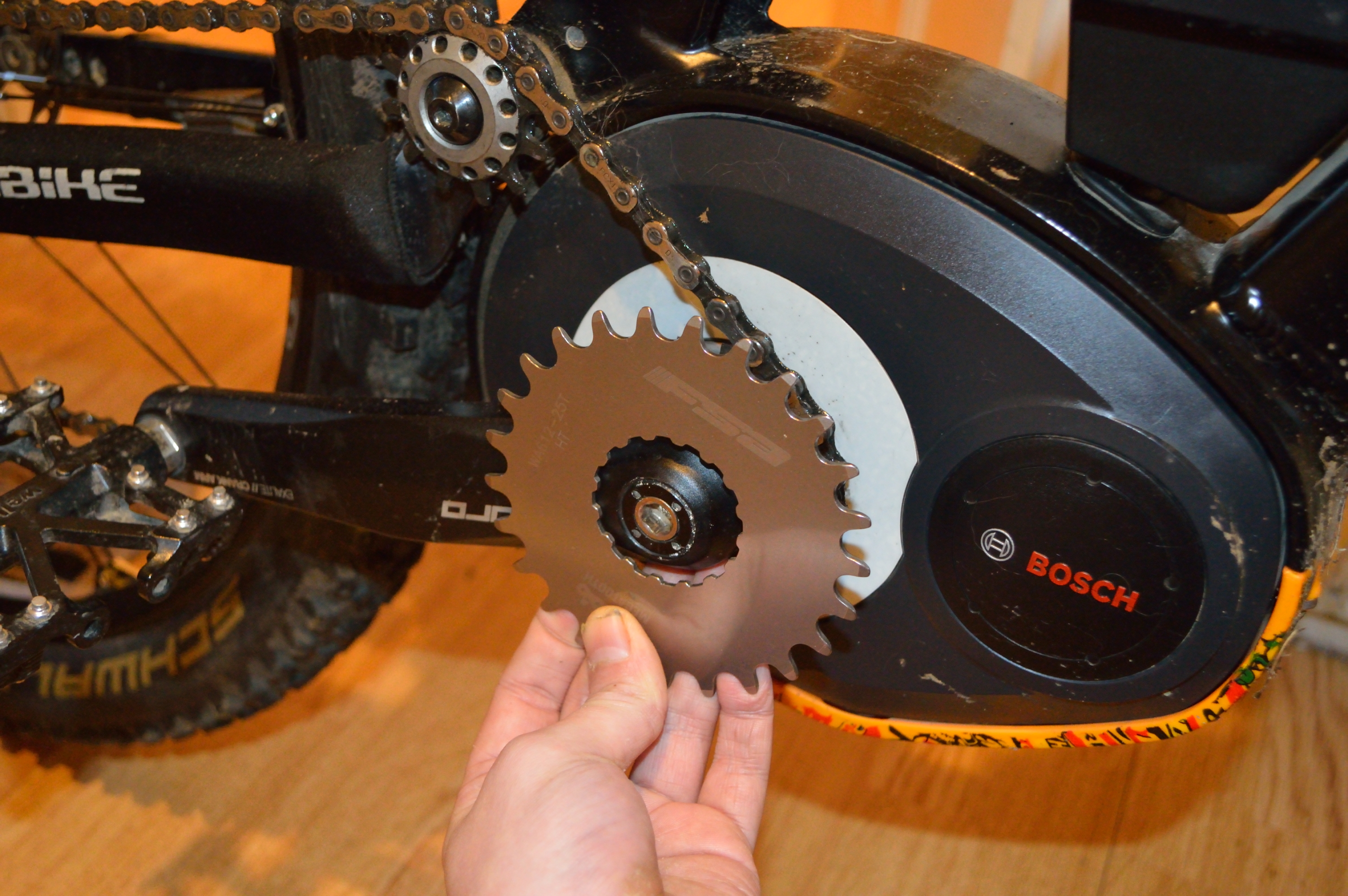

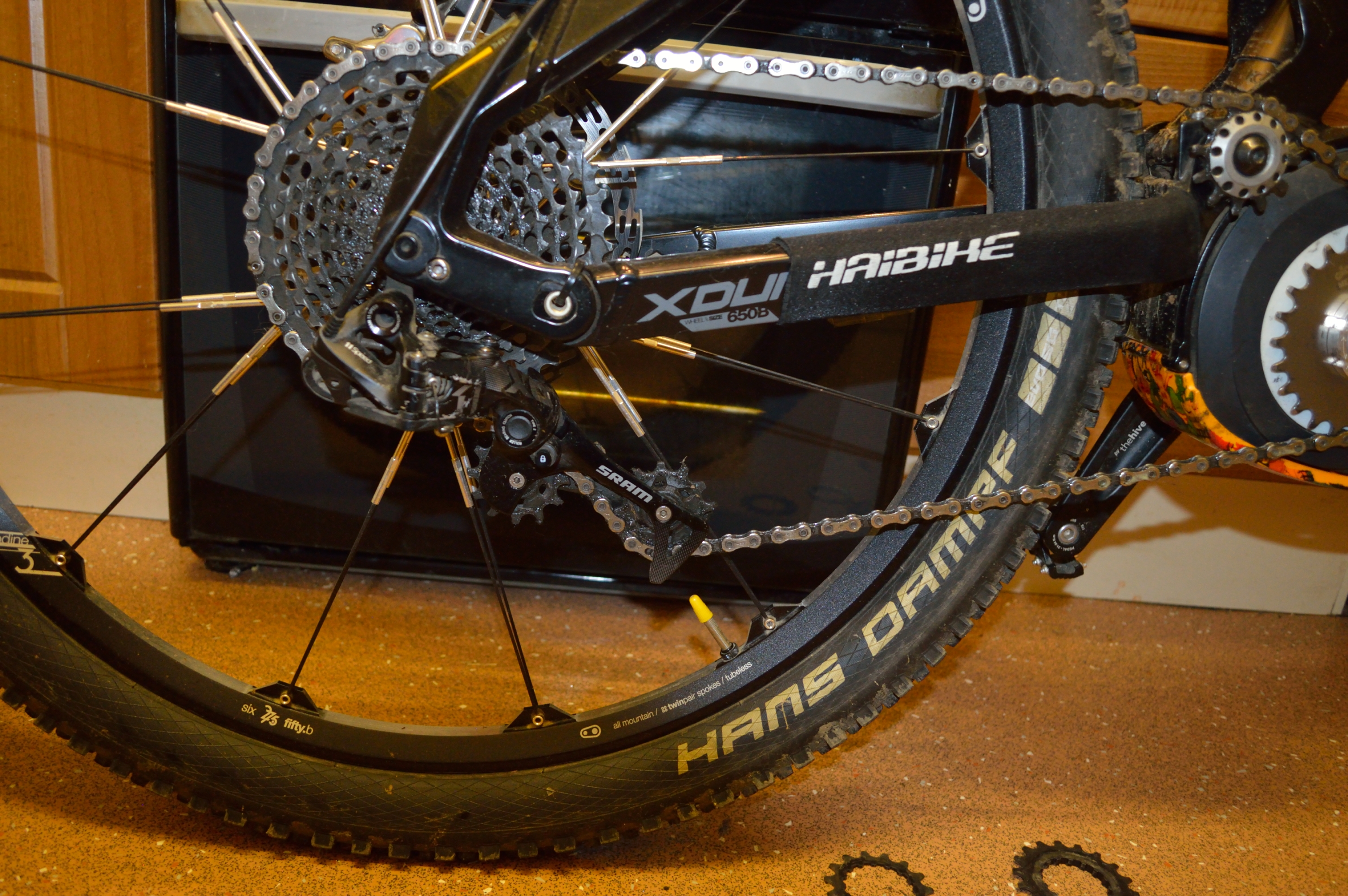

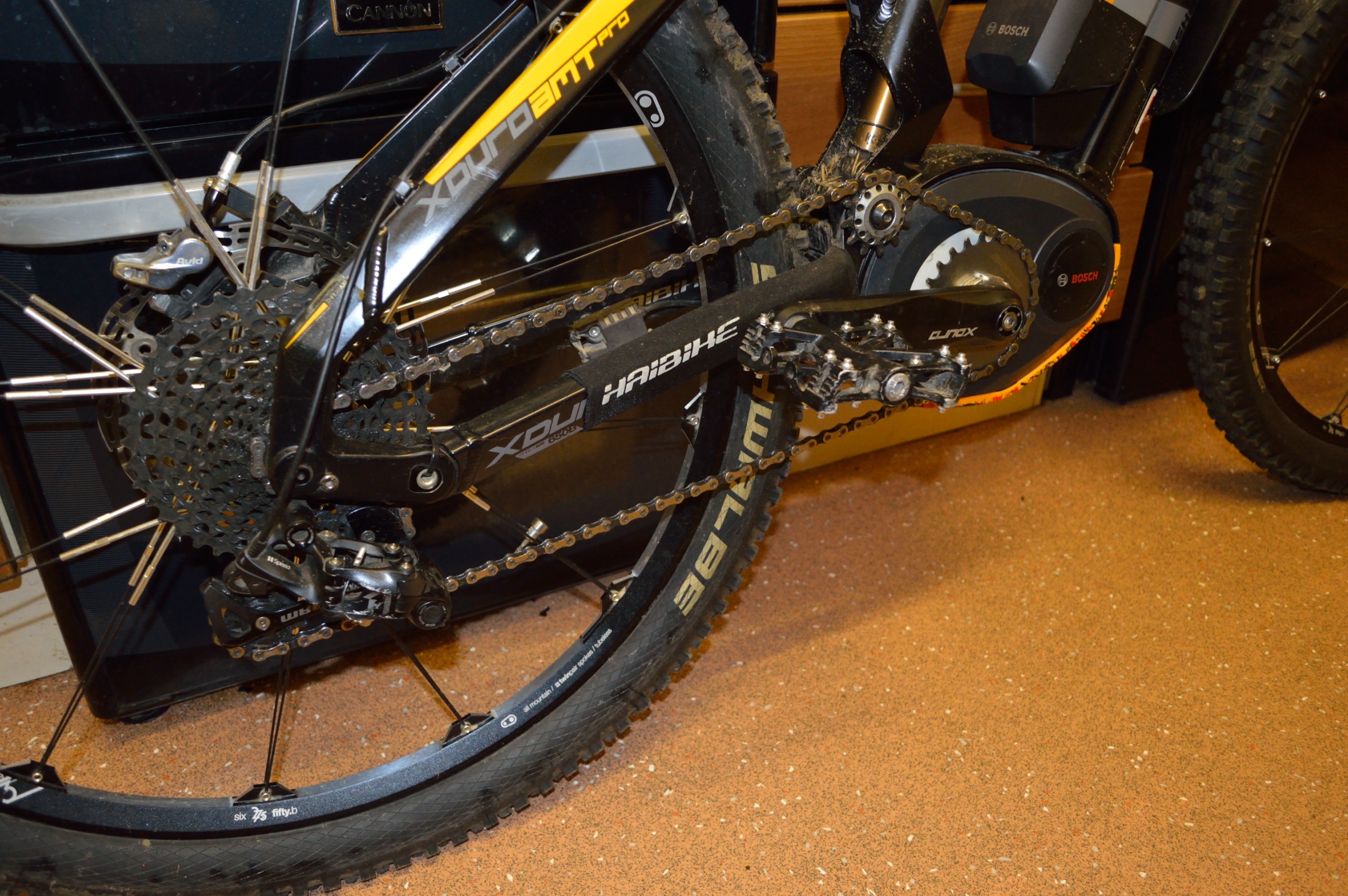

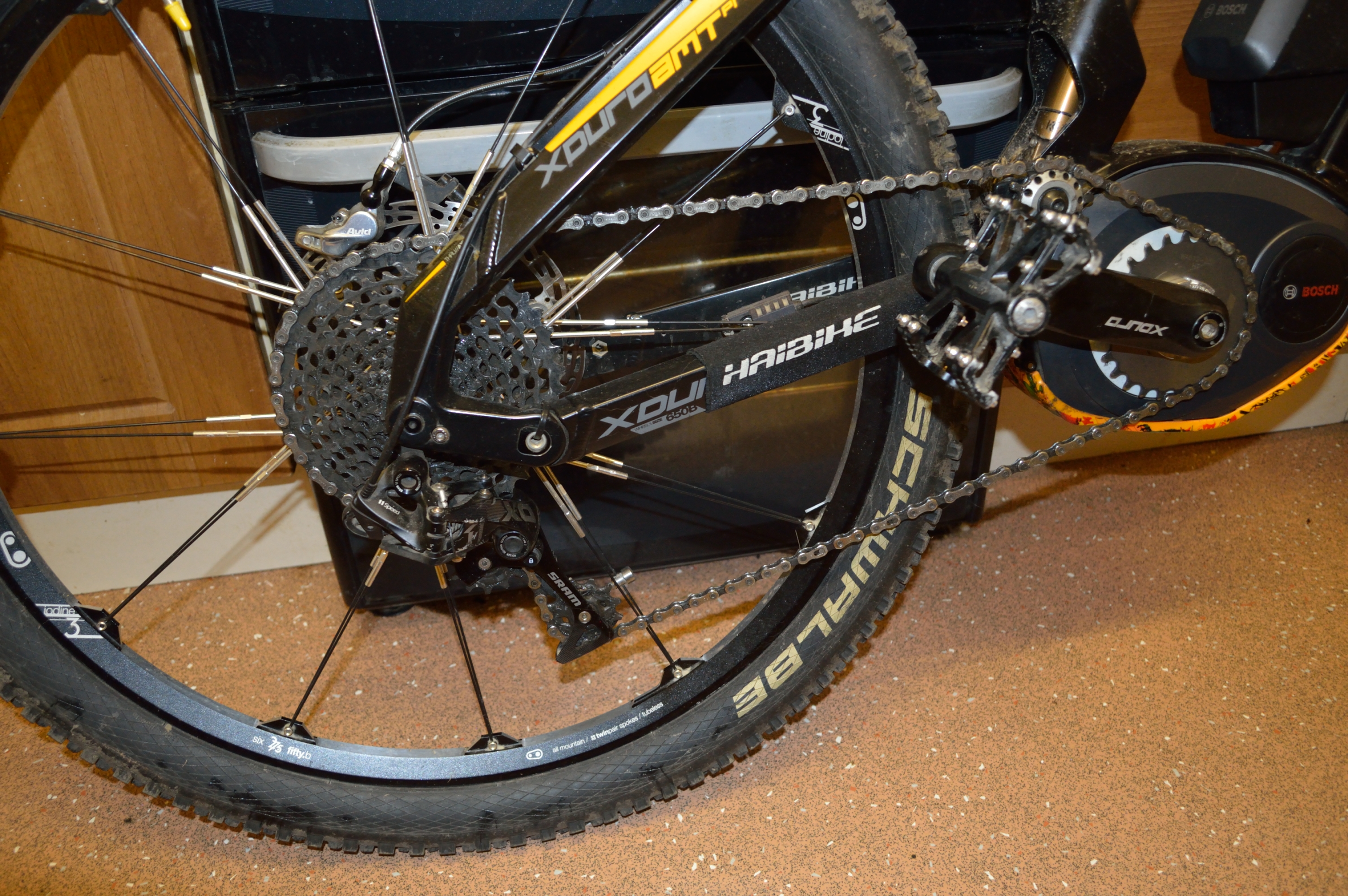

February 8, 20179 yr well looks like ill need a longer chain to use this sprocket as the rear mech is near snapping point in the 42t at the rear as it has no movement left forward wise and any force will prob snap it in half b4 the chain snaps. looks like i need an extra 3-4 links in the chain but not sure i can add links to the chain i have so will just get a new one for it another 19 quid lol. cant use the 18t on the inside either as it wont fit the other way round as you cant push it in far enough so cant get the 25t on as well as no thread there to hold it in place. if they made a bloody spacer you could mix and match sizes to a point say 4-5t difference in size b4 you will get chain length problems like above.
February 9, 20179 yr Author It actually look clean on bike, and clearance from casing. The derailleur is long (i assume), so longer chain only way to go. Be interesting to see what speed you can average comfortably, also if you have enough gearing for steep hills. My problem is i like to tinker with bike set up as well. Great when it works. Keep posting, as interested in outcome. I've done last 4 evening rides around 22-26 miles each night, playing with batter life, modes and cadence. The best so far was this evening, cadence 85 average, 21mph average, 26 mile ride, sport mode and 20% battery life left. I'm trying to find the sweet spot between battery life, speed, mode and cadence. Still thinking i might tinker with the bikespeed rs and 20t combo.

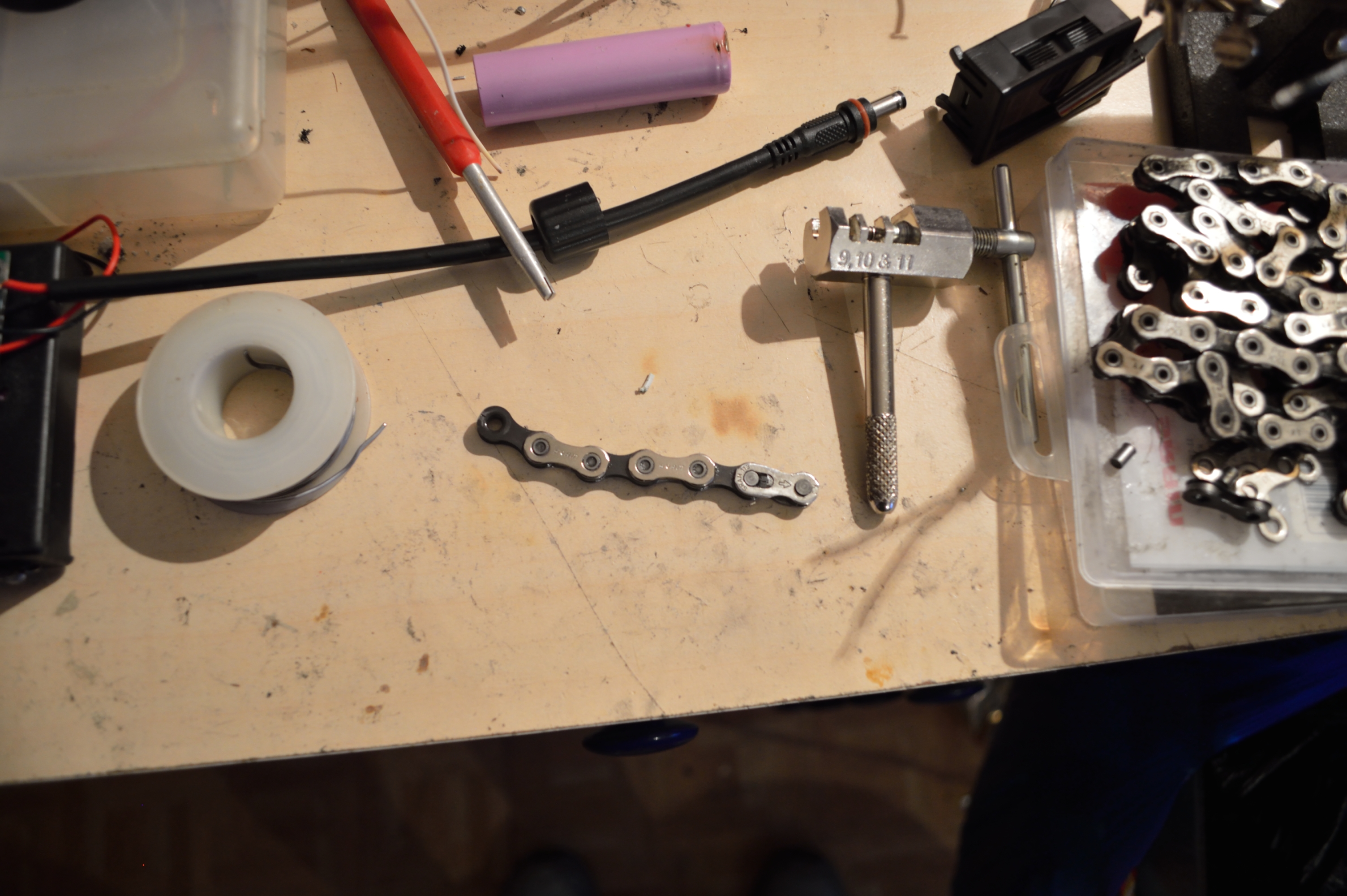

February 9, 20179 yr i can add power links but 4 off them is 11 quid on ebay or a hole new chain is 19 quid so best off just getting a hole new chain tbh. that is the ex1 in 48t on the rear and 50 on the eagle http://singletrackworld.com/wp-content/blogs.dir/1/files/2016/03/Screen-Shot-2016-03-24-at-09.41.34-640x358.jpg

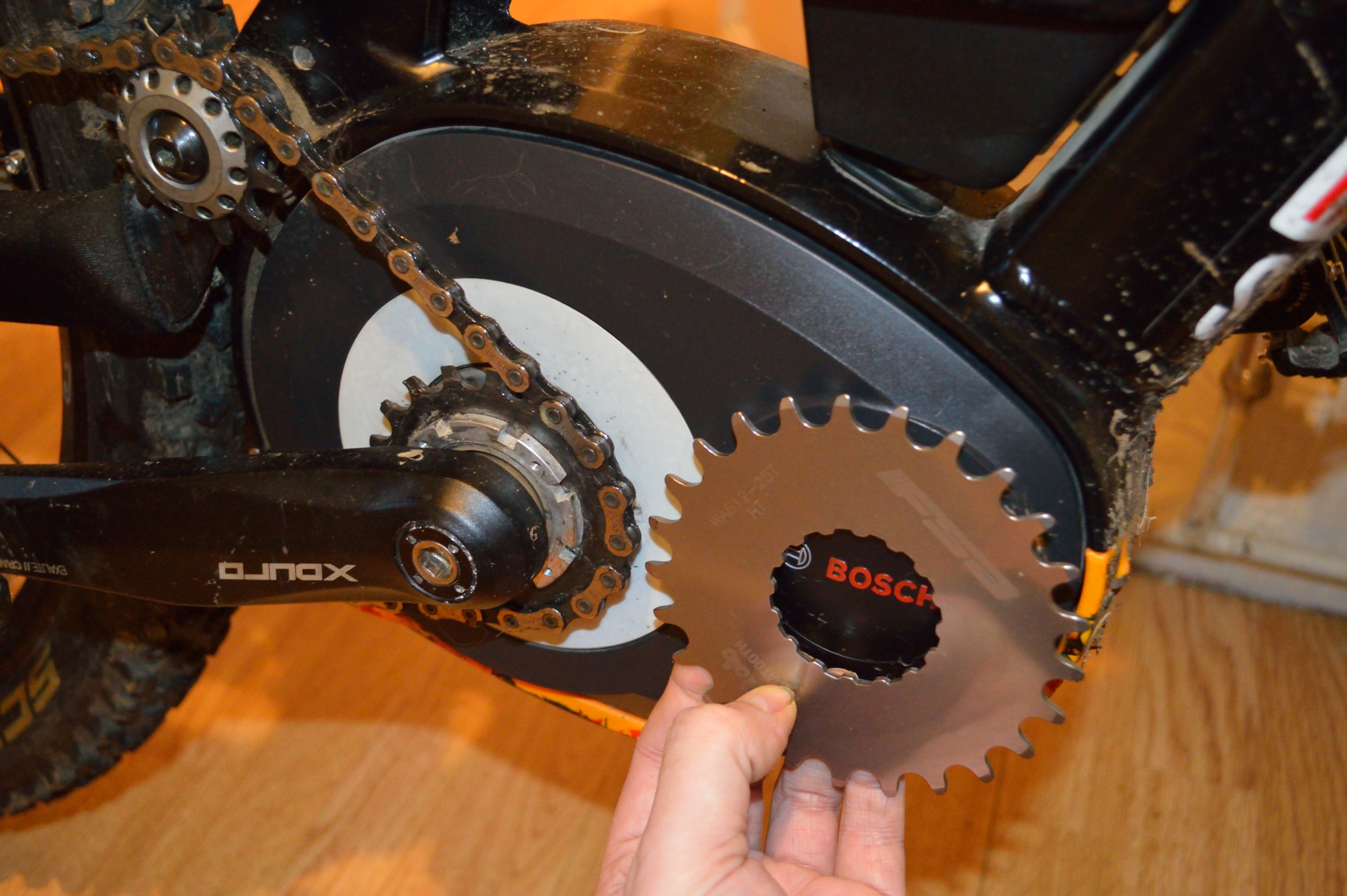

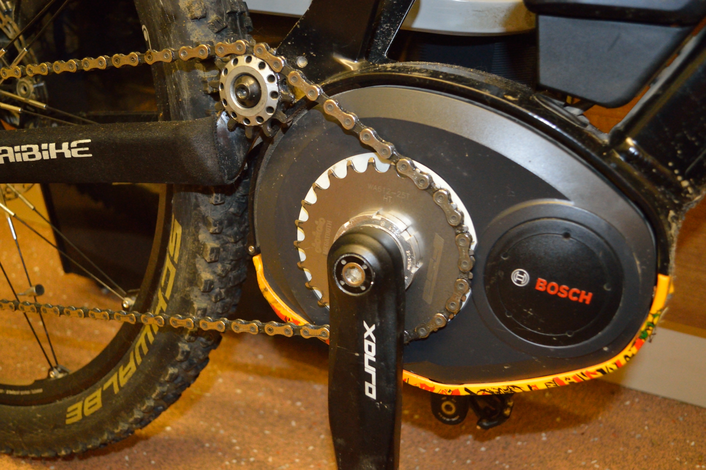

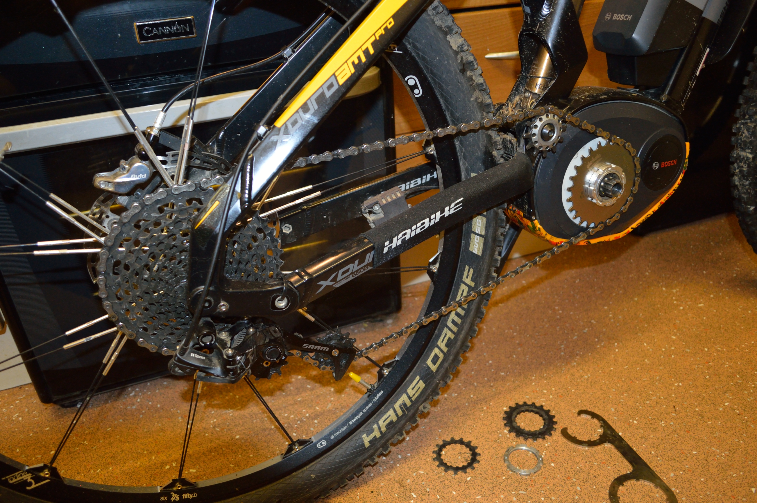

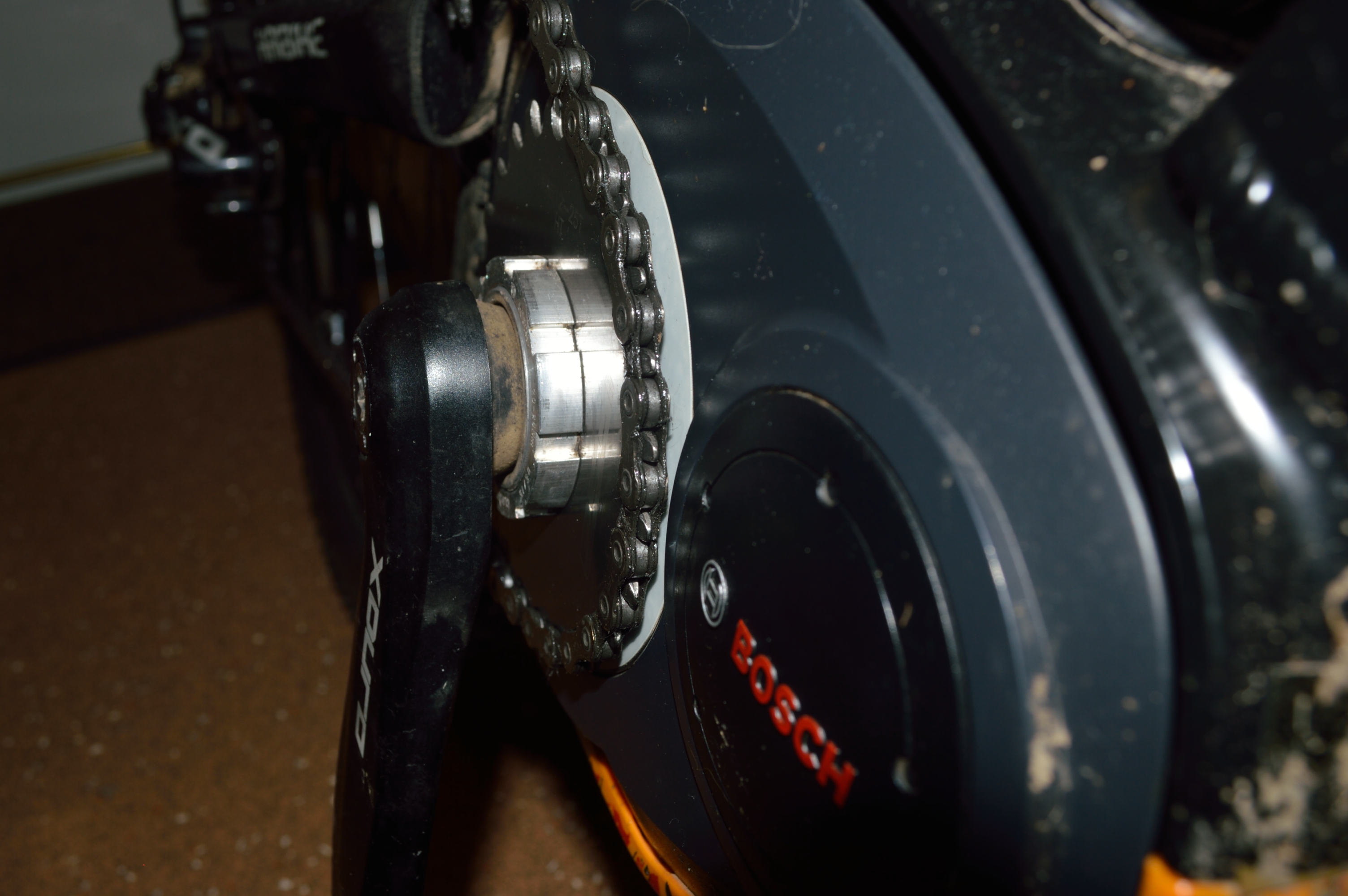

February 10, 20179 yr if you have a 20t connex sprocket then all you need do is get a smaller 14t sprocket then use that as the spacer and then the 20t will clear the case. eddie pj might have a worn sprocket he could post out to you.

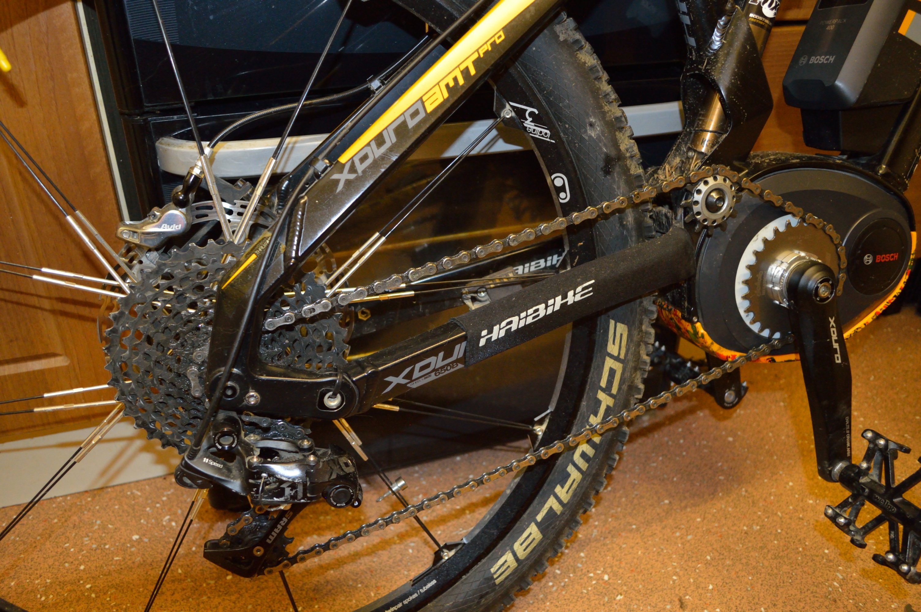

February 20, 20179 yr i might just have enough spare chain as that is 6 extra links so should be long enough now i went up 7 from 18t so extra 6 links should do it tho not sure i should link 11 spd chains like this as bit of a bodge job tbh as just re used the link pin.?
February 20, 20179 yr Author Good effort, see how it goes, but yes i would be better off with a new chain knowing the pressure its under.

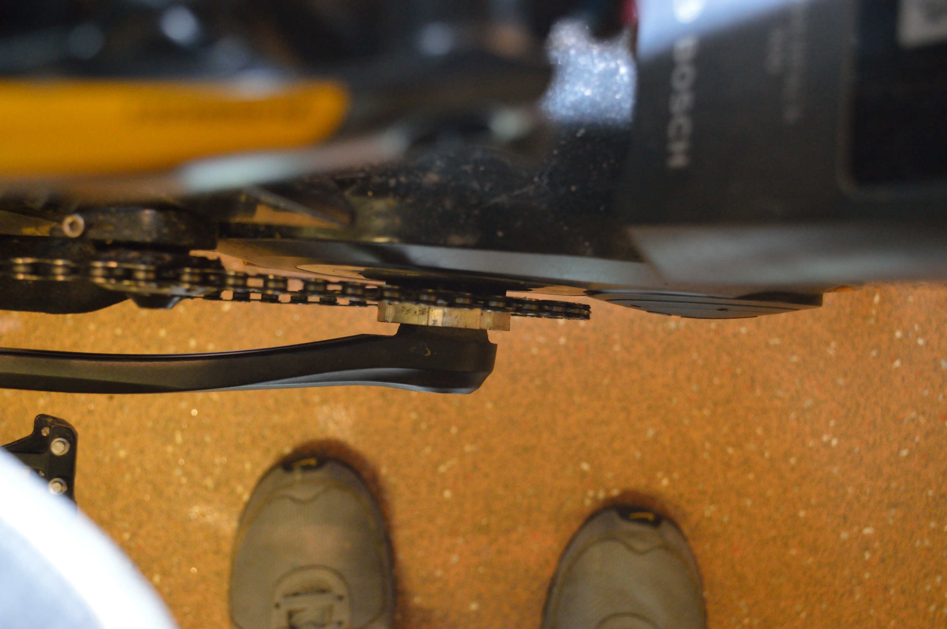

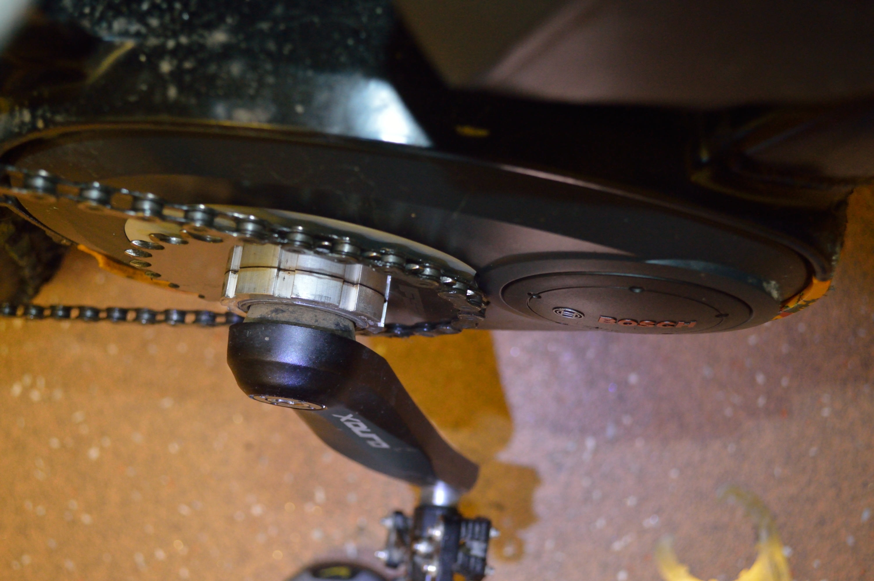

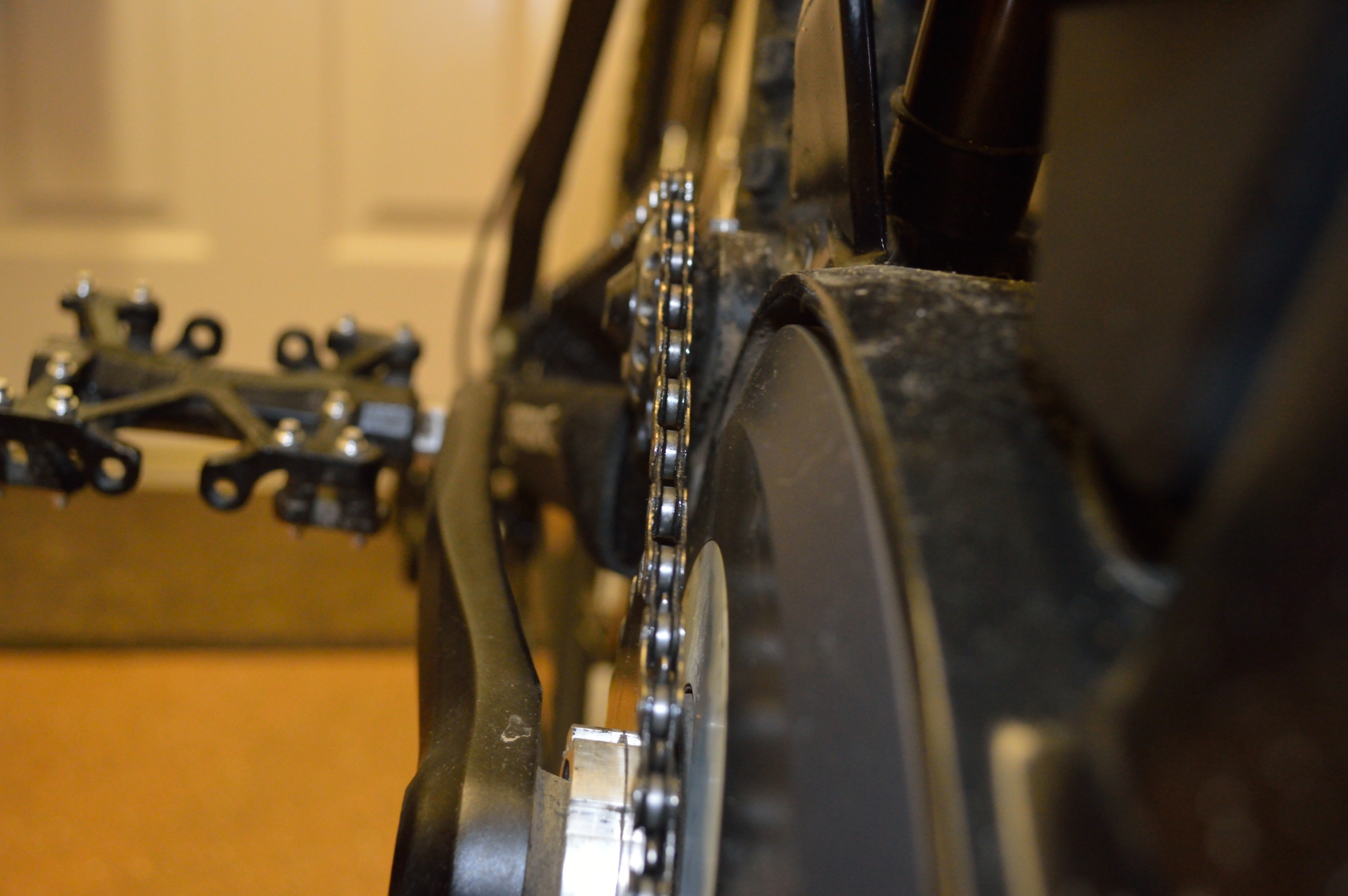

February 20, 20179 yr well it took 4 extra links but had the same problem as the connex sprocket as felt grinding from the motor in most gears so used the 15t i had as a spacer as the ses wheel put the chain on a angle inwards on the 25t sprocket. i can still feel it grinding in some gears but might be the spacer in the ses wheel for the dual kit but it soon goes when i shift down to a smaller sprocket. it is helping with lower rpm of the pedals but top speed hit a wall at about 34mph i only went round the block and is blowing a gale outside but i cant see you getting to 40mph on the flat and doubt if you did get going that fast would not be there very long at all as the motor is just doing nothing assist wise. or im just not very fit lol i also had to adjust the b screw to get the shifting right again. i also have to use the 42t at the rear just to get going and then just use the gears so on the flat using the full range of the cassette but my 42t is made of alu so will wear it out fast imo. ill leave it on for a few rides and see how it goes but i think 25t is a bit to much on a mtb that is as heavy as mine 21kg. ill add some pics later
