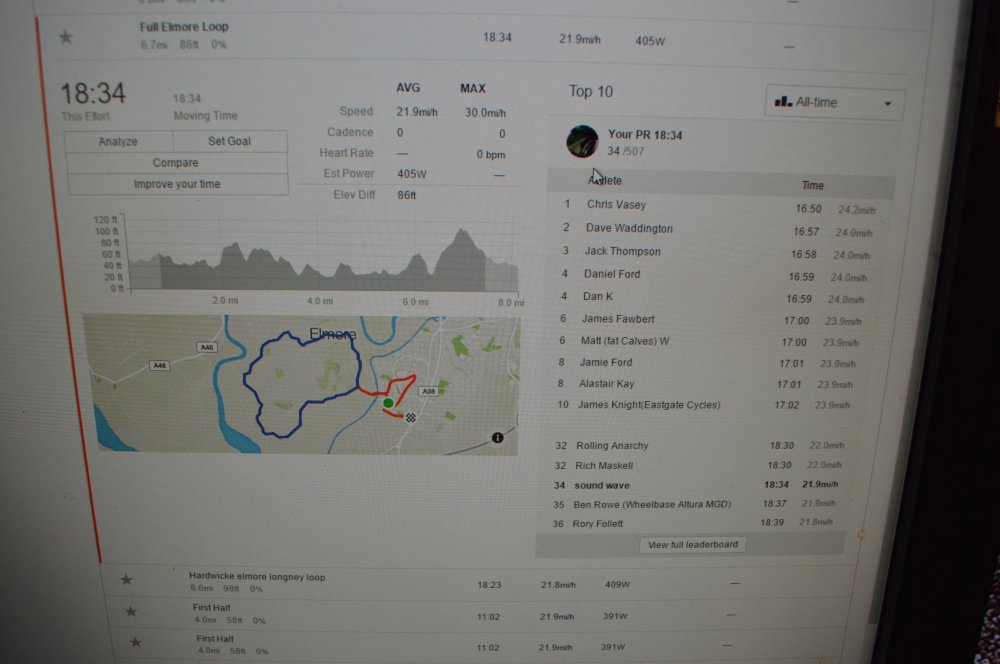

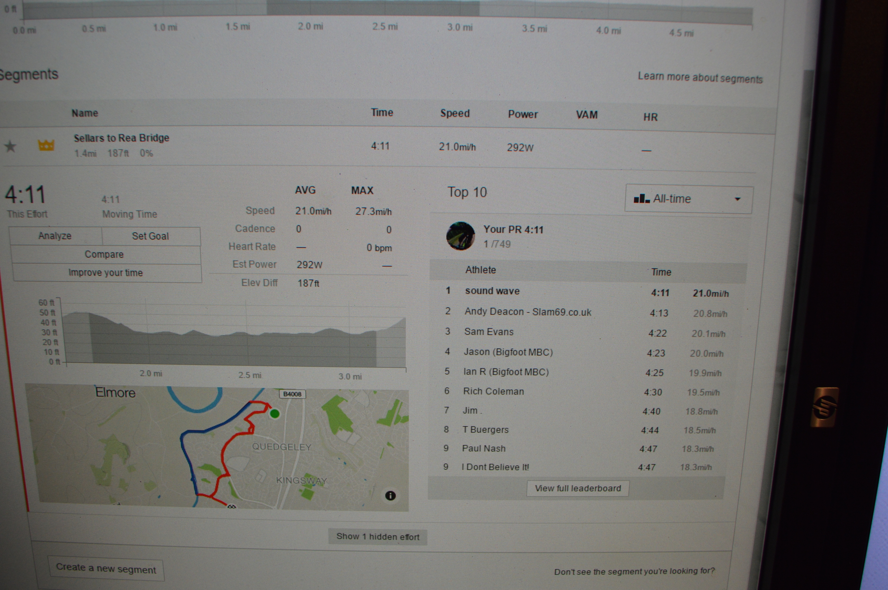

Got to do more testing with 20t see if ok on climbs etc, and see if i can hit the 40mph. OMG it's like being back on STRAVA!!!!
Hey, all the ones above you must be on motorbikes, or you stopped for a coffee :)
I might have to reef havoc on strava, i know some people who live for KOM's.
the last one is my m8s strava but if i had no dongle id be left for dust tho he rides a road bike most days he was kaput after that ride tho lol.
