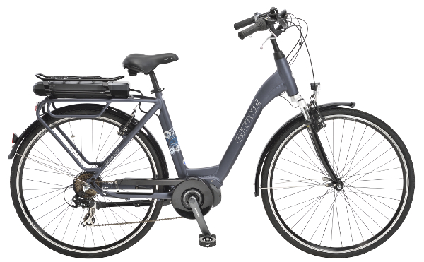

That frame looks remarkably like the Oxygen....
It looks similiar to an Oxygen but the rear frame part is different, the bit which connects to the seat frame is lower on the Oxygen, now I remember they changed something a few years back on the Oxygen because something bust when a suspension seatpost was added, maybe that's why the rear frame connects lower down to that seat frame, I dunno, I think they made something stronger but again I don't know the specifics of what.
If your comparing with the Oxygen MTB, it has a cassette motor and cassette gears, which are chalk and cheese compared with Shimano Tourney freewheel gears. It has Suntour XCM forks which are a step up from XCT. Chainset means chainwheels and cranks. The Oxygen has tripple chainrings Shimano Acera.
In the post above, I was comparing the S-cross CB, which is closer to yours and does have XCT forks and a freewheel motor, but it has an Acera chainset and derailleurs.
