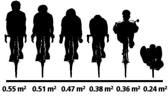

July 11, 20178 yr Good questions. The range they quote is just an estimate using pretty optimistic parameters. Never take any notice of what anybody else gets. range is always personal to you and your rides. It can be anywhere from 20 miles to 200 miles on a bike like yours - or on any other bike. The only thing that would make a difference is the capacity of the battery, though, obviously, you'd get some difference between a MTB with wide knobbly tyres and a thin light bike with a crouched riding position. No magic wand will help you. If you want to go further, you need to get a bigger (or extra) battery or pedal harder. Actually, I lied. This magic formula will work, but try not to let the secret out. Ride an average of at least 10 miles a day; stop drinking everything but tea, coffee and water; and eat only salads for the next 12 months, then you'll have no problem doing that coast to coast ride on one battery charge.
