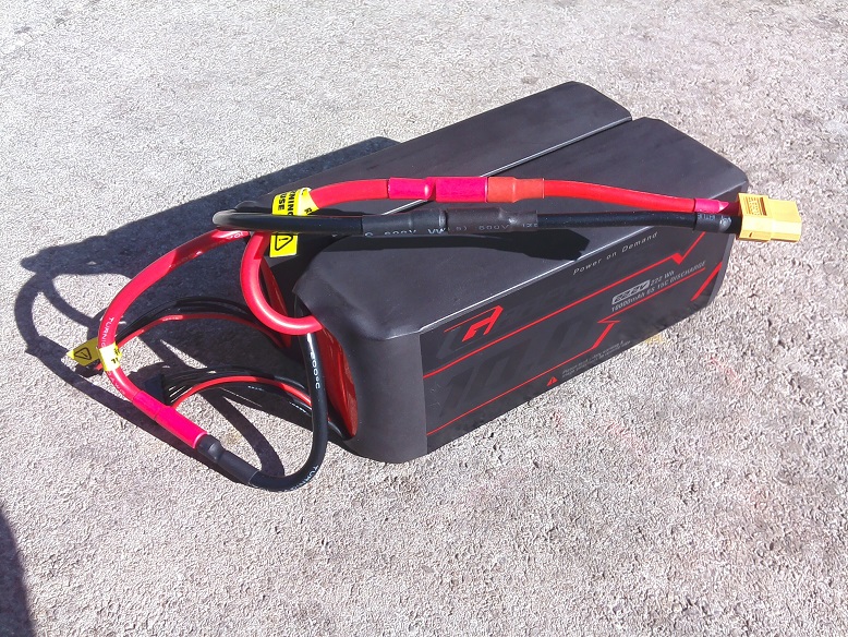

They charge faster than Multistar without any visible puffing (already very slight on Multistar), stay balanced provide plenty of power without sag...
I am running Multistar and Graphene 10000 mAh 6S and 4S packs paralleled and in series for 20 Ah 37 V nominative. When I run the light 10 Ah pack I always use the Graphenes now, the Multistars stay at home :)
I've got 2 4s & 6s 8ah's when on offer, a bit heavier then
MS's. They already have XT60 so no messing about changing connector for me. 35/40 min bulk charge to 41.5v from storage V's.
Sag is about 0.02v.

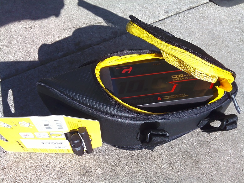

10s 10'000mah fits nicely into this Topeak Mondopack XL which I will fix in permanent when I start using them fully. Only tried them a few times and seem good.
These 10s 10ah were only aprox £120 when on offer once, I also like the bullet connectors for an easy series connection.
