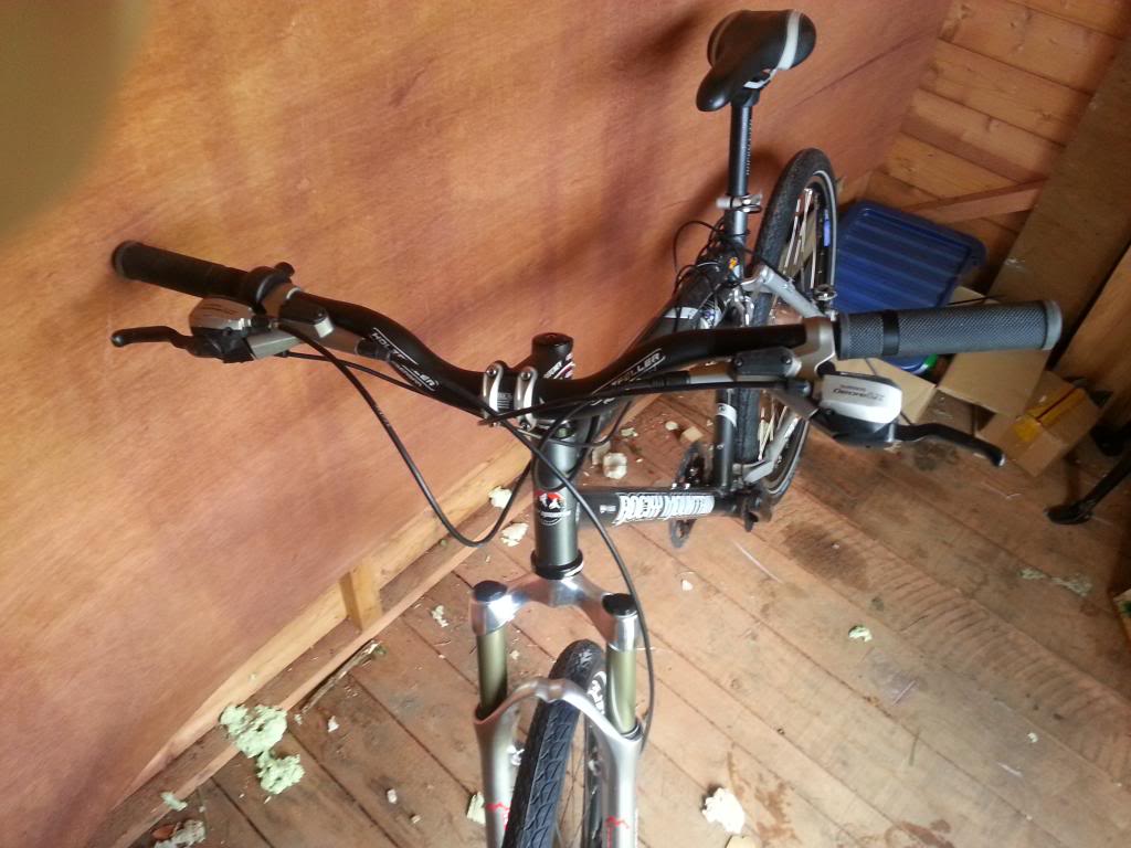

Next problem to solve is handlebar config now. My Shimano shifter and hydraulic brakes pair together well but twist throttle interferes with shifter and thumb throttle has to be positioned too far away. Any recommendations for a change in shift or brake?

Not worried about the sensors, it's fitting everything on the bars. Consolidating levers and shift seems like a good idea in the future.
