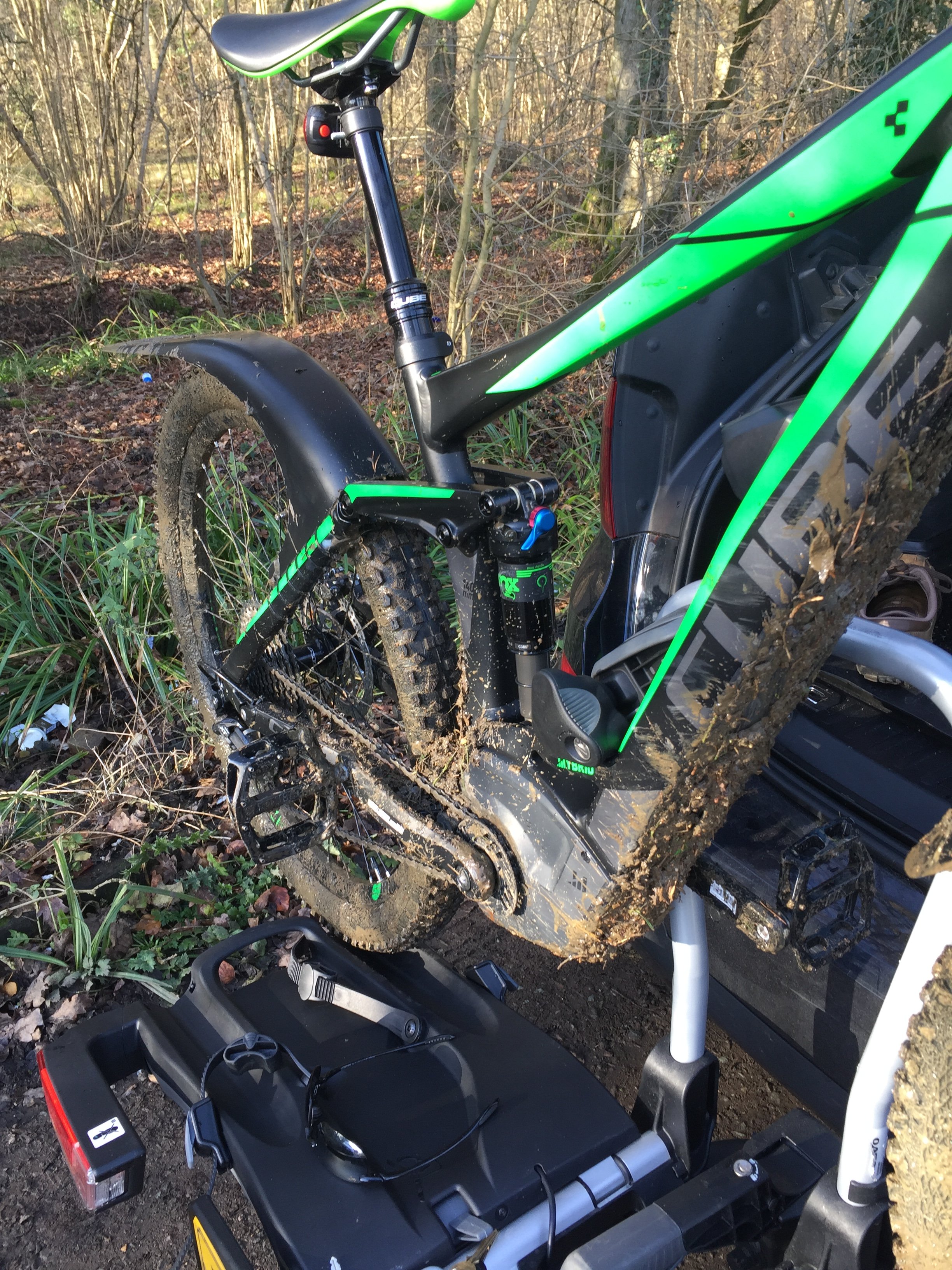

January 20, 20188 yr Hi Guys, new here and first post. Ive read all of the threads about premature bearing failure on the Bosch CX DU and can report that it also happens to full suspension bikes as well. Ive had my Cube stereo since November of 2016 and have to say i've enjoyed it throughly as I've got dodgy knees and this helps me greatly. currently the bike has covered some 1200km and last week i took it out and and rode muddy trails, almost up to the DU crank centre line. over the last short while i've been getting a little paranoid with the sound the DU is making. leastwise I'm becoming more aware of the noice the drive makes. from new i could hardly hear anything, but now..... Anyway, cleaning it as i do every time i get back, i take the chain of the drive ring and turn the crank, its definitely noisy and on rotation has sticky point around the 360 deg of rotation. So checking out the forum and I see this whole debate on CX DU bearing failures. contacting my local Cube dealer in Bedford, they are more than happy for me to take it in to have a look. first thing he asks is "do i pressure wash the bike" err yeah! of corse i do, when it gets back from a ride its caked! "do you direct high pressure spray at the crank"?" "hang on say I, i didn't know that i wasn't supposed too" so he starts on some story about washing the grease out of the bearing and all i can say is where are the warnings about this? if its imperative not to do something to the DU then it needs to be indelibly marked in the area of the bike that should not get pressure washed. right now, they have inspected the DU and have reported back that the bearings are noisy and there is some telltale rusting on the side of the DU casing. I've checked all of the paperwork from where it was purchased from and there are no advice notes that advise against washing it with a pressure lance. they will contact Bosch and ask for a returns carton to be sent out, then we'll see what Bosch's response will be. Happy to take them on as if I'm not riding my bike I've got nothing better to do. answering another posters comments about hard tail vs full suspension, looks like it make no difference to the outcome. dario
January 20, 20188 yr Don't use high pressure holes on bikes especially FS MTBs, destroys suspension bearings as well as motor's. I only used low pressure ie hose on shower setting and never degreased chain on bike. Still failed after 2000km. With replacement motor (assume bosch will sort it), on regular basis make sure you replace regrease extra seal that will be fitted to it. See earlier post for seal kit and grease, will need chain ring lock nut remover. You will need this anyway to replace chainrings with each chain. No service intervals given, its up to you. With wet winter riding I'll do it ever few rides. My bike shop never mentioned new seal kit on replacement motor, so it useless if owner doesn't service it. I suspect Bosch never told them about new seal.
