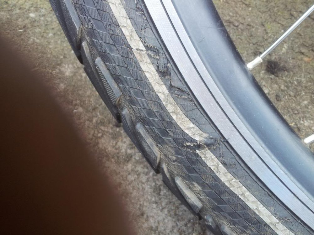

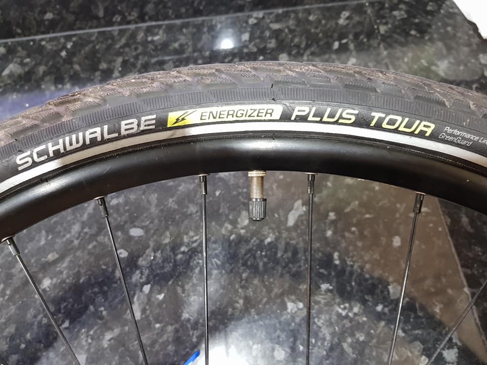

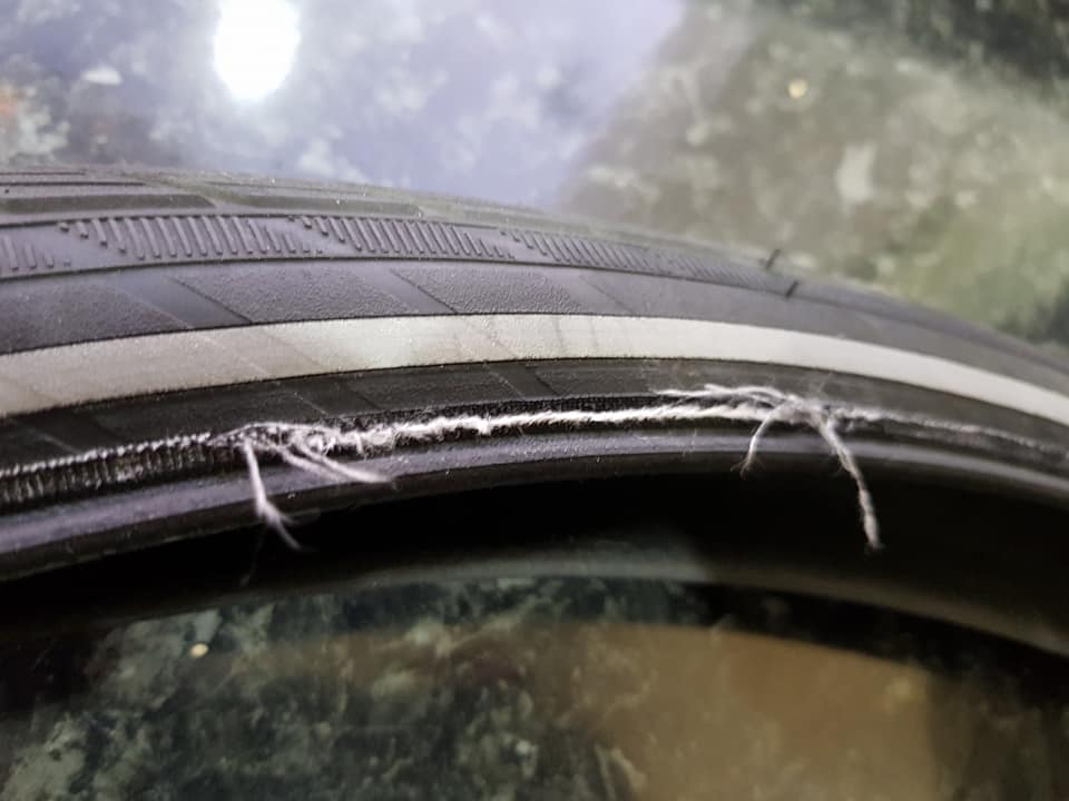

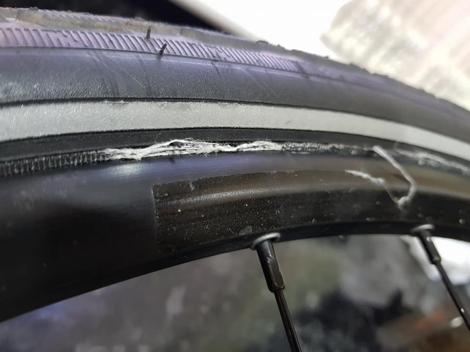

January 3, 20188 yr Hi Has anyone experience this with Shwalbe tyres, according to Shwalbe they call it 'Threading' and its perfectly safe to cut it away but its wearing badly into the sidewalls after less than 12 months use so clearly not safe to use. I have always kept the tyres properly inflated as well, think its the last time I buy Shwalbe!

January 3, 20188 yr Hi Has anyone experience this with Shwalbe tyres, according to Shwalbe they call it 'Threading' and its perfectly safe to cut it away but its wearing badly into the sidewalls after less than 12 months use so clearly not safe to use. I have always kept the tyres properly inflated as well,[ATTACH=full]22857[/ATTACH] [ATTACH=full]22858[/ATTACH] [ATTACH=full]22859[/ATTACH] [ATTACH=full]22860[/ATTACH] think its the last time I buy Shwalbe! My Michelin on the motor wheel went like that after 3600 km and 12 months. How many km on that one? That tyre is one of their cheaper ones which is why is often mounted OEM.

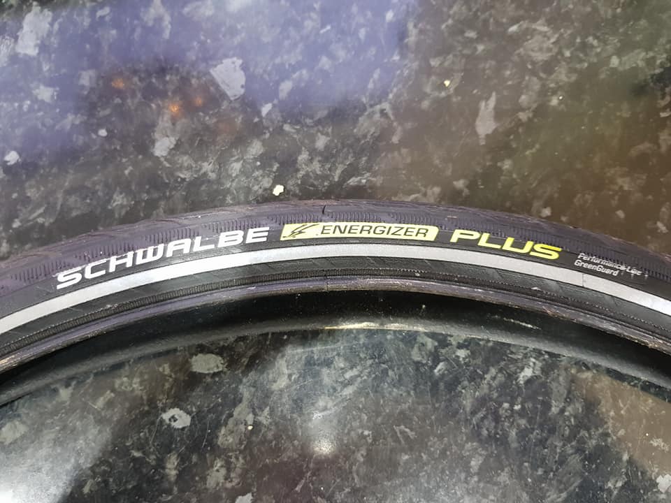

January 3, 20188 yr It actually doesn't look too bad from the photo, a shame we don't have a photo of it on the rim and fully inflated I tend to agree with the reply Schwalbe gave you and think you are the one who is over reacting. think its the last time I buy Shwalbe! This was the reply from Shwalbe, I won't be buying any more of theirs, ... Is the other one in exactly the same condition? Is it on the same side? Notice how I am trying to find an explanation?

January 3, 20188 yr I've not seen that sort of defect before, but I can tell you that it's dead easy to damage them when fitting because they have a wired bead, which means that you mustn't fold them during shipping and you need a a correct technique to get them over the rim, i.e. no excessive lever force. I can help you with the letter from Schwalbe. What they're saying is that they don't deal directly with end customers, so you must take it back to your dealer, who will give you a new one. I don't see any reason to be disappointed with that reply, and it's not a reason not to buy another one.

January 3, 20188 yr You are clearly not grasping this properly and are jumping to conclusions, I worked in engineering and fault finding all my life so I am not stupid in these aspects of things I just wanted other peoples experiences regarding tyre problems like this especially Shwalbe as I have had other makes over the years with no problems!! If you choose to look properly there are pics on and off the rim in the post of both the front and rear wheels and the front is a Plus and the rear is a Plus Tour Hi, speaking for myself, I've had not had this or any similar issues with the Schwalbes I've had and would probably buy from them again. Clearly you seem to think, perhaps with your background for fault finding, that it's a bigger issue than Schwalbe seem to think. Out of curiosity, what would you have liked the response from them to have been? Happy new year by the way.

January 3, 20188 yr Going out on a limb here because we don't know if the "fault" is on the same side of the bike: - I agree with d8veh's theory of bad instalation - if the two different types of tyre have the fault on the same side regular rubbing when parking or tyres exposed to direct sunlight when parked? I have given you the reasons so just forget it pal you are obviously just out for an argument No I am not. Tyre and brake problems are important for us all. Our life depends on them. I called you out on an anti-Schwalbe rant when the important is finding the cause of your problem. Is the internal structure of the tyre exposed? From the photos I wouldn't be so worried they don't look deformed or in a critical state.

January 3, 20188 yr A bike rack could cause that sort of problem too - on a car or where you parked your bike.
