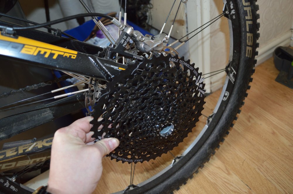

thats the front and rear axles from my bike those alone new are 50 quid each and built to last and take a hammering.
