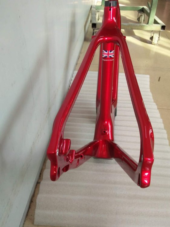

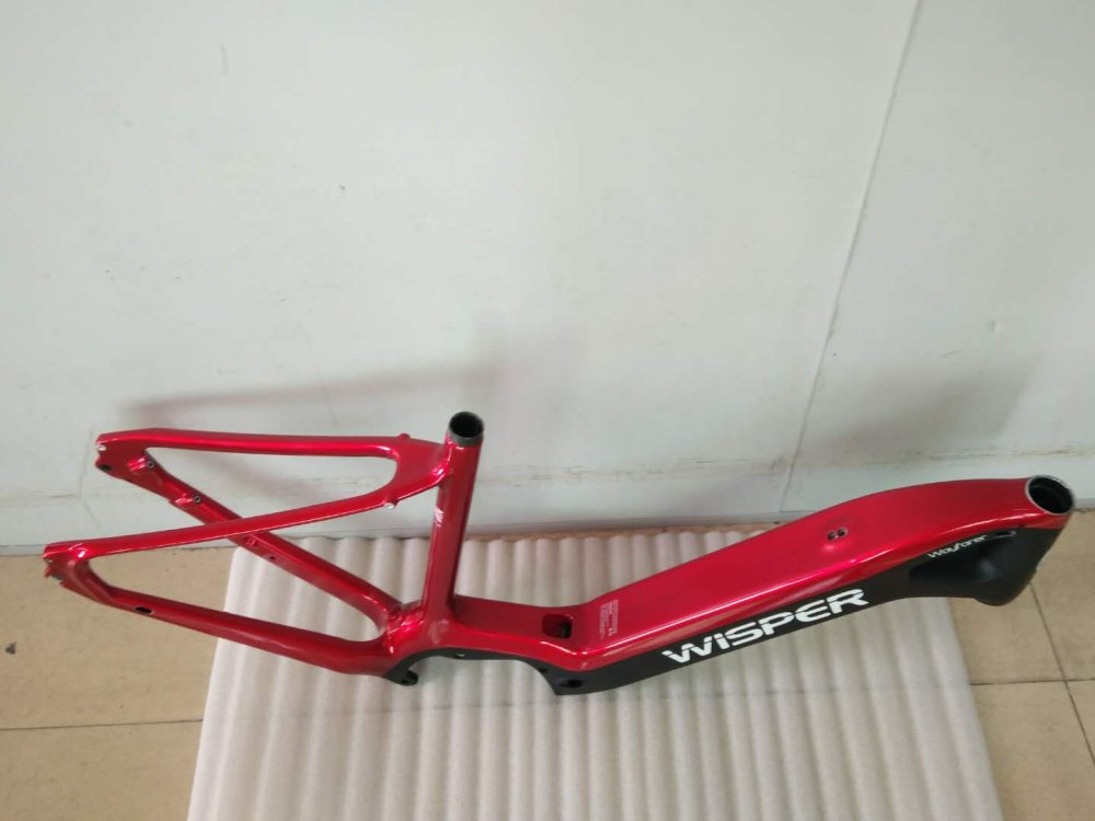

Here is the frame design, in frame battery up to 500Wh.
All the best, David .
