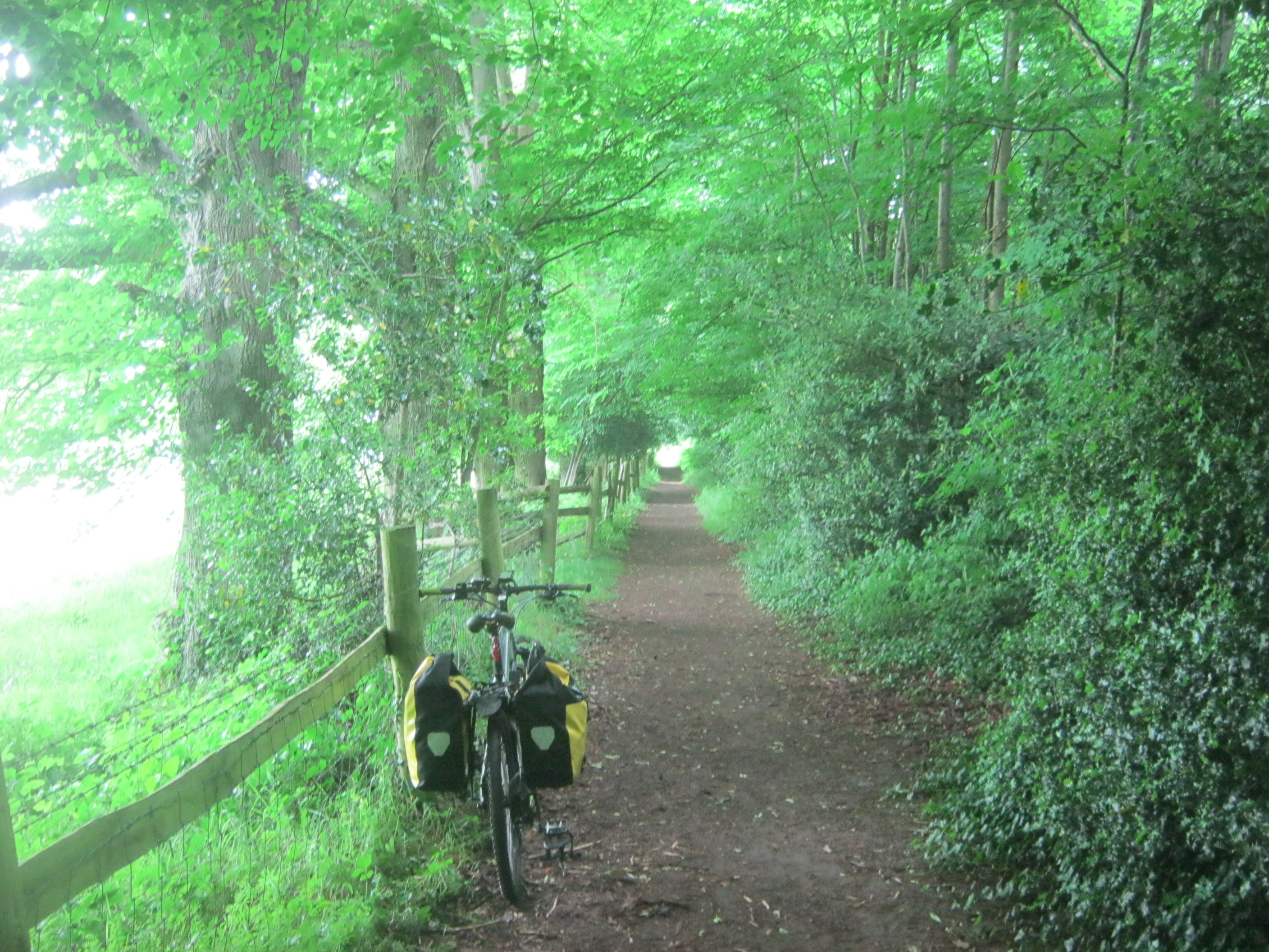

I commute to work and back on a 2015 Yamaha PW powered de restricted Haibike sDuro Hard seven mountain bike with rear rack panniers mudguards and puncture resistant tyres.
I have just completed four days with a total of 94 miles covered, averaging around 24 miles a day.
My total milage since buying the bike is now just over 9500 miles.
I needed a crank drive as my 14 mile route to work is mostly off road and in my opinion you need a crank drive for serious off road.
My ride home is 10 miles on the road where I consistently manage to achieve an average speed of 20 miles an hour. I use around 35% of my battery on the road trip home sometimes a bit more and sometimes a bit less (only 33% last night). In winter my battery consumption is more variable due to the weather and temperature and I use up to just over 40% in poor conditions (Cold/Wind/Rain).
I weigh over 100kg and carry 5KG in two panniers.
So in this glorious summer weather I am using 35% of my 400Wh three and a half year old 9500 mile battery to cover 10 miles in thirty minutes, or 140Wh for the journey or 14Wh per mile.
This would equate to using 420Wh for a 30 mile journey or 84% of a 500Wh battery, but only if you can consume the same amount of your battery per mile as I do.
If your battery consumption was higher in the winter as mine is you would be right on the limit of the range of a 500Wh battery consuming the same amount of electricity as me.
I am still using my original battery (now in fourth year of ownership) but my battery is discharged a relatively small amount on any part of my commute before I charge it up again which lithium batteries seem to like and regular deep discharges may wear a battery out much quicker.
On my 20mph average road ride home I never ride on full power but mostly in my lowest power setting eco of the three I have and use this power level for all the level slightly up slightly down sections. I do use the middle standard power setting to climb my steeper hills quicker or maintain my speed over the crest of longer hills to keep my speed up. I turn my power off for the steeper downhills.
I put in a lot of effort myself and this morning my legs are tired after my four days commuting.
This is far from an effortless commute and I take my work clothes with me in my panniers and allow half an hour when I reach work to flannel wash get changed recuperate and leave my bike locked and on charge in a room I can use before heading to pick up my schedule of work and make a cup of tea and chat to my work colleagues.
I need to shower when I get home. At the moment in the heatwave I have an intex 12 foot by 3 foot deep pool on my back patio that I jump in when I get home. Lovely.
I am still very impressed by the build quality of my Haibike which is standing up to the regular punishment I am dishing out really well. Remember that at least half of my miles are off road where the bike gets a proper pounding.
