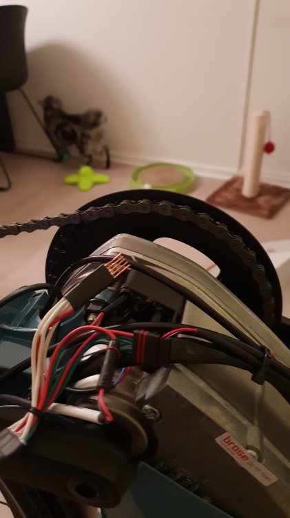

so guys, I got the tune in the mail today.
So i started follow as this pdf; http://www.peartune.com/peartune_brose_yamaha_bosch.pdf
But my motor setup dont look at this, Is it game over for me? See attachted photos.
How come there is no display cable connected?
I see 2xligts cable and one sensor cable but no display???
I mean, I have the stock display ------
Plz help...

Did you e-mail ebiketuning to find out if it fitted your bike/motor before ordering?
I did, and they send me this; see jpg file attached

i dont think anyone on the forum has a brose motor that has one of those dongles.
and ebike has the worst support ever.
Im thinking that the jpeg is the right one, becuase it looks like the motor that I have on my como,
but I dont understand the jpeg install. even the arrows dont make sense.
any ideas what they mean?
pull the 5pin and 2pin connectors from the motor
plug the 5 pin and 2 pin connectors from the dongle to the motor.a-b
then reconnect the motor cables to the 5pin and 2 pin connectors on the dongle.
well thats what it looks like to me as the dongle needs to be in between the connections.
from the looks of it you cant plug it in the wrong way round so just line the color of the cables up same as the vid.
Well that did not work.
Installed as described and when I went for a drive, the display did not show any speed. It was in zero all the time. And the battery did not kick in. Only when I turn it on. It did a push. Every time when I turned on.
Maybe they send me a wrong one?
Very strange.
does it still work with it removed as yes you could have got the wrong one as there are 4 different ones as it needs to work with the display you have like the giant bikes.
real pita tbh why i got a badass dongle.
Yeah, I have just removed, and everything is back to normal.
I also wanted the badass, but it will not work with turbo como 4.0 low entry 2019.
well it looks like you have the wrong one then as you should have power even if you have to turn on the dongle it should still work.
