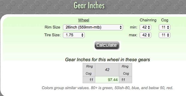

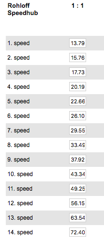

You're right of course but's relative to wheel size. I would think that Tongsheng figures are for a 26" (or similar) wheel which using 42t front and 11 rear you get 97 gear inches, same gears on my 20" wheel get 81gi. If Tongsheng are happy at 97gi then there's no reason I can't use a 50t which gets me 86gi.
Hope that makes sense.
But I use a 17t rear sprocket on a rohloff which complicates things a bit so i've referenced the calcs below and done screen shots
Here's how:
The online derailleur calculator is:
http://www.bikecalc.com/gear_inches
Put in
26" wheel
Front cog 42
rear cog . 11
results are 97gi
now go to
http://schlumpf.ch/hp/berechnungen/engl_berechnen_nabenschaltung_inch.htm
which is a calculator for hub gears
circumference 1.59 (20" x 1.75)
front 42
rear 17 (which I have fitted)
Scroll down to the Rohloff results at the bottom, Column 1:1 (ignore the other columns as they relate to other gear systems)
result is 72gi
now change the front cog to 50 and results are 86gi, well below the 97gi above
Phew! Gave me a headache too!
So you see where I'm coming from. imo it can't be stressing the motor.
26" wheel derailleur 42/11 highest gear
20" Rohloff hub gear 42/17

Apart from the Tongsheng what other drives are there that are both torque sensing and take a double chainring
Here's how:
Put in
26" wheel
Front cog 42
rear cog . 11
results are 97gi
now go to
front 42
result is 72gi

Your calculations are correct with respect to preserving the motor. With the load you are pulling I would go for a 48 or a 46 tooth big chainwheel keeping the 34 small one. At a few quid a pop you could buy a couple of different sizes and do real world tests.
