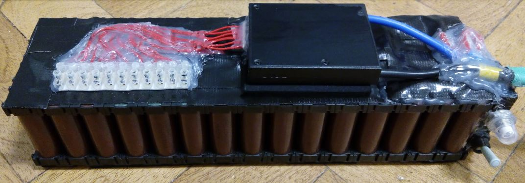

I've got this pack I've built, which I can test the individual bank voltages while in use. I plan to try charging to 41V and seeing if the banks go out of balance.
It is not for everyone as the battery can go a stray, one needs to understand the possible pitfalls should it go a bit pear shaped and have an understanding of how to notice or rectify a battery issue as they are not cheap to replace.
