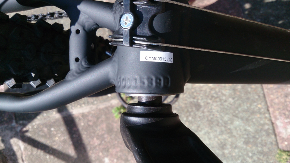

2. Another possible purchase has a thick bottom bracket cable guide, picture attached. Will I have to remove this to fit the motor? Would it be easier to pick a bike with in-frame routed cables? Should I look for a smooth bottom bracket base to avoid grinding the frame?

I suspect you might have a problem with the motor and the chain stay distance
The motor could be spaced out up to 73mm but that makes for bigger problems with the chain line
I have converted a voodoo 1x11 that started with a single 32 on the front and a kona with a 1x10 with a 34 both with TSDZ2 but they both with minor clearance problems
But a bike with triple front will have more space
The gear cable is an easy fix, just remove the the braket and replace the cable outer
Remember the fixing for rear anti turn bracket on the back of the motor

Yes. Modern MTBs tend to have wider tyres, so the chainstays are spaced further apart. They also have low gearing, so they use small chainwheels that can keep clear of the chainstays. If you want to use the bike for proper off-road stuff, you have to choose carefully. If you want to ride the bike mainly on the road, you'd be much better off with an older MTB or a hybrid type bike that has narrower tyres. Remember, when you have electrical assistance, you don't need all those fancy gears and things unless you're doing serious off-road biking.
If you have one of those chain-guides under the BB, you can remove it and run the cables in an outer cable. That way, you can route the cables wherever you want. If necessary, you can use the outer all the way from the shifter to the derailleur, or you can just use a short outer between the end-stops either side of the motor.

Try and find a bike with a triple front chain wheels, most voodoos will convert with the 73mm bottom bracket, the newer 11/12 speeds with the 32 front chain wheel are a concern
spacers can cause more problems than they solve
