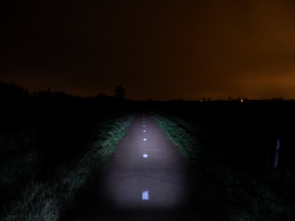

Philips Saferide 60 beam shot (the Spanninga Axendo is a direct copy of it, as they bought the design off Philips when Philips stopped making bike lights, and bear in mind that mine is the 80 Lux ebike version so a tad brighter still): Philips_SRLD_weg3_0_75m.thumb.jpg.ab665198159388e0def3cd2c252bdf89.jpg
From this website: https://swhs.home.xs4all.nl/fiets/tests/verlichting/index_en.html Hardly useless IMO

Philips Saferide 60 beam shot (the Spanninga Axendo is a direct copy of it, as they bought the design off Philips when Philips stopped making bike lights, and bear in mind that mine is the 80 Lux ebike version so a tad brighter still): [ATTACH=full]32843[/ATTACH]

It's still 7w extra input for 2W lights! That's 7% extra pedal power that I'd have to add on a normal ride, compared with zero extra effort for non-dynamo lights. As I said, you can't change physics. Stick to your religion. I'm happy with being an athiest.
