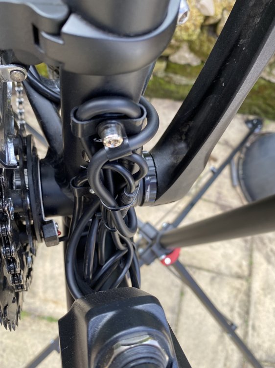

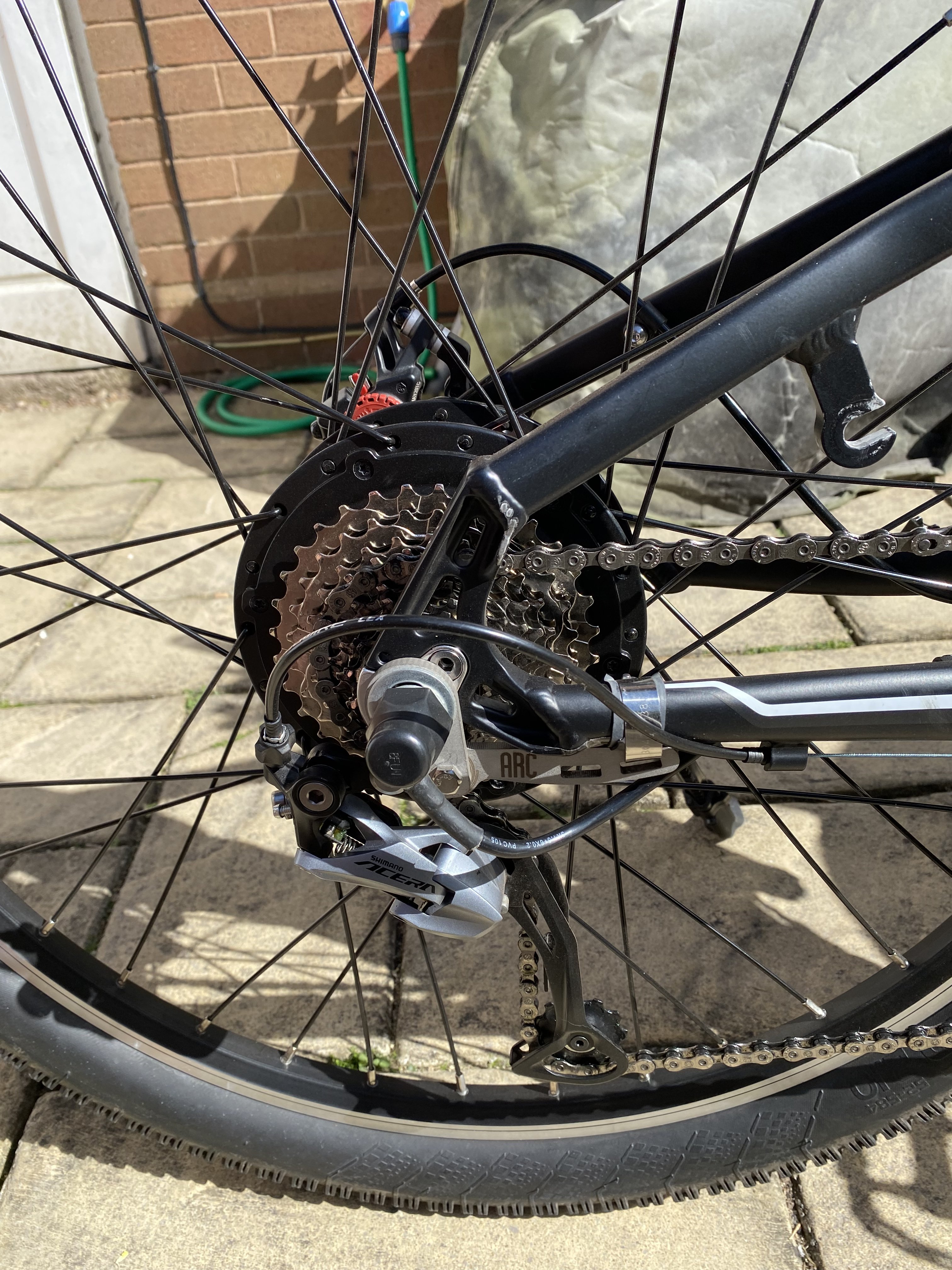

So here it is the completed conversion using a Dillinger Off Road Kit. No throttle just PAS so that it can pass as road legal . The PAS is mounted on the RHS on small chain ring, magnets will hold it but there is a dab of epoxy to keep it in place. A bit of dremmel modification of the mag ring needed to endure no interference. Brake sensors are epoxied to existing levers.D9A9B2F8-DB81-4045-BBF1-91B622BBF41F.thumb.jpeg.480caa5196a1b1cbcaa77706739a9bb2.jpeg98B36A1D-5CF4-4F6D-A487-34DA8285B617.thumb.jpeg.7cb64b046d0989e76d26f792509adc86.jpeg0B3008C5-64C6-4FAB-BE4C-768F4409BC1A.thumb.jpeg.803f0b74b6d8fa7cca84136e55dff1ca.jpeg30E806F1-1BAD-4B89-ADE3-40D346057FB4.thumb.jpeg.d613ecdb3db9bdcdec6cb553a34b5ae0.jpeg1D4189A0-4E36-4415-BAA9-080034806E8C.thumb.jpeg.433d421a605c8f58fd51fff7513c3782.jpegC4E481FA-751A-42D8-B46D-5F01F1C0DC68.thumb.jpeg.63e0084815a159a9bf3b6047b8001bf8.jpeg
The battery cradle is modified so it can be easily released from the bottle cage mounts to allow the bike to fold without fouling the integrated controller .
