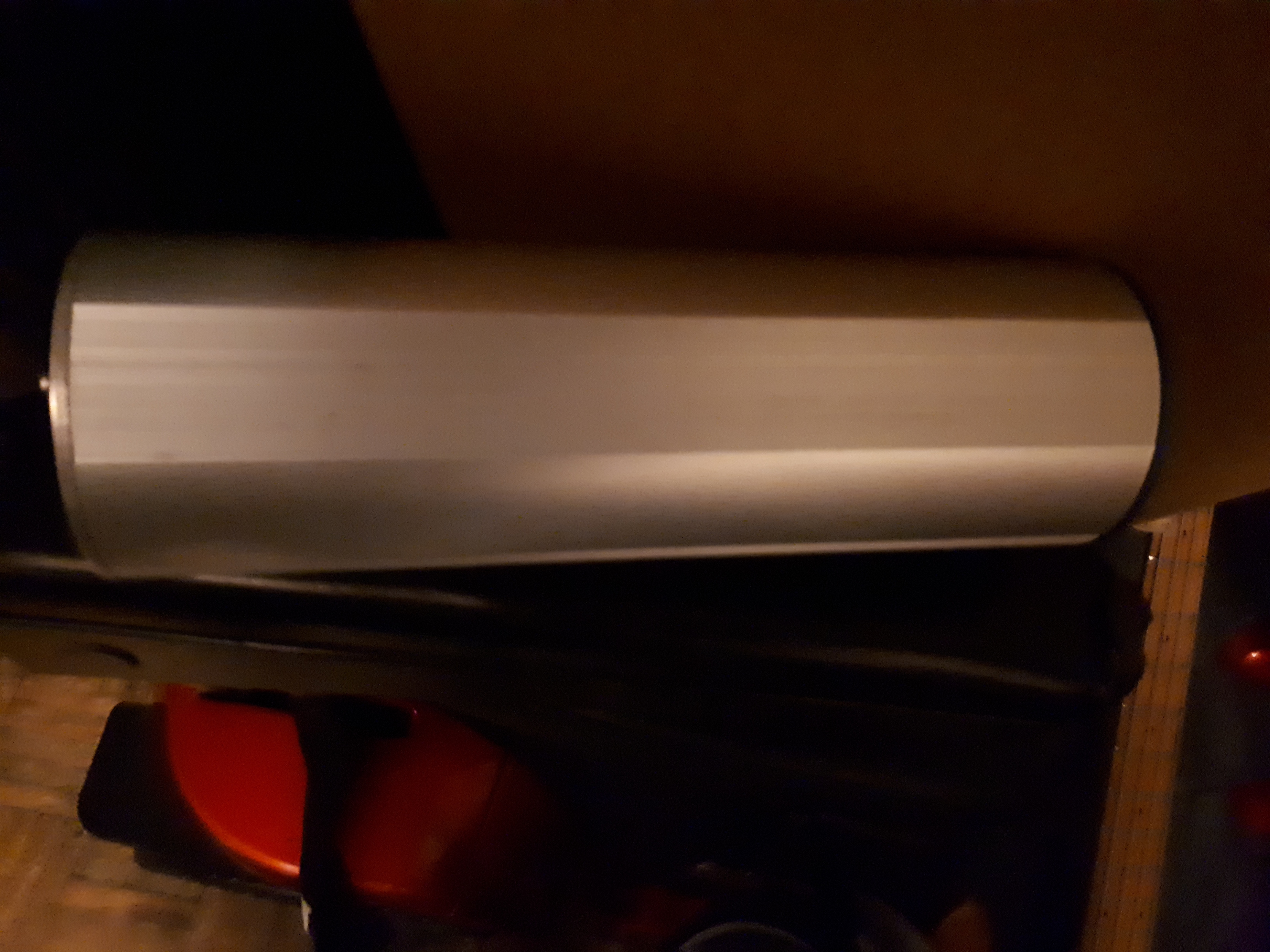

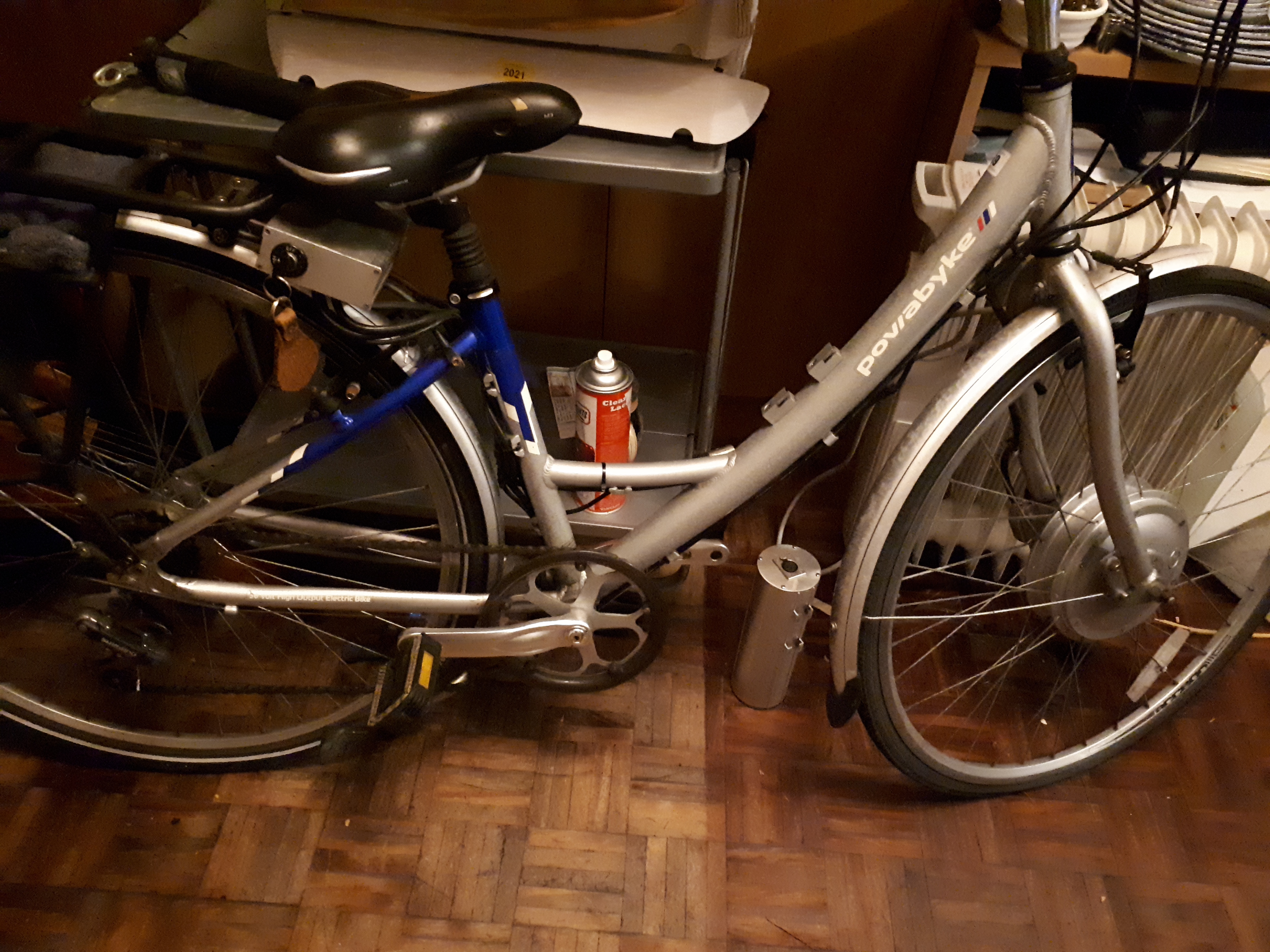

Hi this is the bike and the battery container - the bike has been sat in the garage for over 2 years and is not working at all. I presume it is the battery but not sure

The battery innards look quite accessible and in pic 1 of the bike, the battery end plate is simply screwed on so access to remove the cell pack for testing looks very possible.
