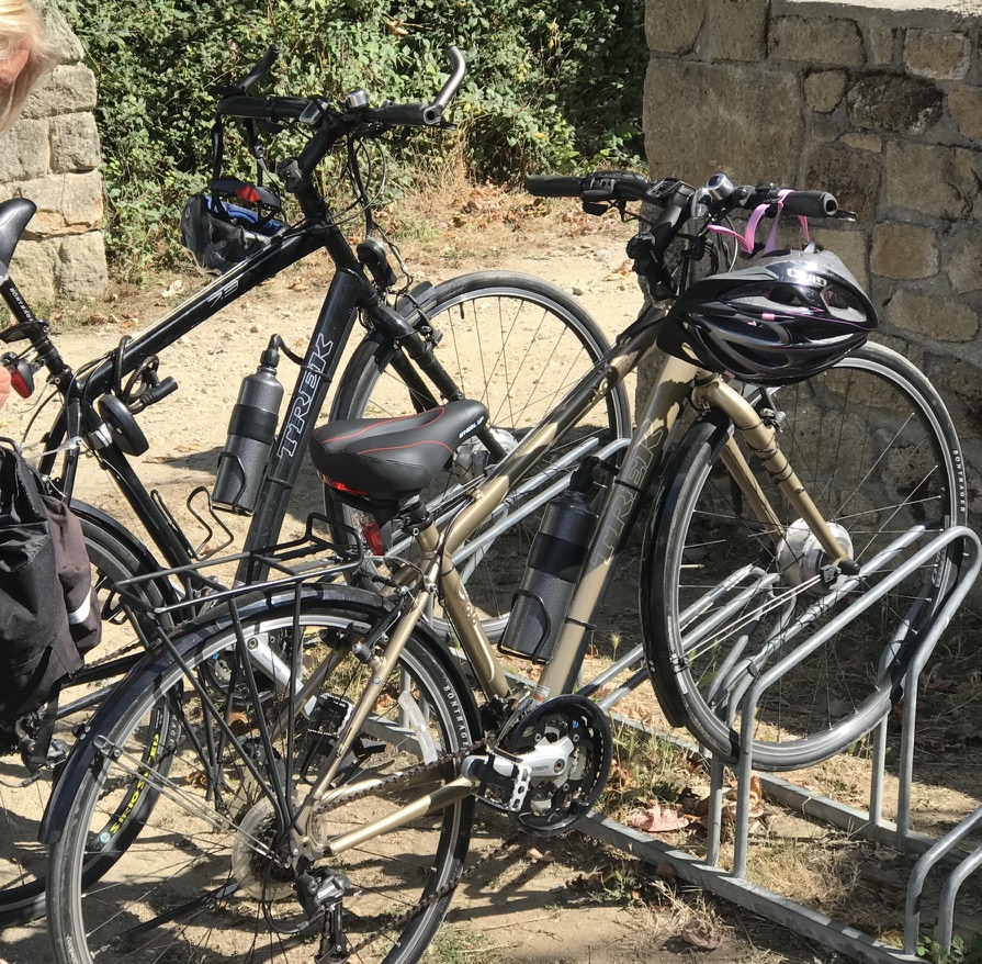

Not sure if this is any help. Any specific parts to photograph?
Just realised that there is a difference in the frame shape too. :rolleyes:

Both bikes look like they use a lithium battery of some type lion or lipo, if that is the case all you need to do is buy new battery's or have your old ones re-celled (if it is possible )so that they will use the same mount and no need to make any other changes.
Both bikes are easy to convert - aluminium frame, plenty of space inside the triangle for a standard downtube battery (36cm x 10cm).
