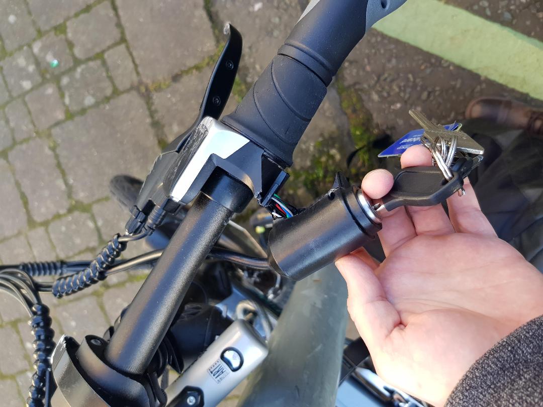

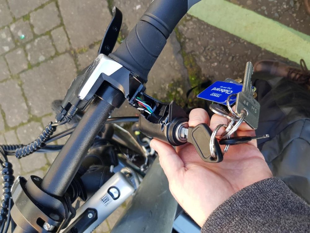

Had a car pull out in front of me last week and the bike is luckily not in bad shape, only thing that really damaged was the ignition. It turns on and everything works, horn, light, display, but the handle/acceleration is a no go, looking at the state of the wires I can see why. How do I wire this all up?!

Pictures please? Clear ones and good close ups!
Pictures would help wouldn't they... Stuck them in op
Is that all we have to go on ?
How about amore expanded view of the handle bar set up.
At a glance of the pics we can see;
If there are only two wire contacts the Red will go to the Brown as one is live supply and one switched supply. The black will be GND/- so will go to Yellow as this will be like wise. The White unsure see if it has any voltage with a meter between GND.

Sorry, I'm at work at the moment and these are the only pictures I have.
