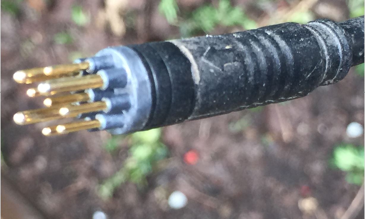

Hello, a couple of years ago I fitted a Street Legal Electric Bike Kit - Samsung Power 2.0, unfortunately the battery has corroded inside and a replacement is £350. I would like to understand if it is possible to reuse the following front hub motor:
Motor Brand Shengyi OEM for Dillenger
Motor Model DGW07
Motor Voltage 36V
Max Motor Power 250W
Drive Type Geared hub drive
Motor Sensors Hall sensor
Attached is an image of the male connection from the motor Dillenger calls this EB-BUS wiring.
Ideally I would keep the controller and wiring and just replace the cable and battery.
