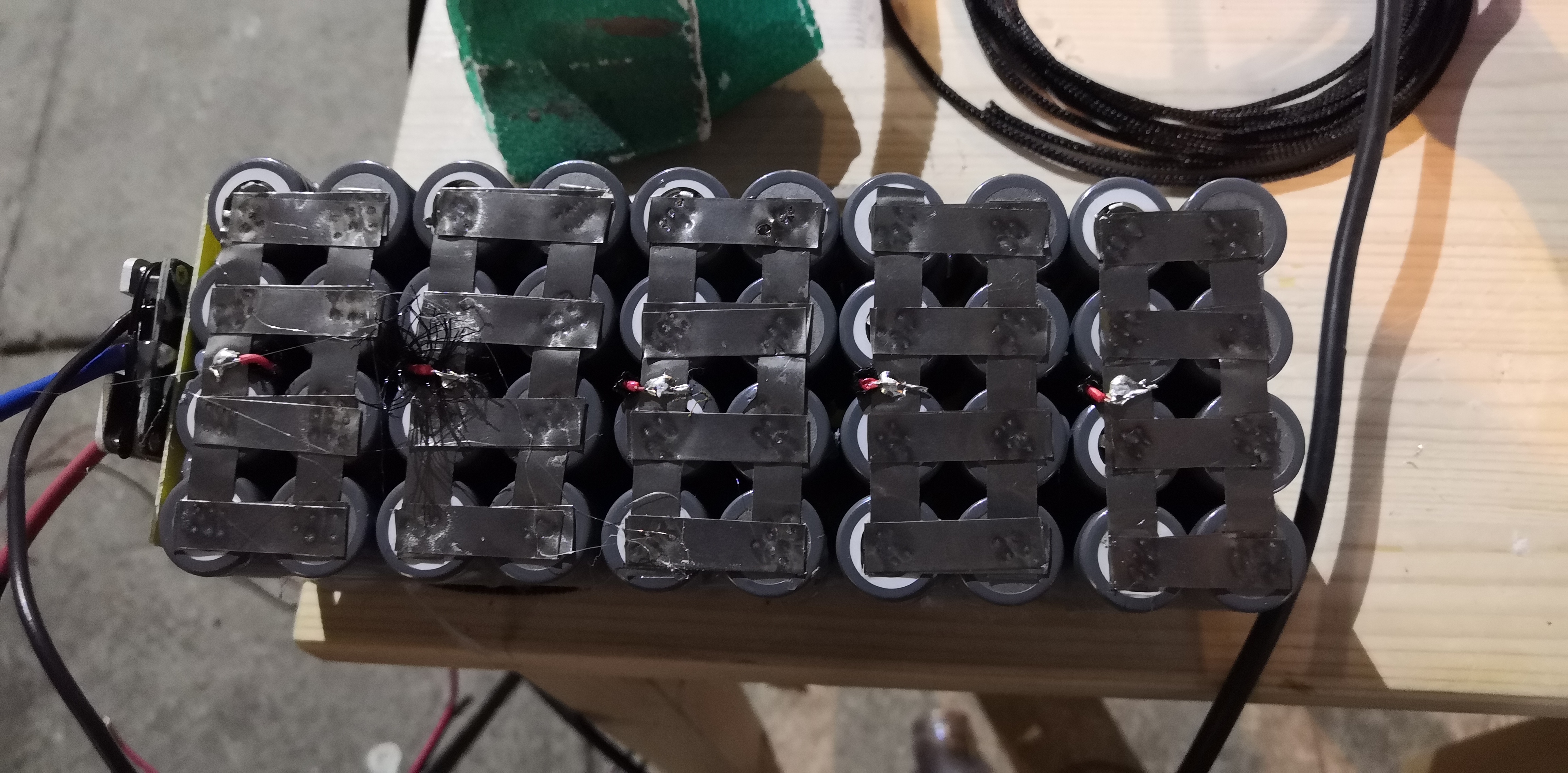

How do you plan on connecting parallel and series connections and what material for the buss bar/interconnectors.
The P ones don't have to carry much current but the S ones do so you need interconnector material ideally that can take the whole 10a current load of each cell, some might divide the max controller current of 23a divide by four and use a buss/interconnect just to cover this, but if a cell fails or becomes weak the other busses then will be over worked for the current load.
Pure nickel 1mm2 is capable of 4.459a current load/ampacity optimally and 6.619a is max acceptable.
Copper is approx. 4 x more capable and 1mm2 16a optimally.
I've ordered some 0.2mm 8mm nickel strip and was going to double up the series connections.

I would recommend buying the spacers as they give strength to the pack and reduce the likelihood of strips/balance wires breaking or shorting. They also help cooling.
I would also make up a dummy load and do a full charge and then discharge to 30 volt on battery, observing the group voltages, which should remain in balance to 0.01 v for new cells. If you measure the current and/or load resistance, you can also estimate the actual working ah capacity doing this, which should be a bit better than 90% of the nominal capacity.
Edited by Sturmey
Roughly how much do these spacers increase the pack size. I want to keep the pack inside the existing battery holder and I'm already going from a 3p pack to a 4p pack which there is space for inside the holder if I remove some of the foam packers that are around the existing pack. I've seen 2 types of spacers, some are lock together squares and other types are offset cylinders. The square type look a little bulky.
I will do a load test once built, hopefully the cells will be OK, I've bought them from a UK wholesale supplier I didn't fancy risking it with ebay cells
I used the square type that lock together. I think they add an extra 1mm all around. 10X 4 rows of 18650 would normally be 180 X 72mm, but with spacers would be 200 X 80. plus a little extra on the height.
I suppose the main thing is that the battery is mechanically robust, however way you achieve that.

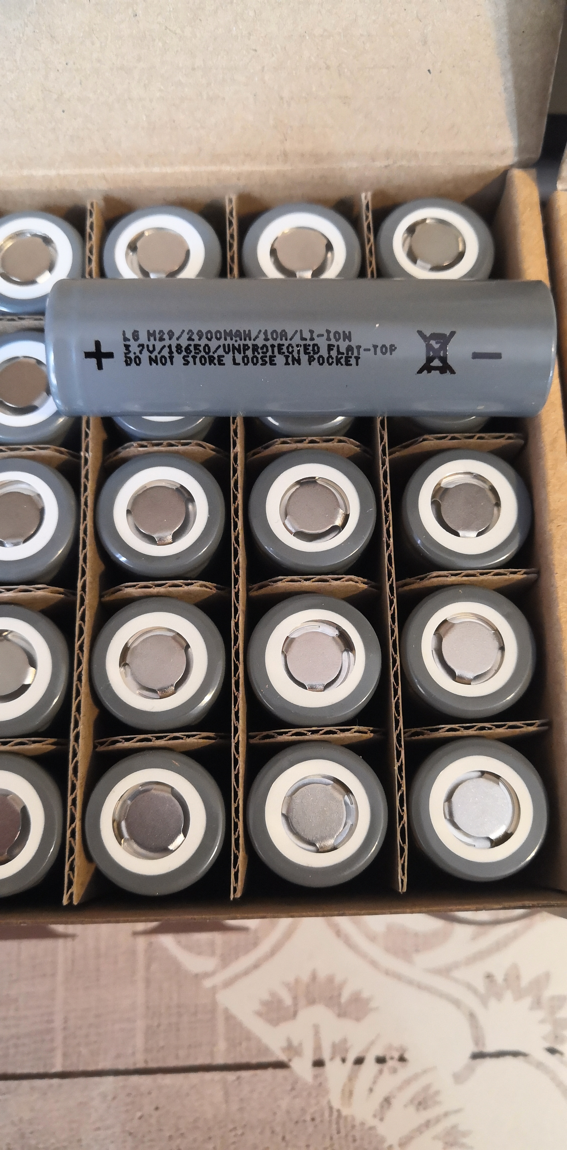

Well I received my cells this morning, 24hr uk delivery so really good. I've tested all 42 I bought and they are all sat at 3.6v exactly. Before I start building the pack I'm going to fully charge them individually. I've just got to wait for my nickel strip
...... Before I start building the pack I'm going to fully charge them individually.

Build the pack with the cells at the factory voltage they arrived at.
Which vendor did you use, Fogstar ?
Yes fogstar
Ive already started charging, should a discharge the 8 I've done so far back to 3.6?
I think you should and within 0.01 volts. This can be a tedious job as after discharge to 3.6v, the battery volts may rise a little after a period of time (to perhaps 3.63v) and you will need to discharge slightly again and recheck again after a few hours.
But again, it is necessary as the battery needs to be kept balanced and it would be dangerous to assemble a battery with fully charged cells.
OK I've sorted the cells out now and they are all equal.

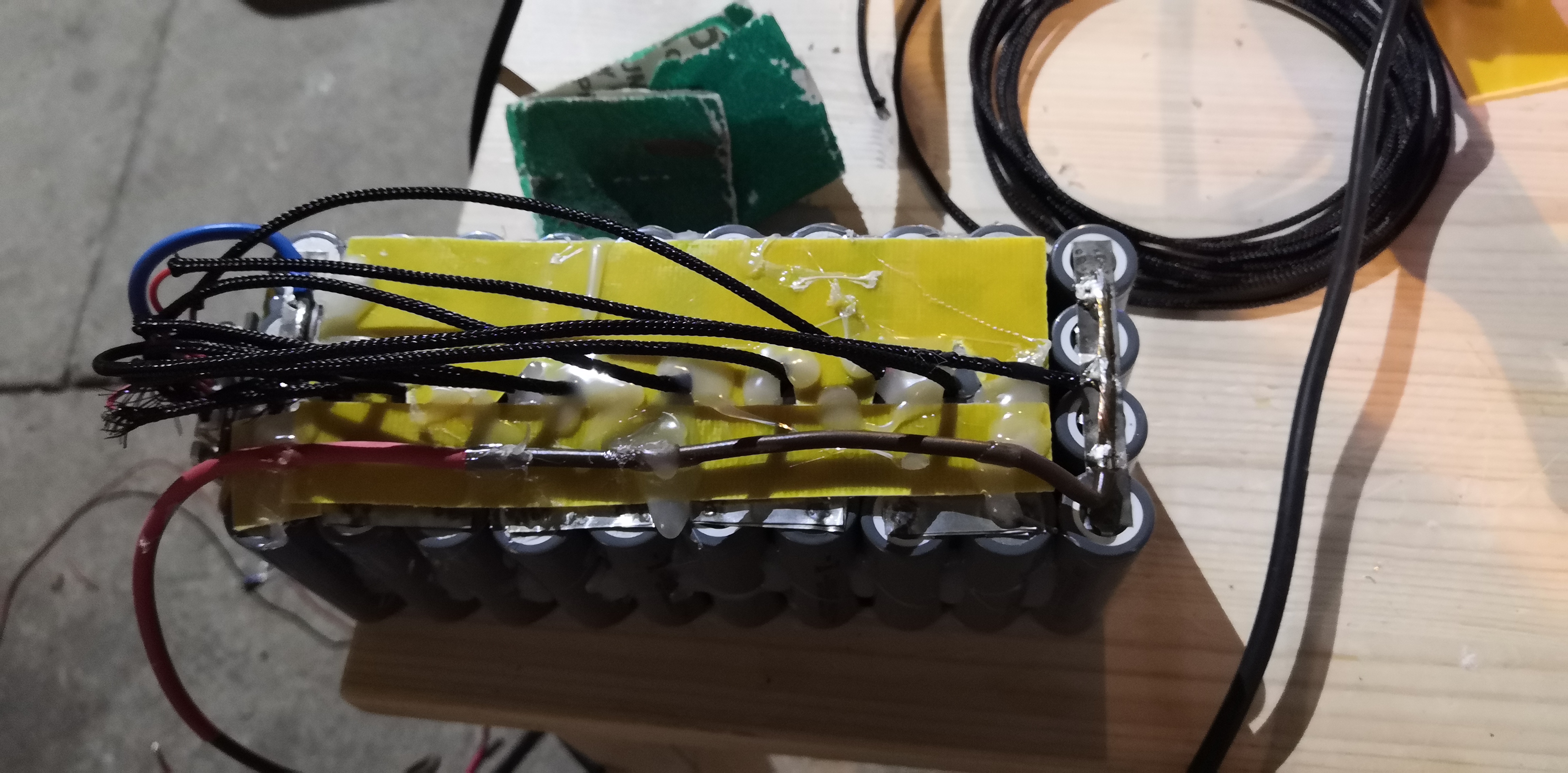

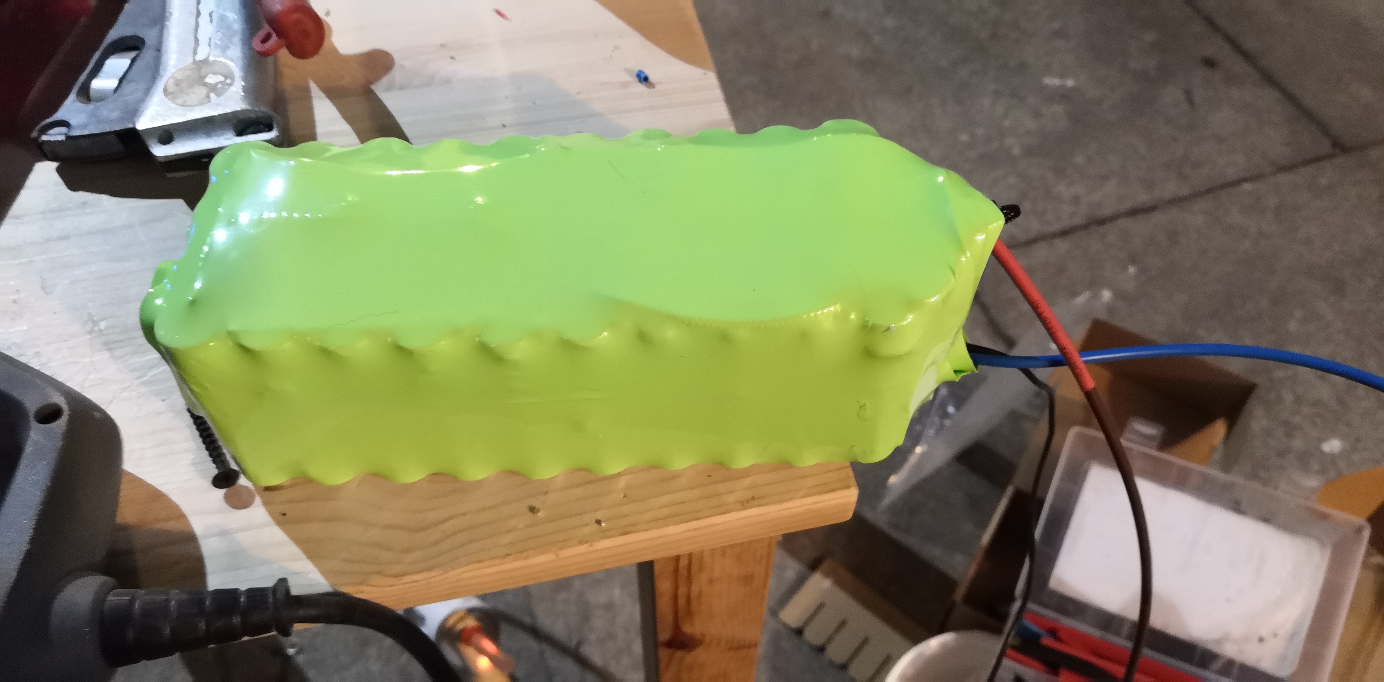

Well I got tired of waiting for the cell holders to be delivered and went ahead last night with glue and heat shrink.
Started at 10pm and finished around 5am
Did have a few brews though and also wasted time having to find a wiring diagram for my bms. Also had to wait for the bodged up spot welder I had made to cool down quite frequently.
I found it to be a easy job that just needs you to concentrate and be methodical.
Most annoying part was the cutting of the 72 series connection nickal strips.
Total cost ended up at under £130 for a 36v 11.6ah pack.
Missus didn't want to wait for a load test she told me to get it in the bike and she would test it.
Anyway after a full charge she went out for a quick 6 mile ride on the return the pack was sitting a 4.07 volts.
She is very happy with it. She says it has loads more power so we will just have to see how it goes now. Thanks for the help
