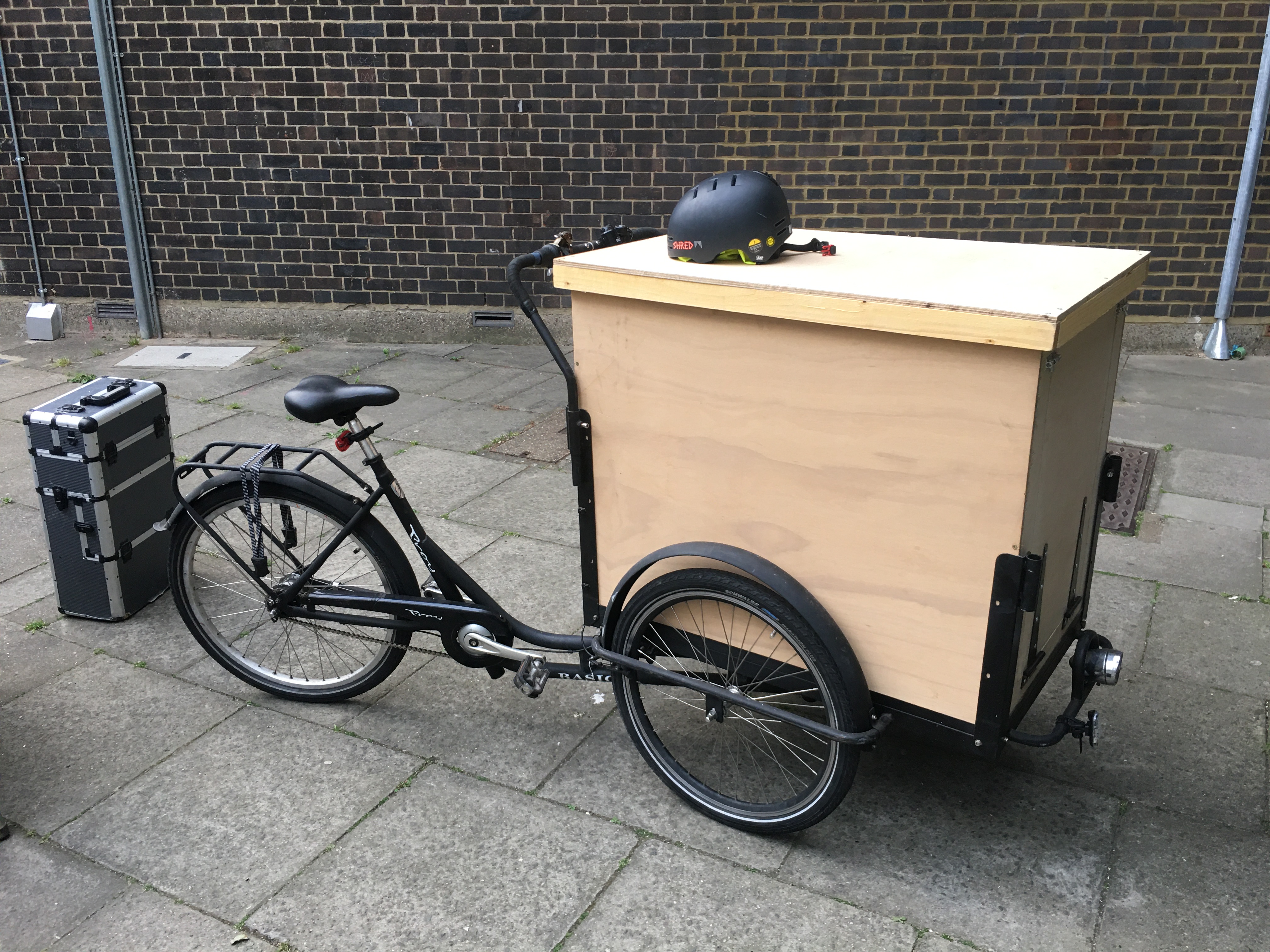

I have converted the box on the front to make it lockable and able to fit my toolboxes. I've been riding it for a few weeks now and it feels very comfortable when laden although sketchy on corners and pot holes due to the 3 wheels. However, I'm exhausted by the time I get to jobs and desperately need the assistance of a motor to get up the hills and deal with the stop-start at traffic lights or as pedestrians, eyes glued to phones, randomly step out in front of me. Grrr

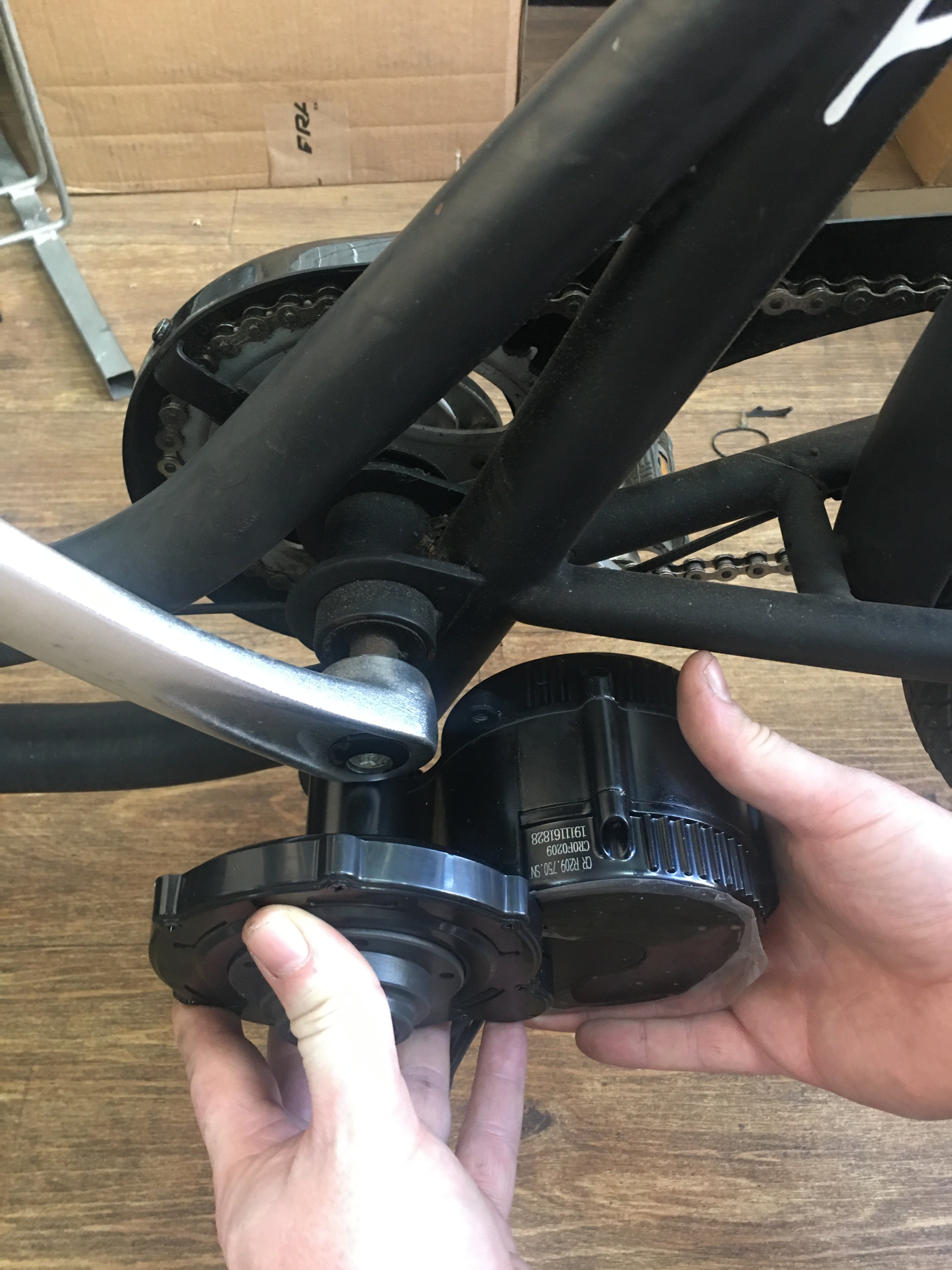

So, due to the brake problem, my local bike shop recommended that I try a mid-mount motor. This sounded perfect from my research until I ordered one and it would not fit.
Bakfiets make two versions of the Troy trike, one is mid mount electric and the other, like mine, is standard human powered. I realise today that the two frames are different, in order for there to be space for the mid mount motor.

It was a Bafang 250W motor that wouldn’t fit around the bottom bracket. It was supplied by Tony at Woosh and I am in communication with him. He recommended that I come here!
