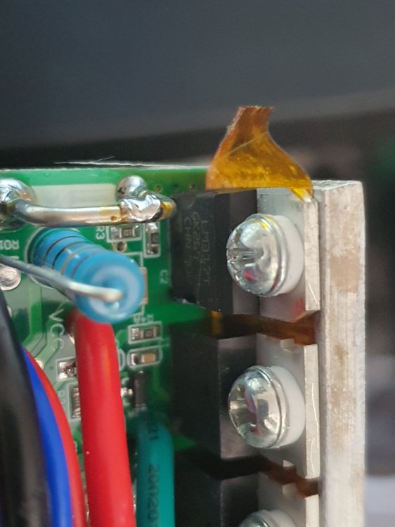

Hiya, okay I managed to get hold of a multimeter and performed the tests you said, here are my results.
Measuring between the black battery wire and each of the blue, yellow and green main motor wires I get the same reading of 8.64 on all 3 phase wires
Measuring between the red battery wire and each of the three motor wires I get nothing on any of the phase wires ???

Okay so on 200k scale, slightly different results
Measuring between the black battery wire and each of the blue, yellow and green main motor wires I get the same reading of 9.4 on all 3 phase wires
Measuring between the red battery wire and each of the three motor wires I now get very high readings starting at 90 and then climbs incrementally higher on all 3 phase wires.
Doing the same test 10 mins later I get the same on black but now back to 1 on red across all 3 phases? I have repeated this several times and only getting a 1.
Does this indicate normal behavior and controller is healthy?

Yes, sure here they are. The 9.8 reading is on all the 3 phase wires on the black battery terminal. The other reading is on the Red terminal of the battery, repeating again 2 min later gives a 1 now constant.

The reason is that there's a large capacitor across the battery wire that either you're charging with your meter or it's powering the probe to give a false measurement. Three things you can try:
1. Short the two battery wires to discharge the capacitor before you start.
2. Measure with the battery connected to the battery wires.
3. Reverse the probes when measuring in each of the above.
One of those 4 measurements should give you correct readings.
