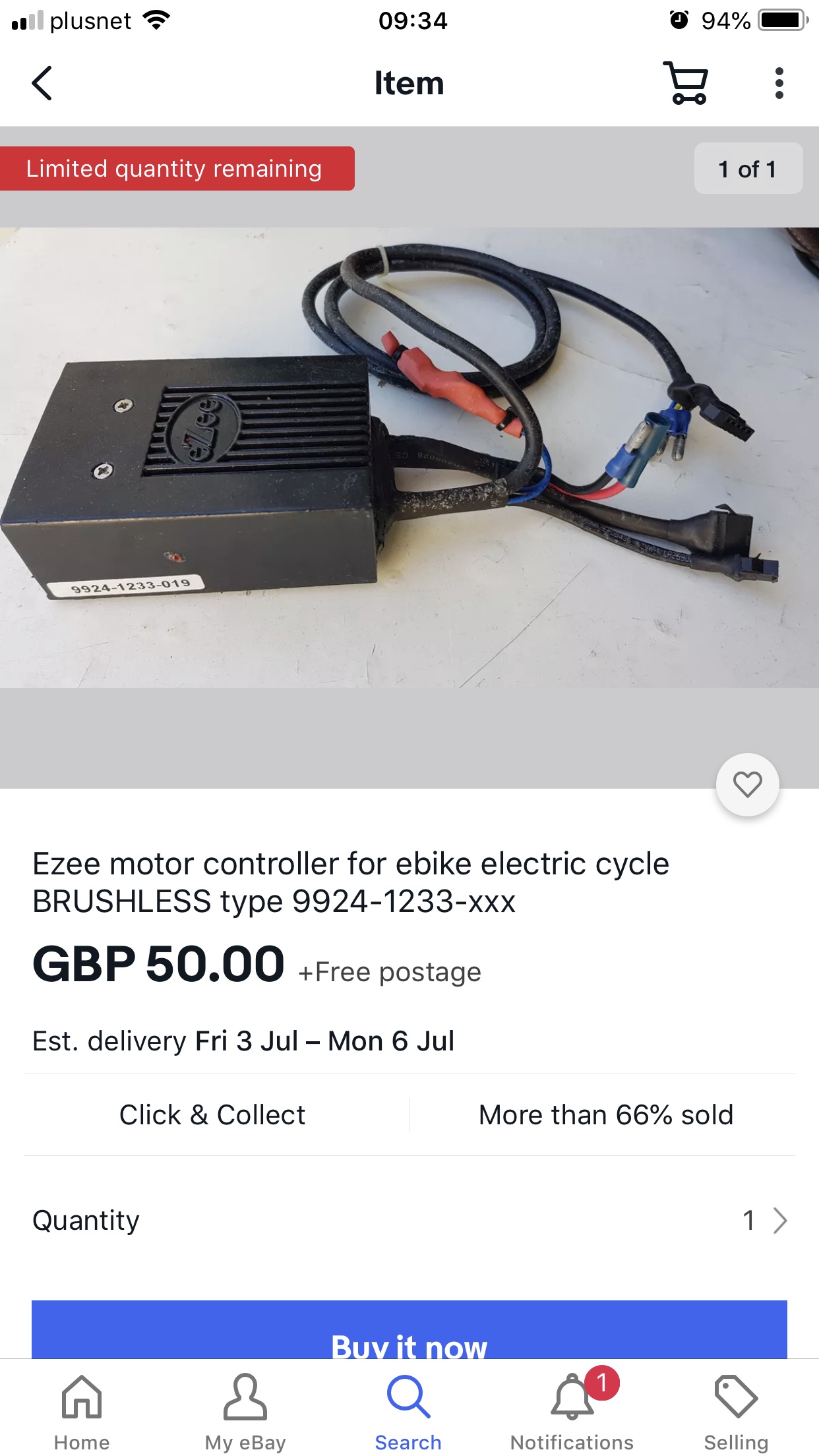

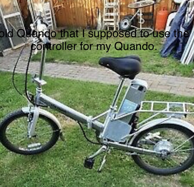

June 22, 20205 yr Hello, I got a strange error on my Ezee Quando. My Quando is on running but I decided to switch the battery with my wife Quando also ebike to ride further. Immediately my bike can not run while her battery still full. Reading number of flashing in controller, I counted 7, it means high voltage battery. Very surprise since battery runs normally in my wife's EZee Quando bike. Went home and checked all batteries voltage, it showed around 40- 42v. Got the battery full charge over night with an expectation that the controller will stabilise over night. However, it still got 7 flashes error. Can any body advise me how to fix this error.? If I buy an old Quando ebike (as shown in photo) to use its controller. Will it work for my Quando ebike. My bike is not the first Quando as shown in photo, not Quando II but quite old, around 12 years ago. Many thanks, Hung.

June 23, 20205 yr Author I have another charger but I am afraid the trouble is not from the voltage as notice ld by the controller. I tried 37.2v, 40v and 42v voltage battery formg bike. But it still shows 7 flashes errir( high voltage error). I now think abot replacing the controller. Ebay seller get one for £50 but I am mot sure it works for my bike or not since my controller's serial number damaged. Do you think a controller from old Quando version can work on my bike as shown in photos. Thanks.

June 23, 20205 yr The controllers were always one type on the earlier Bafang motored Quandos lik yours, so are interchangeable. However another one might not cure the problem. .
June 23, 20205 yr Author The controllers were always one type on the earlier Bafang motored Quandos lik yours, so are interchangeable. However another one might not cure the problem. . Hi Flecc, what did you mean that "another one might not cure the problem." Do you think the controller on the older version of my Quando can wirk on my Quando. Thanks.
June 23, 20205 yr Author After careful thought, the only logical cause I can think of is that the voltage is noisy on the faulty battery. You'd have to put it on an oscilloscope to confirm that. My memory is bad these days, but I've got a feeling that I've seen ferrite cores on some bikes, possibily Ezee, to smooth out the supply. I thought that they were to cut down emissions, but maybe they use them to stabilise the voltage for functional reasons. You could try one of these. Wrap one of the battery wires (positive red wire) through the centre and looped around and back through it to see if it helps. https://uk.farnell.com/multicomp/33ri-20x10x10/ferrite-core-cylindrical-120-ohm/dp/9640398 Another thing to try is a big capacitor fitted directly across the battery supply. Any large capacitor with a rating of 50v or more would do. The controllers already have such capacitors in them, but maybe one is compromised in some way, so it can't filter properly. Thank you for your advice but it is quite complicated for me to carry out.
June 23, 20205 yr Hi Flecc, what did you mean that "another one might not cure the problem." Do you think the controller on the older version of my Quando can wirk on my Quando. Thanks. Your twelve year old is the same as older ones back to 1994, so that other controller should work. But I can't guarantee that it will work on both batteries since we still don't know what the fault is. It could be something about the management system in your wife's battery that is clashing with some of the controllers. .
June 23, 20205 yr Author Hello, I open my controller ans see no burn inside as shown. The serial found is 9928-798-043. Can you advise me a replacement for this controller, please?
June 23, 20205 yr Author Your twelve year old is the same as older ones back to 1994, so that other controller should work. But I can't guarantee that it will work on both batteries since we still don't know what the fault is. It could be something about the management system in your wife's battery that is clashing with some of the controllers. . I agreed with you. But i sometimes used her battery when my battery run out. That is why we use only one charger since we can share battery each other. I check Ebay seller, they said their controller is only compatible with one has the same first 8 digits. Mine is different so can not buy. Should I contact direct Exee to ask for a replacement? or any source in Uk can help. The serial number found in my controller is 9928-798-043 whilethe Ebay selker requires 9824-1233-xxx. Thanks.
June 23, 20205 yr Hello, I open my controller ans see no burn inside as shown. The serial found is 9928-798-043. Can you advise me a replacement for this controller, please? I don't know anything about the serial numbers on these, I only ever knew of one controller being issued as a replacement. You could check with Ezee agents Greentech e-bikes on this link If they don't have an answer they can check with Ezee Kinetics. Or you could use this contact page direct to Ezee. . Edited June 23, 20205 yr by flecc
