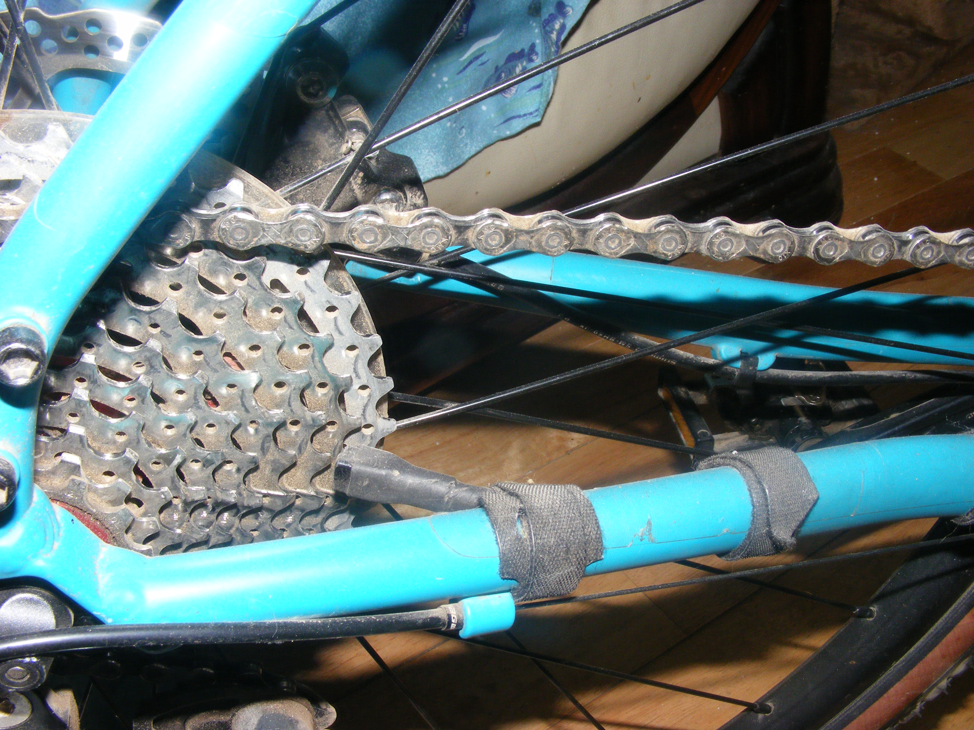

My Revos uses a crank stay cadence type sensor, the led (green) picks up a rotation signal from the largest cassette sprocket (no magnets used). It measures the gap/speed of the teeth, I had teething issues with my one as the sensor kept slipping on the inside of the rear stay so drive was interrupted.
The new one has been redesigned a little following feed back after use.
For my one I have used heli tape on the inner stay and then used some epoxy and more velcro ties to keep it in the required position.

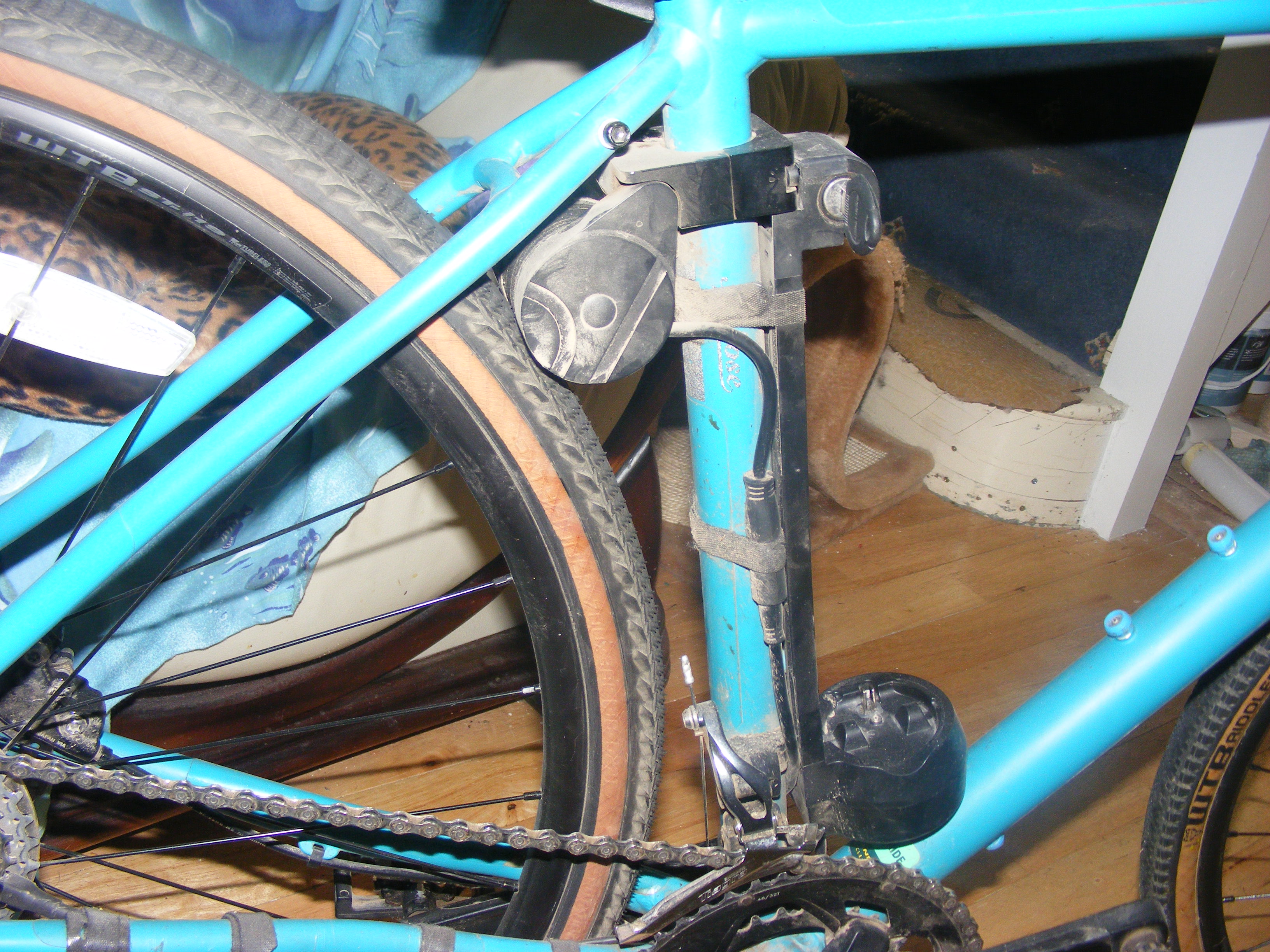

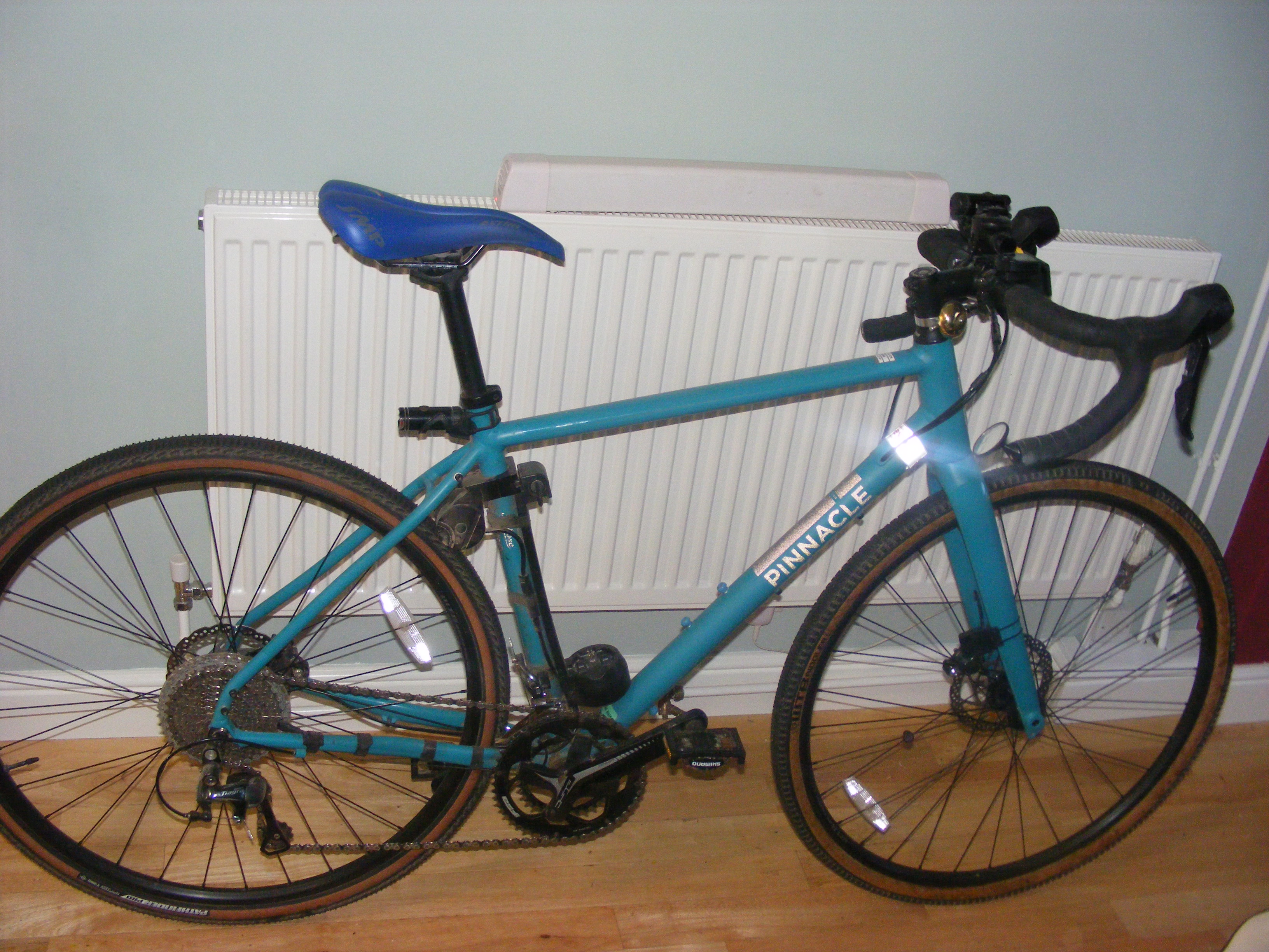

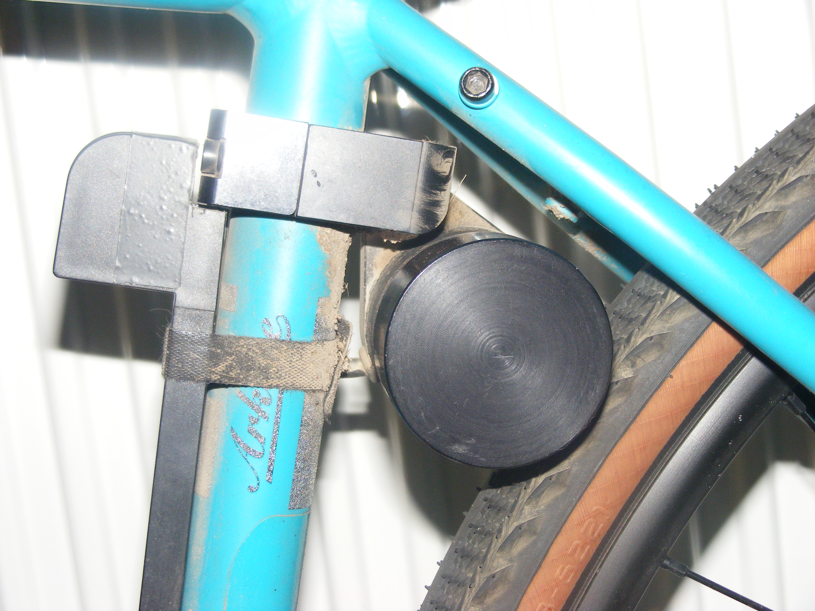

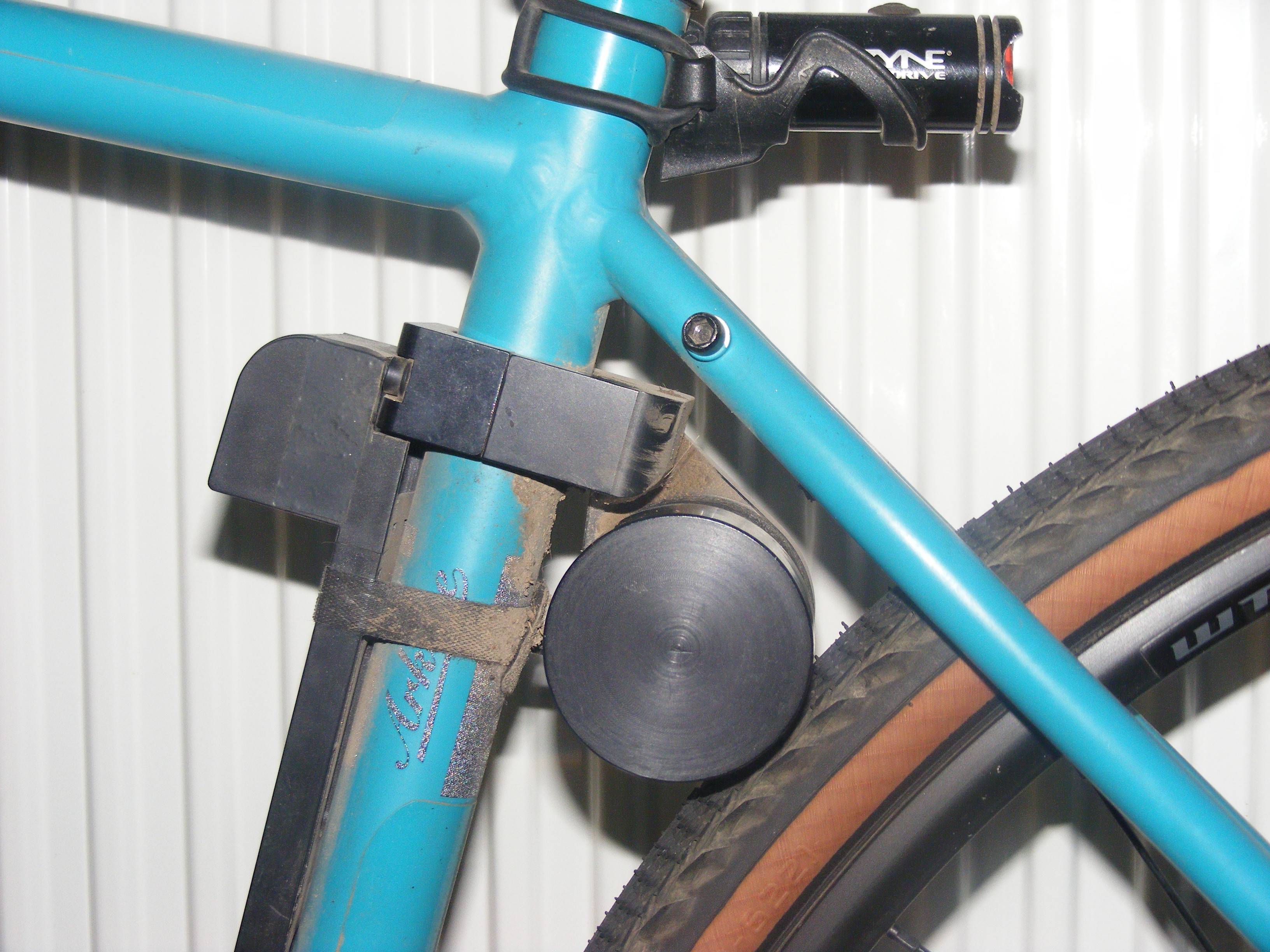

Yes.
The bike pic in the link looks ideal, though the mudguard will need cutting.
Pics below show the drive mounted behind seat post, the rear stay sensor and two of the bike. One when used locally to work & back and the second for a days riding out.
