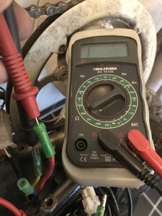

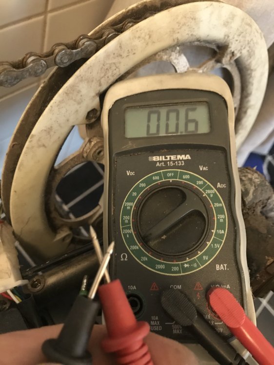

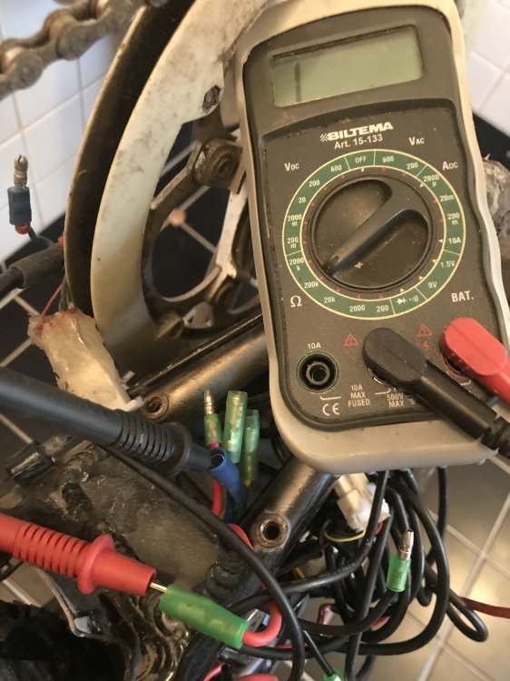

Since you ask, I repeated the measurements today. Below are photos of the measurements of the three phase wires against the positive going into the controller.
As you can see the multimeter I set 2000k and returns a value of 1 on each of the phase wires. Same result I reported after my previous measurement.
please let me know if I am doing sometime g wrong.

You should be using the 200k scale, which is one click anti-clockwise.
To check the valididy of your meter readings, tell us what the reading is with the probes in the air, then with them touching.
