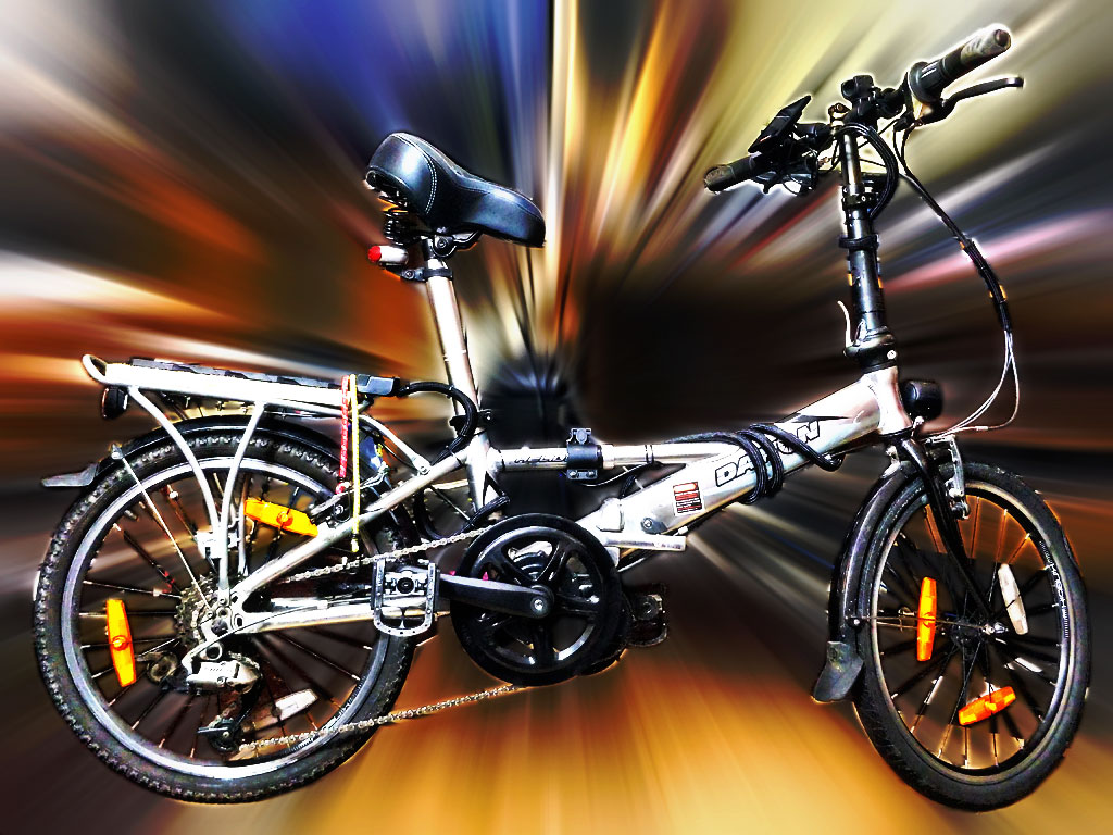

The new 1T4 loom is shorter, which will fit my small folding bike better anway - will be fewer loops than this lol:
...but regrettably, less Borg-like.
