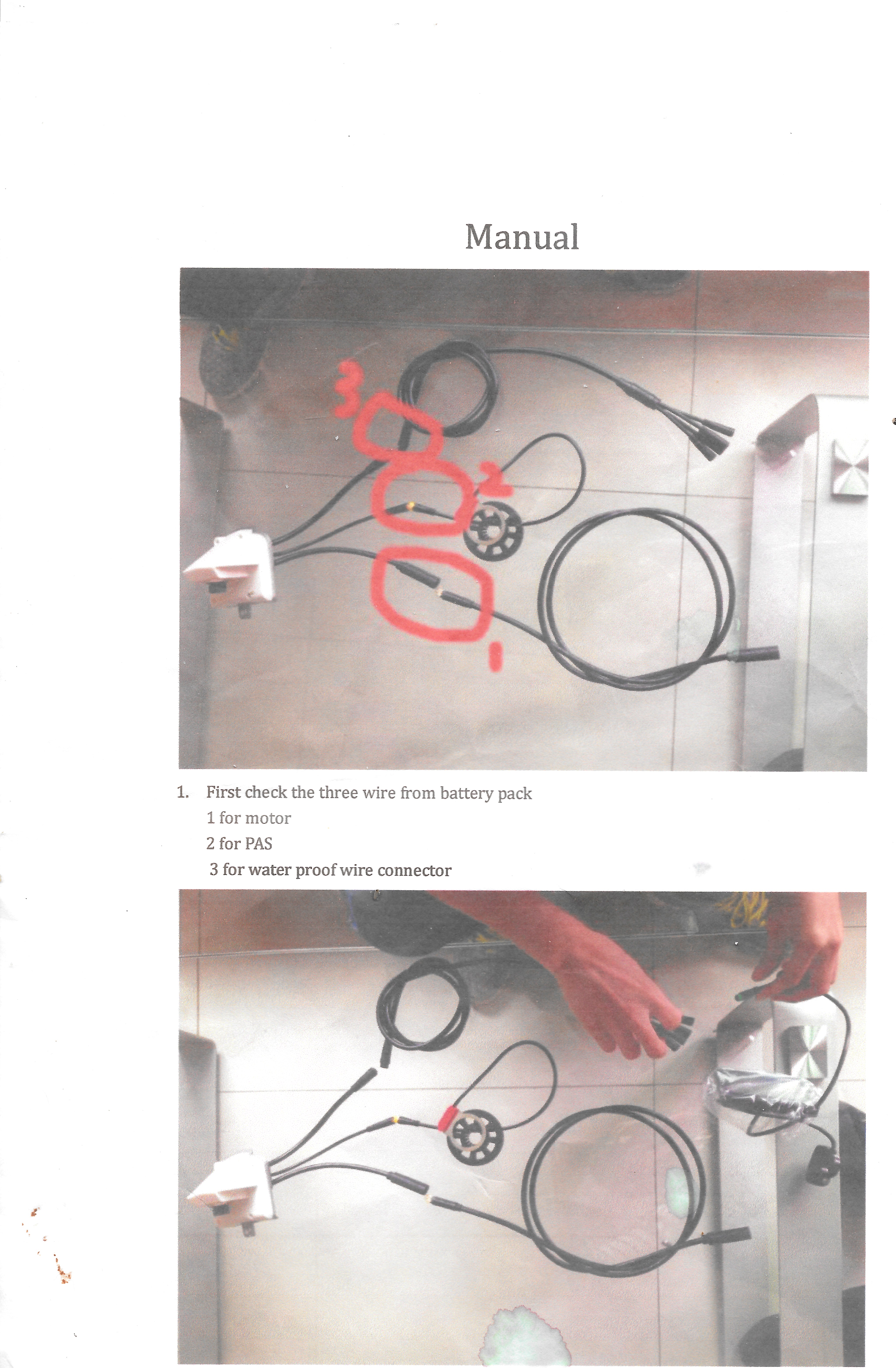

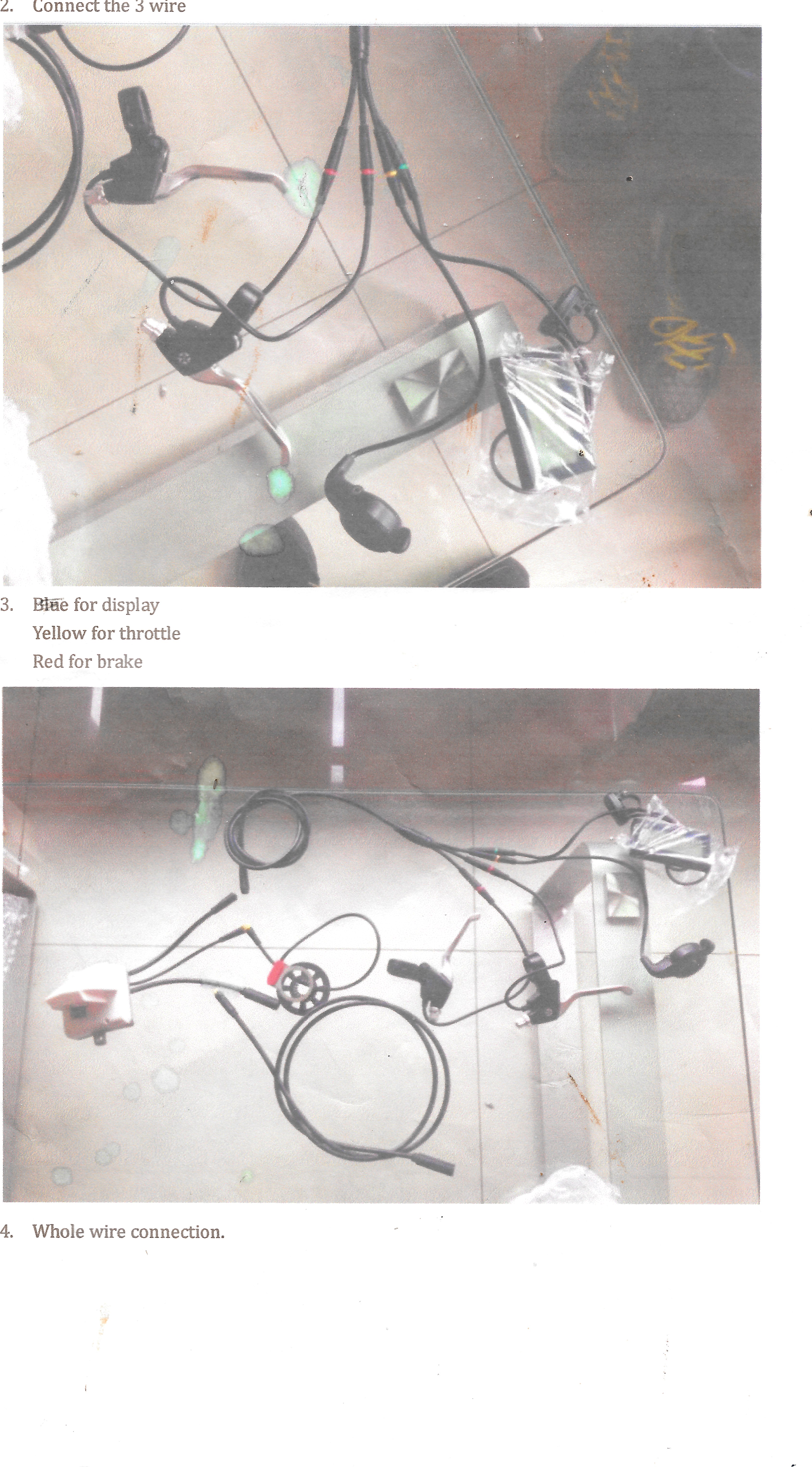

Thanks for sticking with it. I have no Speed Sensor that I know of. It came with a PAS but as I remember I could not fit it as It needed the removal of a Pedal Crank & I did not have the Tools so I took it to Halfords. They later told me the PAS was not working. So there is no PAS. To get the Speed to show the Throttle must be active for 10/15 seconds. It's not making the Speed up as it feels about right. I have had a problem since I installed it. Sometimes(Seldom) it would cut out but I would let the Throttle go and then activate it again and all was normal. The wiring hasn't been touched until yesterday.
Have spent time looking at these LCD3s, but cannot see any way to check the Voltage.
These are the only instructions that came with the Battery
