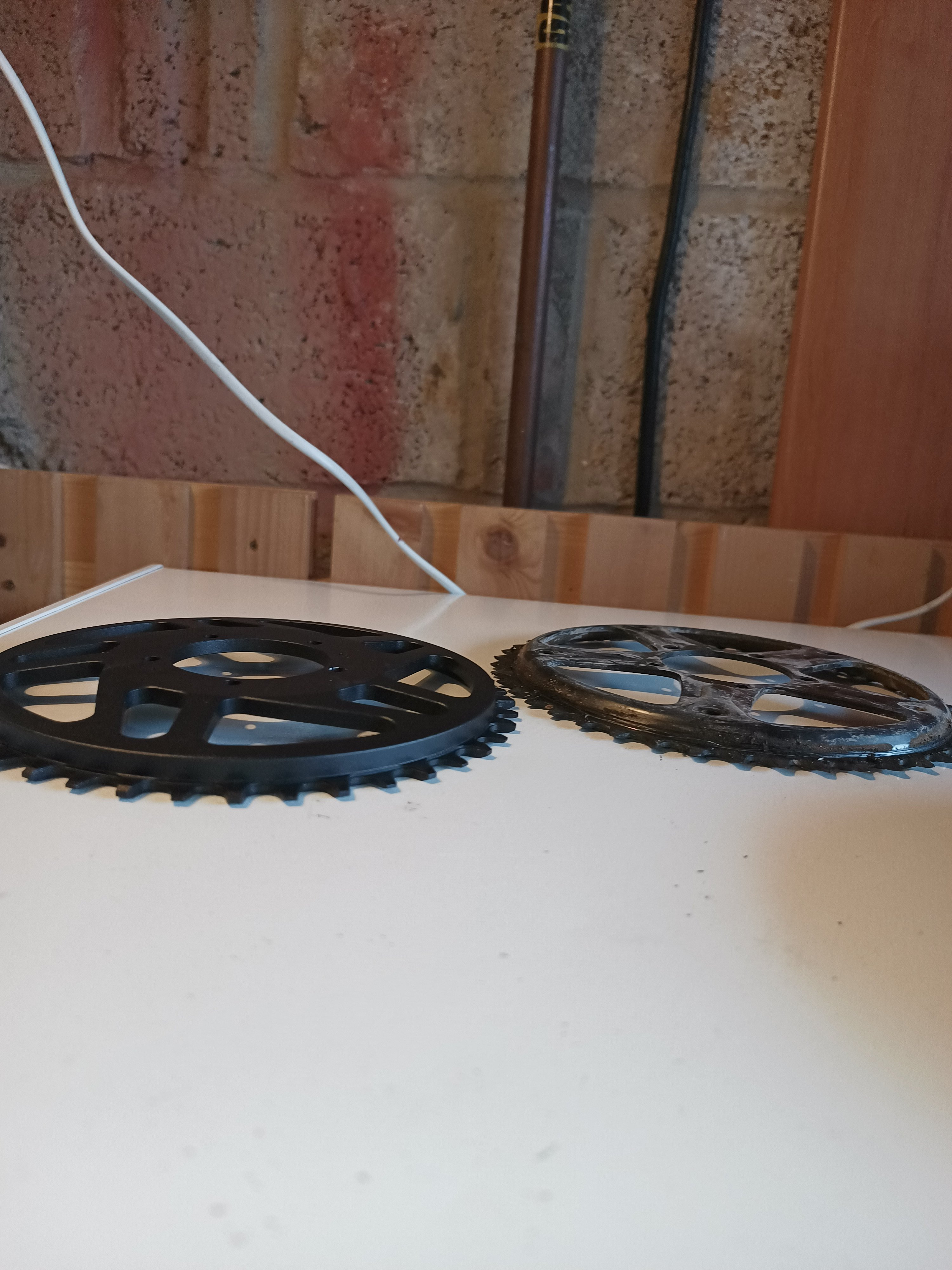

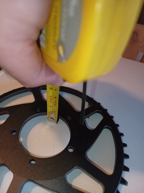

Long time, forgot to update this thread with info about this chainwheel....received in just under 2 weeks from China. Easy to fit, works well, well made. Note : the price has crept up to about £39 delivered now but you may have a discount coupon and cashback (topcashback etc) to bring the price down...One thing to note it does fit very close to the the plastic main drive cover (see pics)
I estimate it brings in the chainline about 3-4mm (improved offset) closer inwards compared to the stock 44t Bafang chainwheel
It weighs in at 178g compared to the stock steel 44t bafang chainring at 273 (not including plastic chain guard)
anyway, here's some pics
IMG_20211008_110639867.thumb.jpg.76a8ad18eaf1e6e90e03ada455fbd2ce.jpgIMG_20211008_110742319.thumb.jpg.bdffd4df164f466ba1b4b1f1d2d9b05c.jpg
