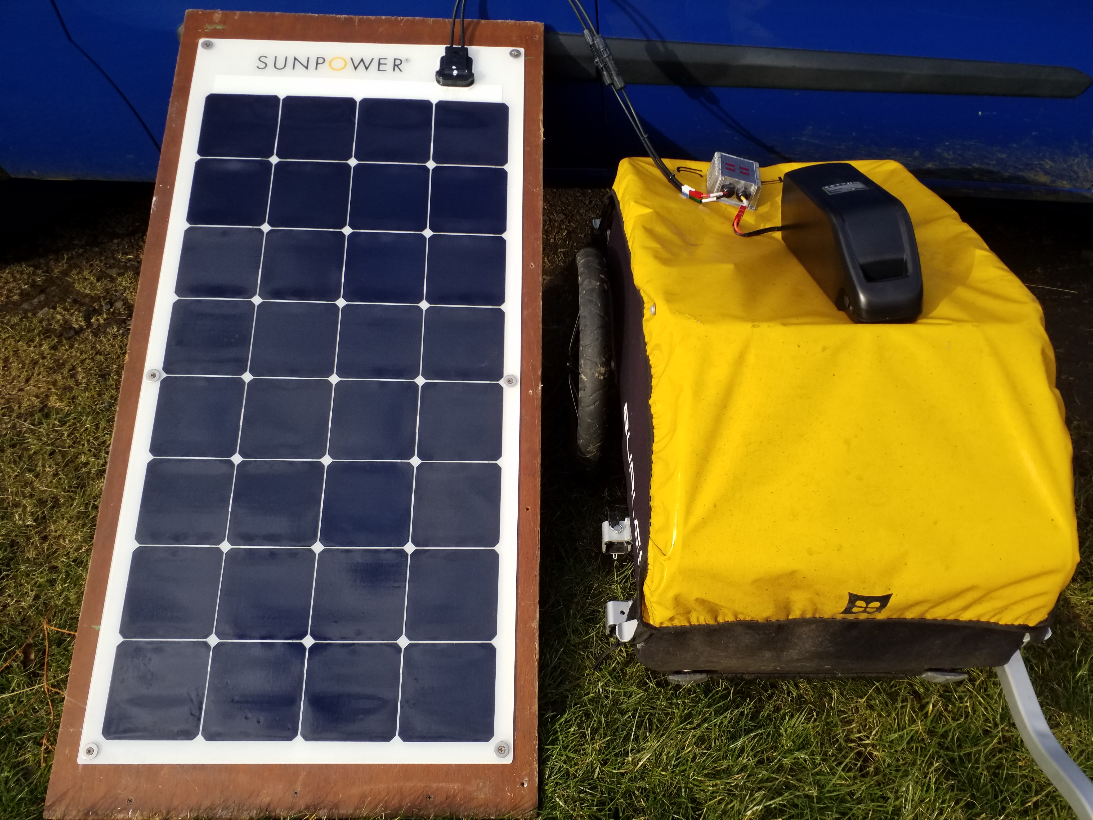

April 1, 20224 yr Author Straightforward if you have a generic type of battery, I.e. not Shimano, Bosch, Yamaha etc.. I have built a solar trailer, which uses lightweight, expensive, high performance panels, but if you mean not taking the panel(s) with you, all you need is a 'normal' glass covered panel, a charge controller, a fuse and a connector to suit your battery. Probably at least a 100W solar panel, but if you indicate the capacity of your battery (Ah) and what timescale you want to charge in, that can be refined. Simplest charge controller is the Elejoy mu400sp. About $25 on aliexpress, or a bit more from ebikes.ca if you don't want to wait for far east delivery times. Thanks. Its a 48v 20ah battery. The battery does seem to have a specific connection that the AC charge connects to. This is why im wondering if they can be charged from the leads that go from the battery. On a normal battery that would be fine, but I don't know what's inside a LION battery, if there is a diode or something so that a charge only goes one way. Ideally, id like the battery to charge in one day. Ive got a 150w panel on my camper van that I am going to take off and use.

April 1, 20224 yr Author 150W is fine, you just need a charge controller. Here is the basic setup, slightly naughty with no external fuse, and here charging via the output port of the battery: [ATTACH type=full" alt="20220227_150612.jpg]46329[/ATTACH] That is 48V 20Ah, Elejoy mu400sp and a 110Wp panel. As simple as that. The charge controller is vital, as it will limit voltage to prevent overcharging. The Elejoy can be set to any required voltage i.e. 54.6V for 13S 48V. Thanks. Does your battery have a separate charging port where you plug it into the mains? Or are the wires coming out of your battery connected to the charging port in some way?

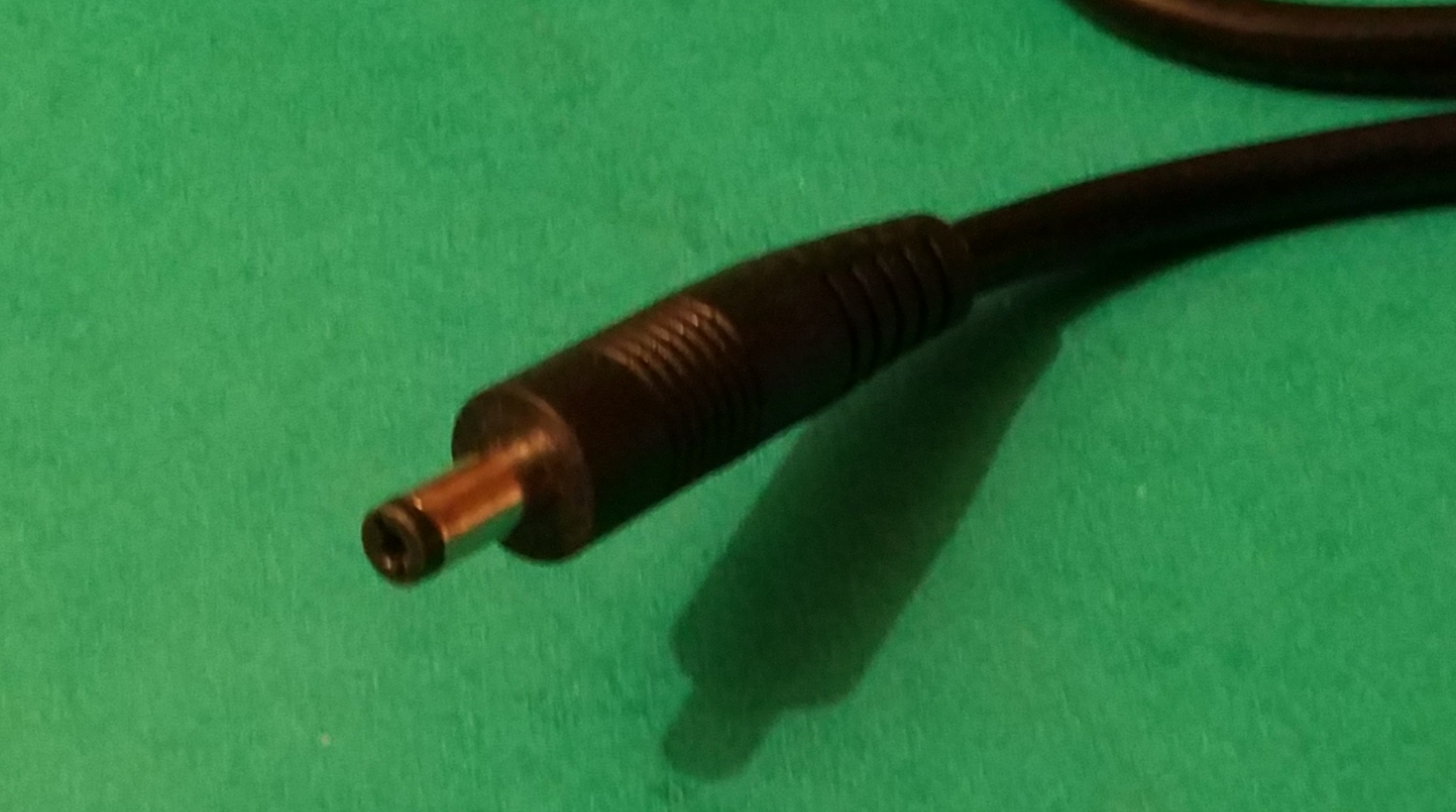

April 1, 20224 yr Also, how long does your battery take to charge? Yes, there is a separate charging port which takes this cable which is the 54.6V DC output of the mains charger. I tried charging through that connection, which sometimes worked and sometimes did not. I think the BMS does not always accept the charge controller output as a valid charge source, which I think is because I set the charge controller voltage to a bit less than full charge. I don't have time to fully investigate so I am charging via the output port because (a) it works and (b) I have verified that the charge controller properly limits itself to the voltage it is set to, so will not overcharge. The BMS cannot stop the charge, but it does not need to because the charge controller does. The BMS is still looking after balancing. 150W panel will fully charge your battery on a sunny day, between about April and September. Not on a dull day, and not in one short winter day. Assuming it is facing roughly south and inclined at about 30 degrees.
April 1, 20224 yr Author Yes, there is a separate charging port which takes this cable [ATTACH type=full" alt="20220401_201923.jpg]46330[/ATTACH] which is the 54.6V DC output of the mains charger. I tried charging through that connection, which sometimes worked and sometimes did not. I think the BMS does not always accept the charge controller output as a valid charge source, which I think is because I set the charge controller voltage to a bit less than full charge. I don't have time to fully investigate so I am charging via the output port because (a) it works and (b) I have verified that the charge controller properly limits itself to the voltage it is set to, so will not overcharge. The BMS cannot stop the charge, but it does not need to because the charge controller does. The BMS is still looking after balancing. 150W panel will fully charge your battery on a sunny day, between about April and September. Not on a dull day, and not in one short winter day. Assuming it is facing roughly south and inclined at about 30 degrees. Thats really helpful. Appreciated, thanks.
April 1, 20224 yr Author Yes, there is a separate charging port which takes this cable [ATTACH type=full" alt="20220401_201923.jpg]46330[/ATTACH] which is the 54.6V DC output of the mains charger. I tried charging through that connection, which sometimes worked and sometimes did not. I think the BMS does not always accept the charge controller output as a valid charge source, which I think is because I set the charge controller voltage to a bit less than full charge. I don't have time to fully investigate so I am charging via the output port because (a) it works and (b) I have verified that the charge controller properly limits itself to the voltage it is set to, so will not overcharge. The BMS cannot stop the charge, but it does not need to because the charge controller does. The BMS is still looking after balancing. 150W panel will fully charge your battery on a sunny day, between about April and September. Not on a dull day, and not in one short winter day. Assuming it is facing roughly south and inclined at about 30 degrees. I will be charging from home so I am wondering about the solar panel charging a leisure battery (12v 110ah) and then charging the bike from that. I can then use the bike during the day and charge it over night. Hopefully.
