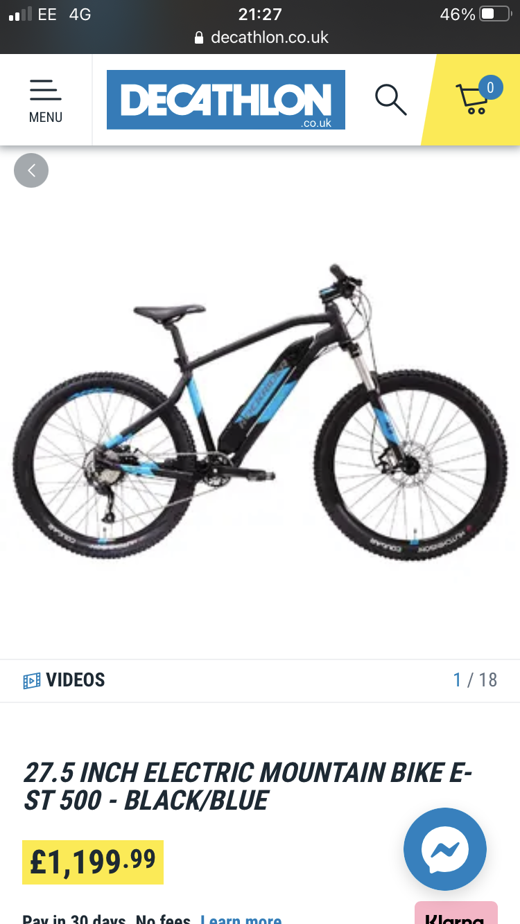

Decathlon sell some pretty decent e-mountain bikes for around the £1,000 mark and it might be worth a look. Plus you'll have somewhere to take it back to if there's any issues with it.
Both the bikes below are around the £1,000 mark and the specification on both is very good for the money.
