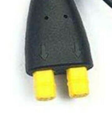

My guess at best is the speed sensor two way connector if used and water ingress via this point causing possibly a short. The fact walk assist isn't working imv points to motor controller failure.

As already said I'd be looking at water ingress in the double yellow speed sensor which may have caused a problem with the controller - after all, it is through that connector that you program the motor.
