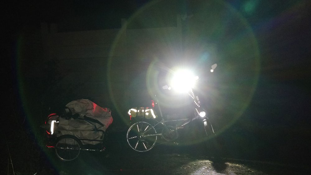

October 26, 20223 yr Author Can I suggests a comparison test ? Take a picture at a distance, in twilight, of the lights you have been trying, lined up in a row, at the same height that they would be if on a bike and next to a car with its rear lights on. And for a real comparison for us oldies, have one of the cycle lights an old grey plastic rear light, the type that were powered by two U2 batteries. I didn't want to lug around the DSLR this morning - so for your delectation, here are the lights I have at the moment, snapped using my phone camera... which will serve as "Before" pics. These lights are clearly not bright enough! MORE! I NEED MORE LIGHTS! Dark path, combined beams Close-ish to car headlights - the new headlight in the fork lights up the foreground better than the useless (for illuminating the road)Junstar 6V 5W did, and it doesn't dazzle drivers - stVZO approved beam (I'd much rather it dazzled drivers). The top headlight does dazzle, but I usually direct it down towards the road - imagine that in red and flashing rapidly as a rear light. Two of those on the handlebar could be OTT, but I think we cyclists need OTT. The other bright parts are reflective. I should also cover the mudgaurds with reflective material. One more 1800LM headlight should do for the front, pointed slightly to the left to blind drivers at intersections. Edited October 26, 20223 yr by guerney

October 27, 20223 yr Author I was stalked by a red hatchback tonight at about 12.14am while towing home my final trailer full of home grown pumpkins. First, it screeched to a halt appraching on the other side of the road, then it turned and followed me slowly, then sped by shouting, turned around and passed again on the other side shouting and looking, then stopped again down the road, and started to turn again... I thought I was about to get bikejacked so I started the mad flashing mode for their next approach, which seemed to scare them off - they took a right turn and didn't return. Glad that was the last haul. Three 1800LM (5400LM) flashing lights will be more alarming to look at. I really must get 3M Scotchlite for those mudguards, and fit the wheel reflectors which came with the Homcom trailer. Not yet bright enough... Deliveries are too slow. The foreground is mostly illuminated by the new light on the fork. Edited October 27, 20223 yr by guerney

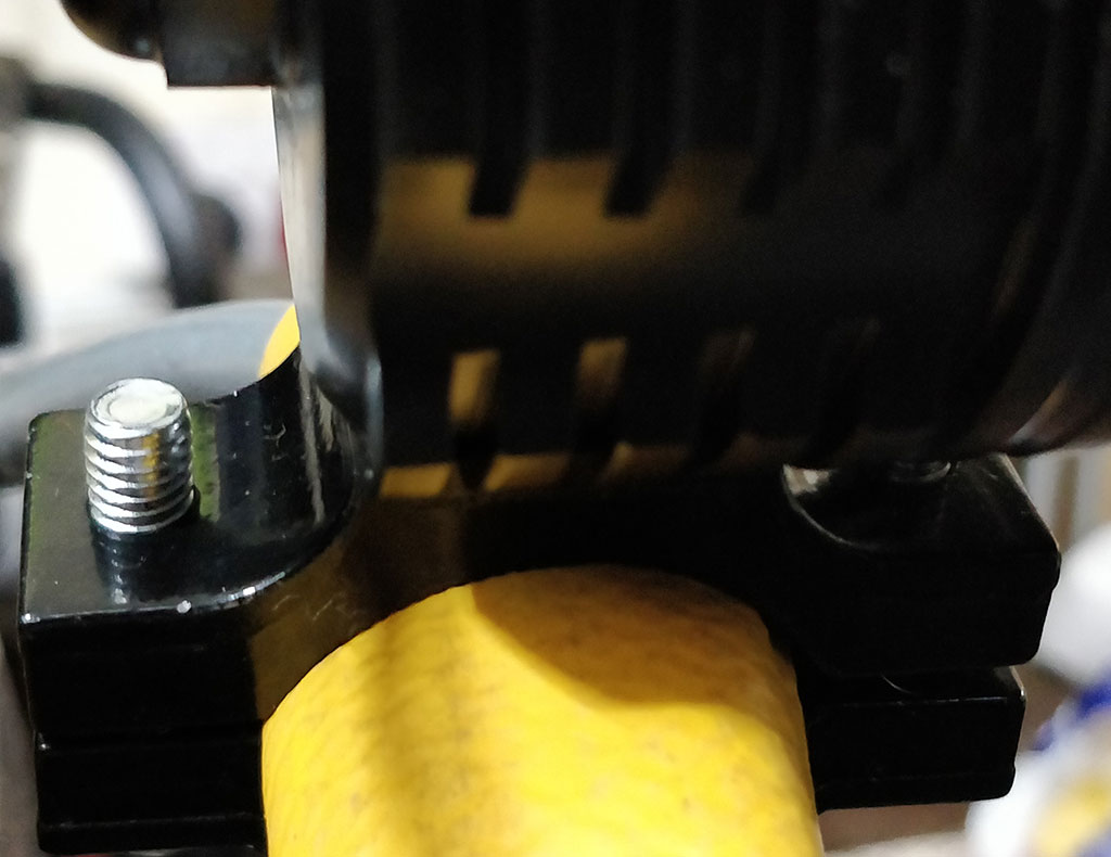

October 30, 20223 yr Author All three 1800LM headlights are installed on my bike. The rear 1800LM is fearsomely bright, even with two layers of heat-resistant red acetate behind the glass. And of course, I now have twice the brightness on the handlebars: 3200LM. Still waiting for the dual switch - wires are in the right place for when it arrives next week, and for whenever I next have time to splice that second (dual) switch in... The second switch will enable different mode per light. For now all three are either bright, dimmer or flashing scarily, with modes changed via a single handlebar switch. I'll take some photos when I'm next out in the dark... Both of the front lights flash in sync. When the other switches arrive, that'll be optional - out of sync flashing may make for easier viewing while riding. Rapid variance of brightness might make video capture of number plates at night clearer, as numberplates weree overblown at the lowest exposure settings of my action camera, when using one bright steady light. Here's a brightness comparison of the now red 1800LM with my Bafang 6v 5w rear light, which switches on automatically when the DPC-18 display detects low light conditions. It's on, but doesn't look it, and this photo has an exposure time of 1/54,191th second. ISO is 320. The red light is confusing the Luxmeter app on my phone, the only reading I can get is 32,767 max lux, regardless how far away I hold the phone camera. Too fast for human eyes, LED lights do flash very rapidly. Probably a measure of the peaks of bursts. Might explain why the flashing mode is so disconcerting to view. A bright sunny day measures a steady 8,000 - 10,000 Lux. I've bulked up the end of the rear rack, using some old hi-viz cut hosepipe, so that the light can be angled down for a smaller folded size, and for those rare occasions when I'm feeling generous towards drivers. The clamps are pretty sturdy, but if anyone does buy these lights, bear in mind that the threads are not clean - pooled paint inside the holes, I think. I found it best to clear the way by first driving the hex bolts through the opposite side of the holes, otherwise you risk fouling the threads. But if you do ruin a clamp thread fear not, because there is room for slightly filed down locknuts on top (bolt to the right), to hold the clamp firm. I've pointed a 5W 6V light backwards, to illuminate my hi-viz blouson at night - that lit one is connected to the output for low power lights on the controller, for now. And that's my 120db Hornitt in the middle. Cheap - and it'll be circa £77 well spent, if these lights prevent my being squashed by a driver. 3X 1800LM headlights 45 5m 11A 0.5mm 2 core automotive wire 5 Red heat resistant acetate sheet 2 2 X waterproof handlebar switches: 1 single, 1 dual 25 77 Plus a bit of solder and blade fuse I already had. If you don't have a suitable ebike battery, a separate small bottle battery could be used. There's a 0.2V drop in voltage when all three lights are on full constant, 0.1v when all are dimmed, and switching between both voltage reductions when three are flashing. Hope these keep the fuckers away... Edited October 30, 20223 yr by guerney

November 1, 20223 yr Author The new dual switch arrived yesterday, but now I'm waiting for waterproof 4:1 self-adhesive marine heat shrink sleeving to be delivered, so I can complete the wiring to enable different modes for each light. Marine heat shrink can be shaped while hot, to set soldered cables into neater curves under the handlebars. The rear 1800LM light is much more effective than my two flashers + Oxford lollipop + one steady GPS tracker light. Drivers this morning gave me extremely wide berths while passing. It's a very bright rear light, here are some phone camera snaps. This red rear 1800LM light stands out even more when flashing (I might add more red acetate sheet layers to it) No lithiumed available I'm pleased with how well the two 1800LM headlights on the handlebars, with the 70 lux light on the fork, illuminate my way: I usually have the two 1800LM headlights angled down lower. This photo was snapped from slightly downhill: Undipped: Edited November 1, 20223 yr by guerney
